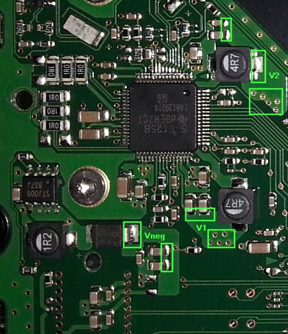

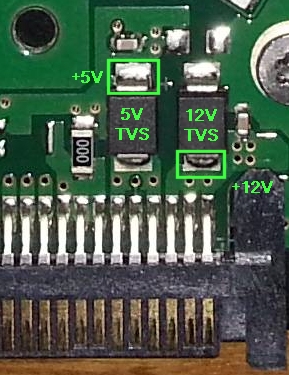

Can you measure the following voltages? You could use your donor for comparison.

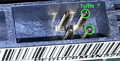

Terminal adaptor:
What pins should I use for RX and TX? I checked out the link you provided but it is not clear to me what pins should be used since the provided example is a disk with more pins than mine.
The HD103UJ has the following pins available:
https://i.imgur.com/TufhUen.jpg
Also, where should I get power and ground from? Should I just find a ground pin on the drive and solder a wire there, and same for power? 3.3 or 5 V? I intend to use a generic USB to TTL serial debug cable, such as this one (which I already have): https://www.adafruit.com/product/954
Voltages:
I will try to measure the voltages.
 Post subject: Re: HD103UJ PCB swap
PostPosted: April 1st, 2017, 19:14
Joined: April 1st, 2017, 15:50
Posts: 5
Location: Norway
Edit: This is my third post in total, I made another post (my second post in total) to this thread before this one where I said thanks and posted some other information, but it said it would get posted after it was verified (since I'm a new user). I don't know why this third message got posted before it, if the second one doesn't show up soon I'll repost it. Sorry about that.
Voltages:
5V TVS: OK
12V TVS: OK
Everything else is open circuit except:
Vneg: 5 mV (starts at 4,5 mV then climbs up to 5 mV).
The two horizontally mounted SMD capacitors at the bottom of the last picture: 5 mV (also start at 4,5).

All three voltages (V1, V2, Vneg) are generated by the SH6125B motor controller IC. Either the +5V or +12V supplies are not reaching this chip (you can measure the adjacent capacitors), or the chip is dead. In any case you will get no terminal output in this state.

Also, if the TVS chips are good, I'd suspect the motor controller, which is not an uncommon failure.

However, I'm still curious how I'm supposed to connect the serial console cable.
My patient (and donor) HD103UJ has the following pins available:
What should I use for TX and RX?
Is it safe to let the USB to TTL serial debug cable get power and ground from a completely different source? Such as a separate DC power supply? Should I use 3.3 volts or 5?

I don't know which pins, if any, are Tx/Rx, but these would be my guess:
Any pin that has a pullup or pulldown resistor, or both, would probably be an input.
To determine the interface voltage levels, I would measure each of the round pads.
