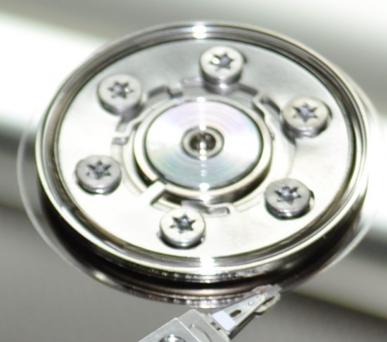

i have got a a tonka 15 to recover ( 7200.9 ) the customer say it never fall down but i am not sure this is the true.
the terminal log show this. i tryed an hot swap pcb but it start to click repatly again.
Interface task reset
4096k x 32 SDRAM
TONKA15 - 1_Disk S.59 12-09-05 11:07
Buzz - Head Mask FFFF - Head Mask FFFF - Head Mask FFFF ( continue with same: - Head Mask FFFF )

Terminal log says head problems. Need head swap.
Head Mask FFFF = bad heads

In my experience this is dead heads. This HDD is one of the Seagates where it is common to see platter coating flaking. Meaning life expectancy of new heads will vary.

thank you for confirmation of bad heads.
good time to try out the new hddsurgery tools and perform the swap :)

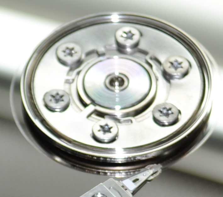

uhm i opened the lid, and i found a bad bad scratch on the visible platter, near the head resting area, damn!
 Post subject: Re: tonka clicking
PostPosted: August 24th, 2011, 18:27
I've seen worse, and recovered something from them! :-)
