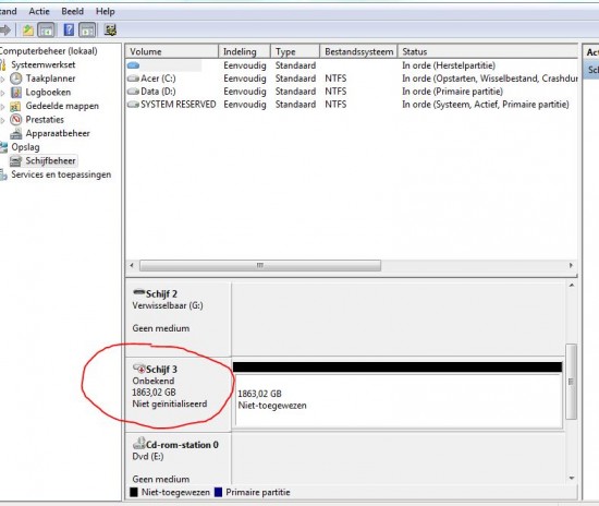

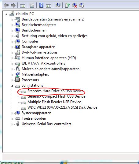

I have an external HD that I can not open
device Management and disk Management can see the HDD
Cannot read from Sector 0 of Freecom Hard Drive XS. Gegevensfout (cyclische redundantiecontrole)
How to fix this problem

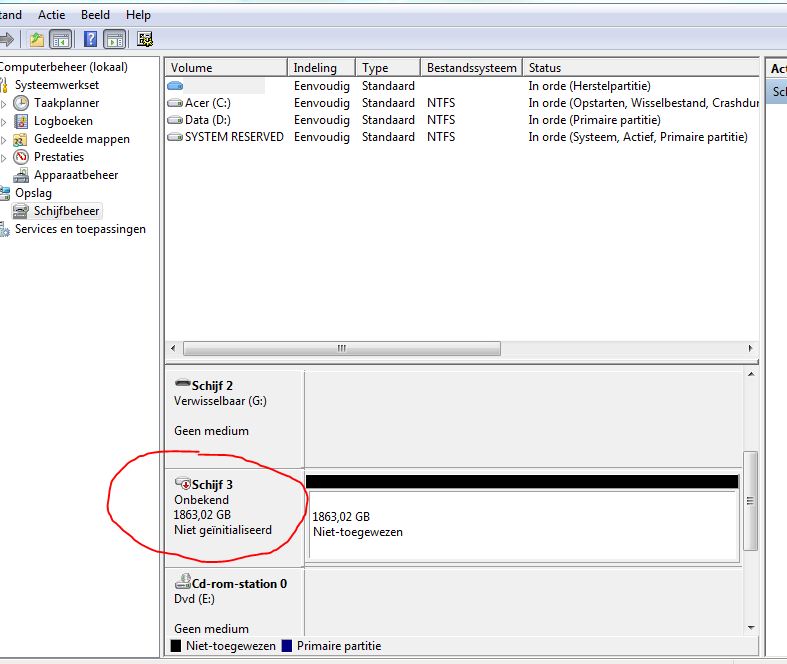

I now there is a password on it
And no strange noises the HDD is 3 days old

Have you got any data on the drive?
Are you trying to recovery data or farmat it?
Looking at your pics & using google translator the drive is unassigned.
That seems to be Dutch for: Data error (CRC) - if so, you have a hardware problem. This might be a USB CRC error, but IMHO it is much more likely to be the way that Windows is reporting an unreadable sector(s) on the disk. Look in the Windows event log for the correct date/time to see if this was reported as a USB interface error or a disk error.
You say the disk is only 3 days old - so either it was already faulty, or some event has damaged it within those 3 days. Has anything unusual happened during those 3 days?
If you are deciding to take the risk of a "DIY" recovery attempt, because the data is not valuable enough to pay for recovery - so that means you accept the risks of DIY - then I would start by cloning (or attempting to clone) the disk, using software which can have controlled retries and other recovery strategies for sectors which report errors. Then do a logical recovery from the result of the clone.
Personally, I use ddrescue on Linux / Unix for this type of cloning work - other people recommended DMDE and HDclone, though I haven't used them. You need to choose a tool that you feel comfortable using, since you are doing the "DIY". You may find (as some people do) that ddrescue is too complicated.
Whichever software you decide to use, it is a good idea to practice using your choice of tool on other (spare/unimportant) disk(s) before you try it on the "problem" disk, to reduce the chances of you causing "human error" and losing data on your "problem disk". Remember that you must choose the correct direction of clone (source/target) and, as with any DIY, there are risks that you will make things worse.
Of course you need space to hold the result of the clone. Your choices include a blank disk of the same or greater size; a filesystem with enough free space to hold the whole capacity of the disk; or you could use compression during the cloning process to reduce the space needed to hold the clone (on either a raw disk or a filesystem), but that makes using logical software on the clone result more complicated, or it can limit you to a reduced range of logical recovery software. For this reason, I never use compression on the target of a clone, but it's your choice.
