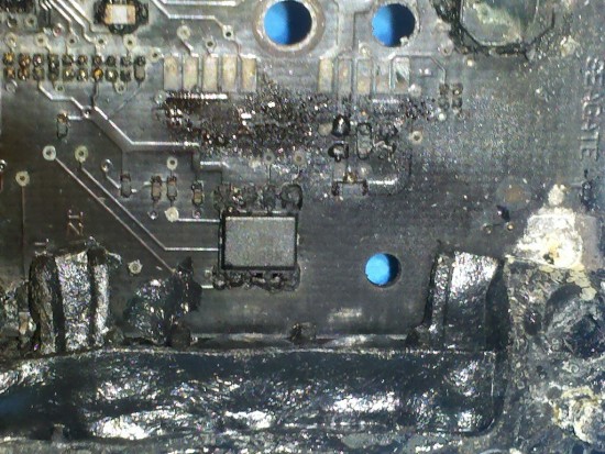

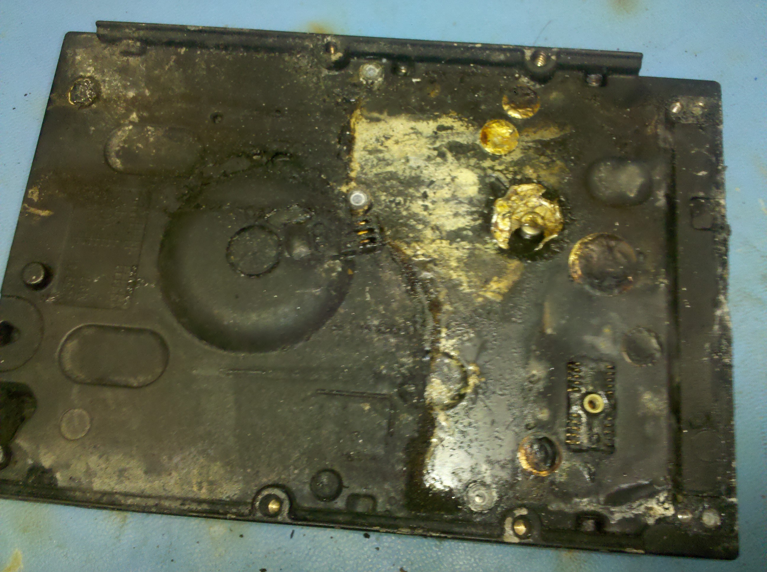

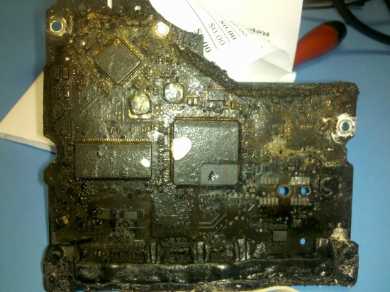

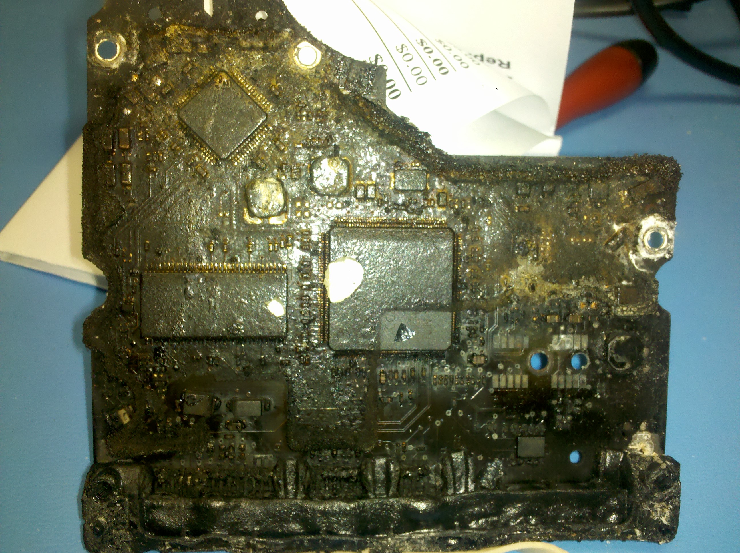

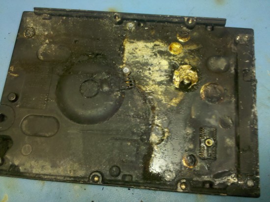

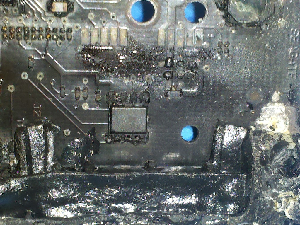

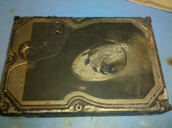

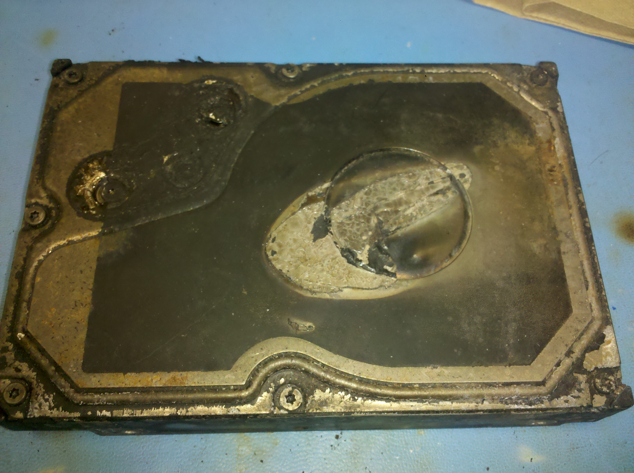

Just got this drive in from a client, the drive was in a fire then sat in water for a bit. Can't even view the PCB number on the board, and the label is burned off the drive. The only markings we can find are on the ROM:
25FU406B
08
0GG5N
Any thoughts at all on how to locate the model or any specifics to do repairs? The coating on the PCB is actually chipping off, so cleaning away char to see the details is not possible. And any markings on the other components has been burned off or comes off with char that comes off from even touching them with your fingers.
I have seen a few fire damage drives in the past, and for the most part the seals do a decent job keeping the internals clean (from soot at least, water is a different story) - but I've never seen one this bad.
Welcome all thoughts about potential recovery avenues for us, including anyone wishing to attempt and rates for your attempts.

 Post subject: Re: Extremely Damaged Drive From Fire - Thoughts?
PostPosted: September 2nd, 2011, 12:34
Posts: 511
Location: Austin, TX
what does the inside look like?
Post pics
PostPosted: September 2nd, 2011, 13:08
Posts: 3598
Location: Chicago
Open the drive and check VCM magnets, if they not magnets anymore - it's unrecoverable
You can't judge by external conditions
The drive will require cleaning and platter transplant. If you haven't done firedamages before - I suggest you not to work on this but give it to somebody who has experience
PostPosted: September 2nd, 2011, 13:26
Posts: 511
it looks like a Seagate 7200.11 or .12. So it is most likely over 500gb

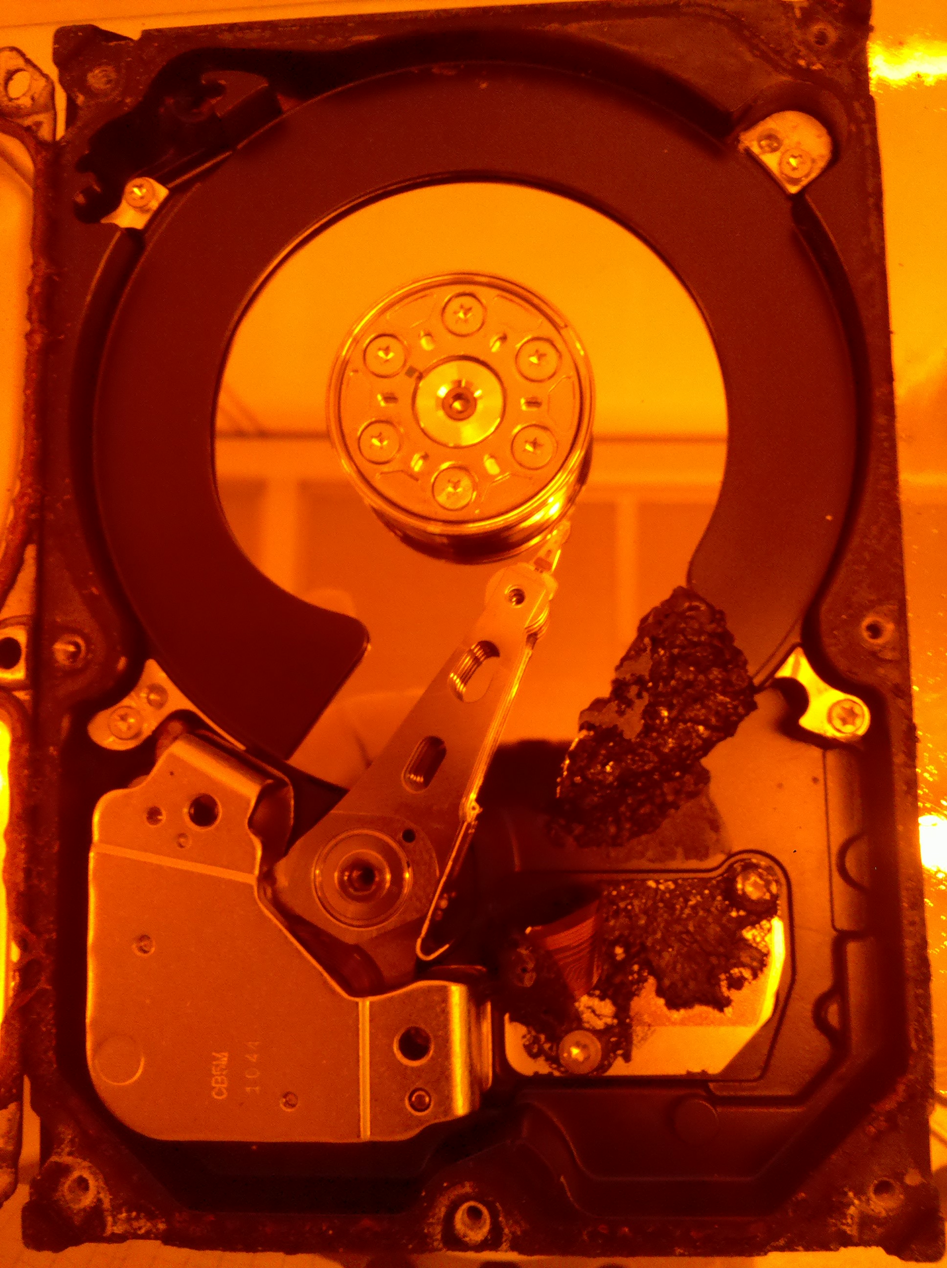

PostPosted: September 2nd, 2011, 15:45
Joined: July 16th, 2010, 11:36
Posts: 128

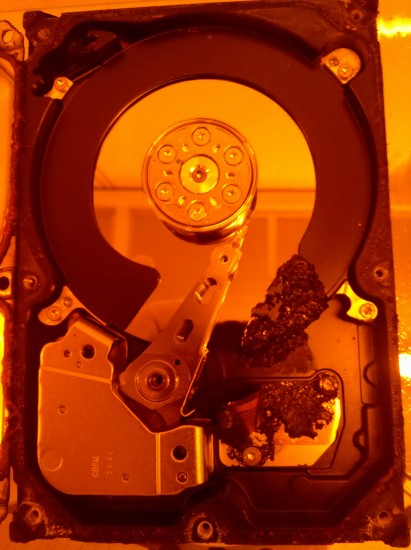

I've done a few, but nothing this bad. Pictures attached. It looks like parts of the chassis actually melted onto the platters, as the black material covering the platter near the open ridge is pretty solid and feels like metal. Also to note, where the material touches the platters, it is pretty well attached, looks to be melted together as there is no breaks between the two.
Any takers on a recovery? I'm throwing in the towel on this one, it's beyond what I can do. Or does anyone work for OnTrack/DriveSavers/i365 and want to give it a go?
PostPosted: September 2nd, 2011, 16:22
Posts: 3598
Location: Chicago
Looks like ST31000528AS to me. That means you have to have original flash and if flash is gone it's almost definitely unrecoverable
I don't see any platter discoloration which is good sign
Are the magnets still magnets? If so it is most likely doable but cleaning is gonna be hard part
However it is expensive work

Yep, they are still charged. Price range? 5K? 10K?

Nobody gonna give you the exact price on a forum :)
You need to submit a case to a DR company
But I think you guessed on the range correctly
