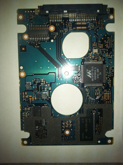

I have a dead hdd FUJITSU MHY2160BH, CA06889-B377000T. The platters won't spin and I'm pretty sure the PCB is fried so I need some guidance to swap the PCB.

My question is, does the PCB needs to have the same exact specs? I found this one online but the numbers are kind of different. Can I still use this PCB?
FUJITSU MHY2160BH, CA06889-B036 (Mine is B37)
Board # on PCB CA26344-B32104BA (The same as the defective one I have)
Board number on label: VCP7X6NLFC ( Different from mine)
DATE: 10-16-2007

You would be very lucky if after PCB swap you could access data.
One need to swap ROM also, if it's external.

It is a 2.5 laptop HDD. Do I still need to swap the ROM as well?

I could only tell by checking the PCB.
Post a picture here.

This is the HDD PCB. Thank you for your help! :)

Can you remove the gray cover and picture it again.
