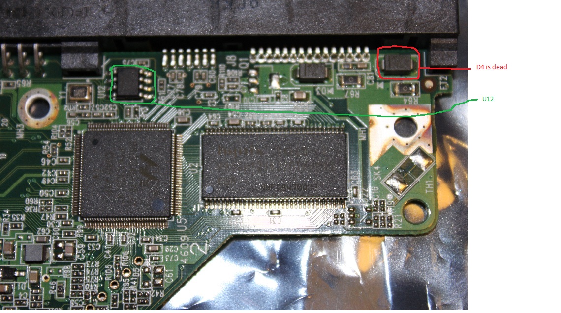

last monday I came back from a small wekend trip, I turned my pc on from stand by and found out windows it was not working as it should so i restarted and the pc won't start.
I found out the drive is not recognized in the bios.
So i started looking on the internet and found this great website with a lot of info.
I took out my HD, a WD1001FALS-00E3A0, and attached it to a sata --> usb kit to power it on.
when I turn it on i hear 6 really soft clicks (it is coming from the pcb not the drive itself, can only hear it with my ears really close), it sounds to me like the electricty won't get through.
In the past I've also experienced another problem with another drive which had another problem, the power was still working but the drive itself was clicking, so I know the difference between clicking from the drive or from the pcb itself ;-)
So I took out the pcb and checked the D3 and D4 with a multimeter.
D4 is dead.
I also found the U12 chip on the pcb (this is a good thing I understand from other posts?)
So I called WD and they send me a replacement drive because 'm still in the waranty period, the replacement drive is a WD1001FALS-00E8B, so this is a different pcb am I right?
Should I just remove the D4 diode and start the HD up?
Or is it better to swap the U12 from the dead pcb to the donor pcb (even while this is a different type of pcb), Anyone?
please see the attached image for detailed info
File comment: you can see the U12, D3 and D4

nordcore wrote:
D4 is dead.
What do you mean by "dead"?

drc wrote:
nordcore wrote:
D4 is dead.
its giving the result 0hm , o i guessed that means dead...
do you need more info?
 Post subject: Re: WD1001FALS-00E3A0 - pcb dead?
PostPosted: August 26th, 2011, 11:40
Posts: 3235
Location: USA
Just checking.
Best case would be to swap U12 onto matching PCB and use that. In a pinch you can try removing the shorted TVS and reusing this PCB, but that has the possibility of causing further internal damage.

drc wrote:
Just checking.
and with the shorted tvs you mean the "D4"?
and with "possibility" you mean that if it's getting to much power It'll die...?
As told I don't have a unique matching pcb...
The broken pcb is WD1001FALS-00E3A0 and the new pc is WD1001FALS-00E8B0 .
Should that work? can I give it a try or should I use the exact same pcb?
the poblem is I can't find one anywhere...

dmarques wrote:
A simple exchange won't work, as you're told already.
You have to move U12 (ROM chip).
I understand but can I simply use the U12 from the "WD1001FALS-00E3A0" pcb and put it on the "WD1001FALS-00E8B0" pcb?
Or won't this work beacause of the different model?

dmarques wrote:
It won't work in this case. And it could not work even if you have the same model PCB, as there is a version of the ROM information, and you need to match that version.
So best way is to move the chip.

irs wrote:
hi,
these PCBs belong to diferent families:
WD1001FALS-00E3A0 should be YUCON family
WD1001FALS-00E8B0 MARS family
Luca
Does this mean the "mars family" pcb won't read the "yucon family" U12 chip?
also earlier drc told me :
drc wrote:
Just checking.
is this true?
can I just take the D4 out and turn the device on or do I have to do more than just removing th D4, apart from the fact that I can replace it with the D4 from the new pcb.

dmarques wrote:
Mars family is not compatible with Yucon family.
so swapping the U12 chip won't work anyway?

OK, so you have a handfull of choices. OK, almost a handfull.
a) Take the risk and remove the TVS. This can result in either lucky outcome or (very) unlucky outcome. This means that it could work and your disk would give you access to user data (at least for some period of time) or it could not work and further damage to disk could be caused. Or none of these two. If you ask me, I would go ahead and remove the TVS and replace it with another from a good PCB and give it a try.
b) Move the U12 chip from patient PCB to donor and try. The chances of doing further damage are slim. But chances for bad outcome are also there. If you are experienced in using a hot-air gun, you could give it a try. If you're not, DON'T DO IT.
c) Give it to a pro. If the problem on your disk is only its PCB, then it won't cost you 500 euros. There are PRO's in this forum who can do it for you for $200-or less (that's 1/3 of the price you mentioned).
In any case, good luck !!
