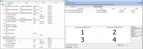

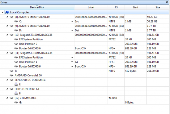

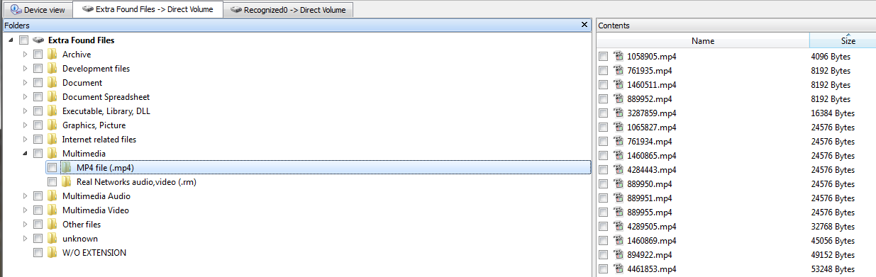

I am trying to recover files from RAID0 that was running in Mac - Leopard OS - as a storage partition. One of two disks has been accidentally "erased" in Disk Utility application. But the process was so quick I'm sure data couldn't be actually erased. At least not all data, as I can see file system sector, files signatures etc. while viewing partition in disk editor. Of course disk is not recognized as part of a Stripe anymore.
The system:
2x 1TB, HFS+ filesystem
Each disk contains 3 partitions:
  1) 200 MB - EFI FAT32 partition
  2) 931.19 GB - data HFS+ partition
  3) 128 MB - Booter HFS+ partition

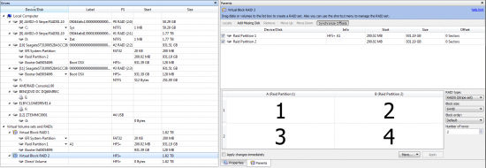

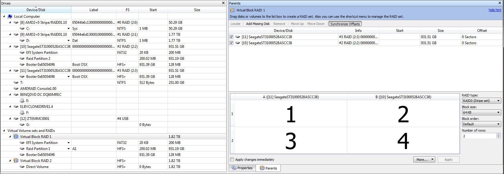

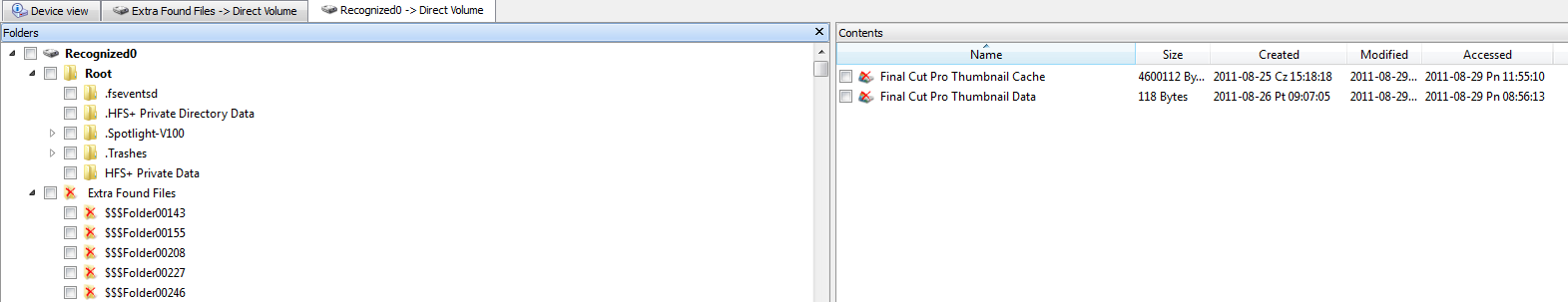

Now, I am trying to recover files by creating a virtual RAID in R-Studio, so I add both partitions and set them in correct order (I can find a sector on each disk that says RAID Partition 1 and 2 respectively). I then set parameters to what_I_think_should_be_correct and scan resulting partition (application recognizes new partition and detects correct file system). After scanning first 2-3 GB of data I preview files to find out that data is garbled. Next I change stripe size and re-scan partition, but it looks like none of them is correct, as I see pictures garbled each time. I attach two files to give you the idea.
Please advise.

And also it doesn't look like any data is mirrored, as I've checked and compared disk-to-disk some sectors and they look different. It just doesn't look data is mirrored.
Still, if you have any ideas or requests to check further I am wiling to hear them and dig deeper.

Raid reconstructor is not able to determine parameters (message: result is not significant; entropy: 0,00).
DR-Kiev,
First I didn't set any offset (offset 0 on both drives). Then I found out there is a difference where file system header and data starts on disks:
Drive #1
HFSJ header is @ Sector 2 (of partition)= Sector 409642 (of disk)
Data starts @ Sector 1470936
Drive #2
HFSJ header is @ Sector 59986 (of partition) = Sector 469626 (of disk)
Data starts @ Sector 721368
so it looks like there is an offset of 59984 sectors (hfsj header difference) ??... But when I set this offset for drive #2 it doesn't seem to help.

I don't understand the disk configuration of the original RAID. Maybe, the RAID itself has 3 partitions, not each disk?

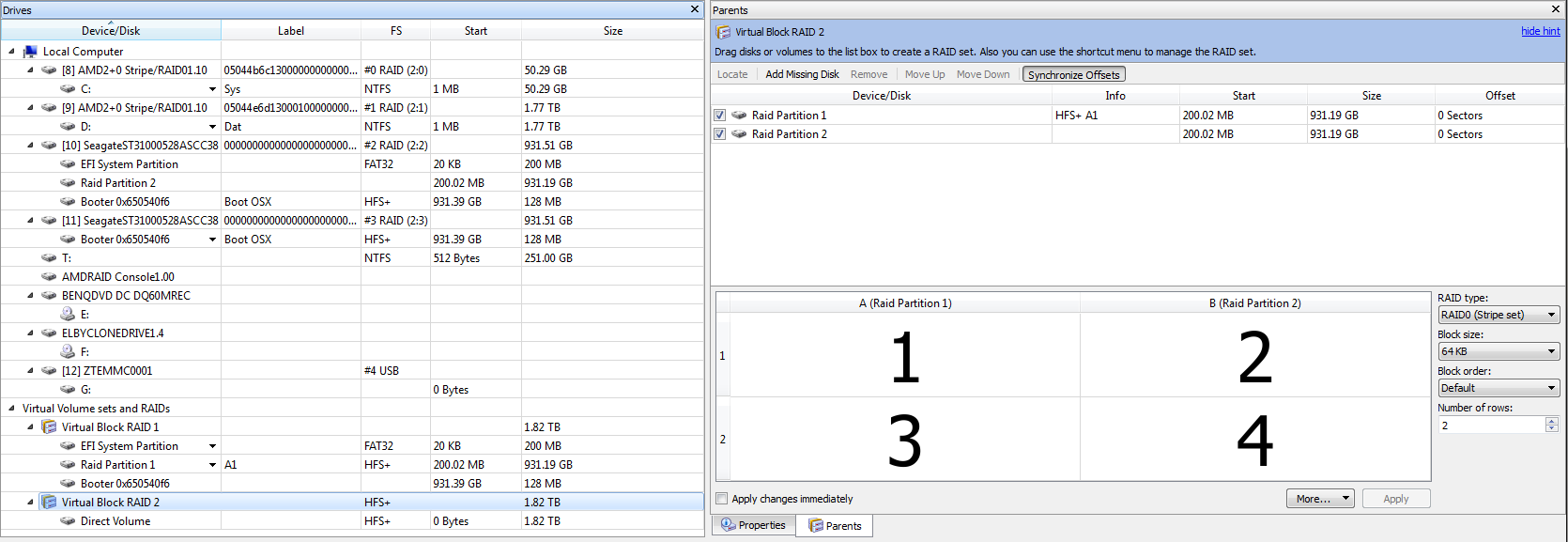

Maybe, you need to create a RAID from the HARD DISKS rather than the PARTITIONS?
A screenshot of the R-Studio Main panel with the Drives and RAID configuration panels would be helpful.

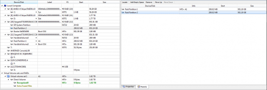

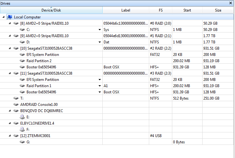

Alt,

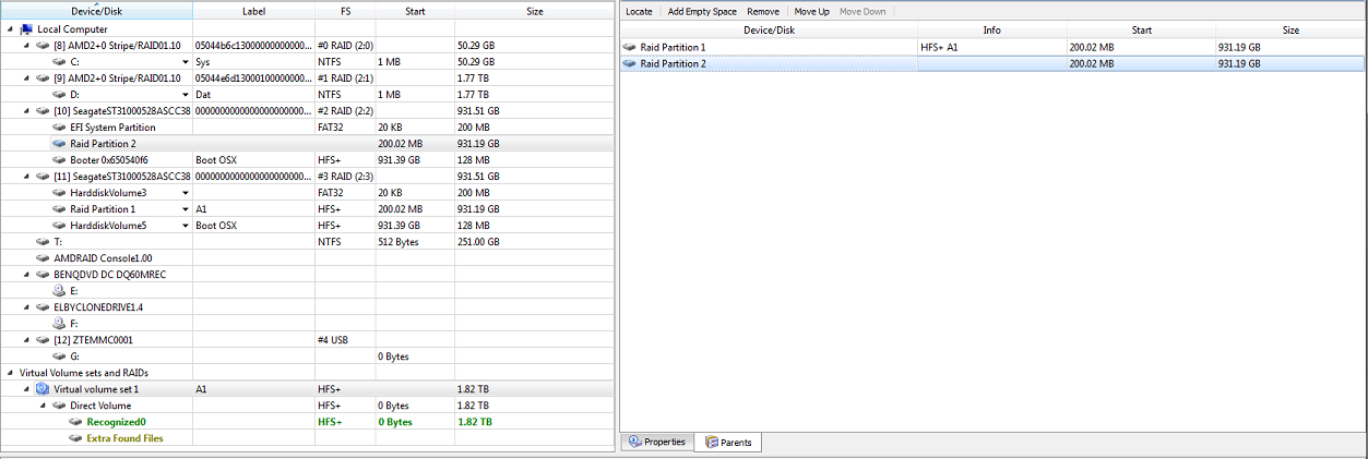

I think that Mac OS creates its own partitions layout while constructing RAID. Please look at attached screens.
files:
raid-drives - drives available to R-Studio, we care only about two: [10] SeagateST31000528ASCC38 & [11] SeagateST31000528ASCC38 (the rest are my PC drives).
raid-partitions-sets - virtual RAID created with partitions, you can notice RS detects Direct Volume with correct File System (HFS+) and also correct size of both - RAID and Volume (1.82 TB).
raid-drives-sets - virtual RAID created with hard disks, RS detects all 3 partitions and correct size for the whole RAID (1.82 TB), but detects only 931 GB for RAID partition (although in Parents tab on the right you can see I added both drives - why is RS not detecting full RAID size?).
Also, I just found something really interesting in the last 8 sectors of both RAID partitions - there is an Apple RAID Header!
Header starts in last 8 Sectors of each RAID partition - that is sector 1952853336 (disk Sector: 1953262976).

<key>AppleRAID-SetName</key><string>A1</string>
<key>AppleRAID-SequenceNumber</key><integer size="32">0x1</integer>
<key>AppleRAID-CanAddMembers</key><true/>
<key>AppleRAID-HeaderVersion</key><integer size="32">0x20000</integer>
<key>AppleRAID-ContentHint</key><string>Apple_HFS</string>
<key>AppleRAID-LevelName</key><string>Concat</string>
<key>AppleRAID-RemovalAllowed</key><string>Last</string>
<key>AppleRAID-MemberUUID</key><string ID="9">30B48E50-0BA5-434A-9607-F9895EC9D8A0</string>
<key>AppleRAID-Members</key><array><string IDREF="9"/><string>40EA93C8-215D-4096-817F-247F8955BCBB</string></array>
<key>AppleRAID-SizesCanVary</key><true/>
<key>AppleRAID-MemberType</key><string>AppleRAID-Members</string>
<key>AppleRAID-SetUUID</key><string>A3450C56-704E-49A9-9ABA-281FF57017E3</string>
<key>AppleRAID-AutoRebuild</key><false/>
<key>AppleRAID-MemberIndex</key><integer size="32">0x0</integer>
<key>AppleRAID-Spares</key><array></array>
<key>AppleRAID-SetTimeout</key><integer size="32">0x1e</integer>
<key>AppleRAID-ChunkCount</key><integer size="64">0x1d198b5</integer>
<key>AppleRAID-ChunkSize</key><integer size="64">0x8000</integer>
</dict>
Disk #2 / RAID partition
AppleRAIDHeader.A3450C56-704E-49A9-9ABA-281FF57017E3............................
40EA93C8-215D-4096-817F-247F8955BCBB...............................čĚZ..
<dict>
<key>AppleRAID-CanAddSpares</key><false/>
<key>AppleRAID-SequenceNumber</key><integer ID="3" size="32">0x1</integer>
<key>AppleRAID-MemberUUID</key><string ID="9">40EA93C8-215D-4096-817F-247F8955BCBB</string>
<key>AppleRAID-Members</key><array><string>30B48E50-0BA5-434A-9607-F9895EC9D8A0</string><string IDREF="9"/></array>
<key>AppleRAID-MemberIndex</key><integer IDREF="3"/>
</dict>
 Post subject: Re: Recovery problems with HFS+ RAID 0 - resulting data garb
PostPosted: September 7th, 2011, 20:53
Posts: 3235
Location: USA
According to the header, stripe size should be 64 sectors / 32k
Using the partitions instead of the drives is correct, this is a software RAID

I have SPAN type of array. Anyone have suggestions how to recover files from that?
PostPosted: September 8th, 2011, 3:02
Posts: 1752
So, finally it's JBOD :)
You can set up a volume for that within r-studio instead of a raid.
PostPosted: September 8th, 2011, 3:43
Joined: September 7th, 2011, 5:21
Posts: 10
Yes, it looks like you were right! :)
I'm scanning Virtual Volume Set as we speak.

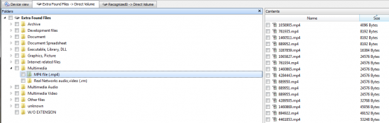

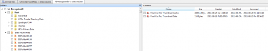

It took some time to scan the whole 1.82 TB partition...
As you can see on the screenshot below there are two objects under Virtual volume set 1 \ Direct Volume: Recognized0 and Extra Found Files. According to R-Studio documentation: Recognized0 is a logical partition with boot records and file entries found; and Extra Found Files only contains files that were found using "scan for known file types" option (which I was using).
Under Recognized0 object it shows total 19.86 TB of data found. There also is a folder called Extra Found Files marked as deleted and all its subfolders are marked as deleted as well. All files inside this folder seems to have valid file names but are unreadable and do not have valid file headers.
Under Extra Found Files object it shows total 33.35 TB of data found!! Files inside have generic (1.jpg, 2.jpg etc) names. Some of them are good, but most of them looks garbled... but at least lots of them have valid file headers.
So... the results - scan found a lot of data, it found more data than the size of span partition (which I think is pretty normal for recovery applications). I was able to find some good files but it looks like most of the files are still garbled. :(
Considering there is more total data found than the size of partition it's pretty obvious most of data will be unreadable... But how can I sort through bad files and recover good files only?
Guys, please give me some advice because I'm running out of ideas... :? Damn HFS+ !!! :evil:
PostPosted: September 8th, 2011, 12:28
Posts: 1752
I think now it's time to take that into a pro, as it's running out your options without hex analysis.
It can be that there's some extra sectors at the end for example.
All of the Extra Files Found folder will contain good file headers, because that is exactly the point of that area.
