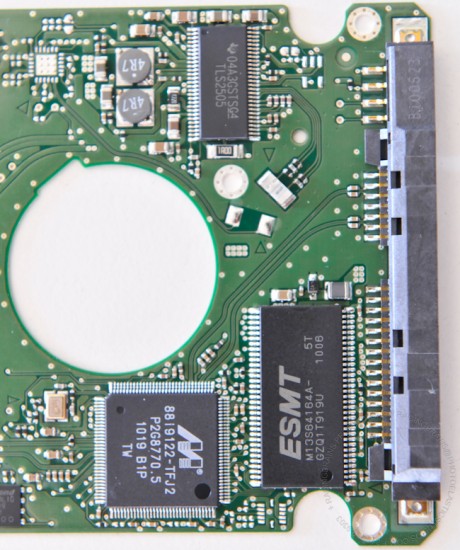

Thank you everyone for your replies. I found this photo from another thread, what is the gray component on the top right of the ESMT IC? That's the one I have tested to be shorted. Image

Location: France
http://www.google.fr/search?q=M13s64164a
it's RAM !

@ici_lemmy:
ici_lemmy wrote:
it's RAM !
You are describing the IC - but the OP is asking about the grey component near to that, not the RAM IC itself...!
@hmichakis:
Assuming that the photo you supplied is the same type of board as yours, and remembering that by supplying the photo of a different drive, we can't check for any other visible abnormalities...
hmichakis wrote:
Are all black SMD components capacitors?
(my emphasis above)
One big clue is that the component is grey (gray), not black as you were first asking...
I can't see all of the detail of the circuit in that area, but your mention of it being "in-line" with the +5V supply (I assume you mean that it is in series with that supply), and its colour, and its size, would all fit with it being an inductor and that should appear to be shorted, when its resistance is measured using a simple multimeter. With a more appropriate type of meter (e.g. an LCR meter), you would be able to confirm that it is an inductor and even measure its actual inductance value.
There are various different troubleshooting approaches you could take , but so far I suspect you have been wasting your time looking at something which is not actually a problem :(
(Edited to clarify my interpretation of the OP's comment about "in-line")

Thanks for the help Vulcan, in my own PCB that "gray" component is actually black and it appears as if there is a very slight dip, like it bulges in the middle inwards. It seems to be in-series as you say with the 5V supply pins. Is the small black component directly to the left a TVS diode?
So therefore IMHO it is not very helpful to supply a photo of a board, if you are saying that your actual board is different, and has some visible abnormalities which are not shown on the photo you supplied! :(
It is quite a small device to be a TVS - I don't have one of those drives myself to check, and the photo is not detailed enough in that area for me to see on that. What are the exact markings on the top of that component? I suspect it is a polarised capacitor, and probably not a TVS.
Instead of trying to find a TVS, as I said before there are several different troubleshooting approaches you could use, depending on skill, experience, equipment available, time etc. - not every PCB problem is because of a TVS. :)
However, I am losing interest in this thread. You have not supplied a photo of your actual board, and so all this discussion is just hypothesis, and we have already wasted time on something that was not a problem, because that is where you said there was a shorted capacitor. :( Other people may have a different view, and they may still want to help you, based on photos of a different drive. :) YMMV
If you want to continue DIY, you may find it more efficient to ask the DR folks here about how to try a replacement PCB on that model, if the data is not important on that drive (I believe it is not easy to swap, again depending on your skills including soldering, but I work in electronics and not DR). If the data is important, then perhaps you should consider using their services, instead of looking for a TVS...

I believe that the components above the SDRAM are, from right to left, an inductor, TVS diode, small capacitor, and larger capacitor.
If the diode and two capacitors measure 0 ohms, then the diode is probably shorted, in which case just remove it. However, be absolutely certain your power supply is OK.
