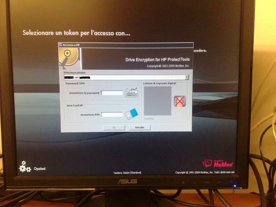

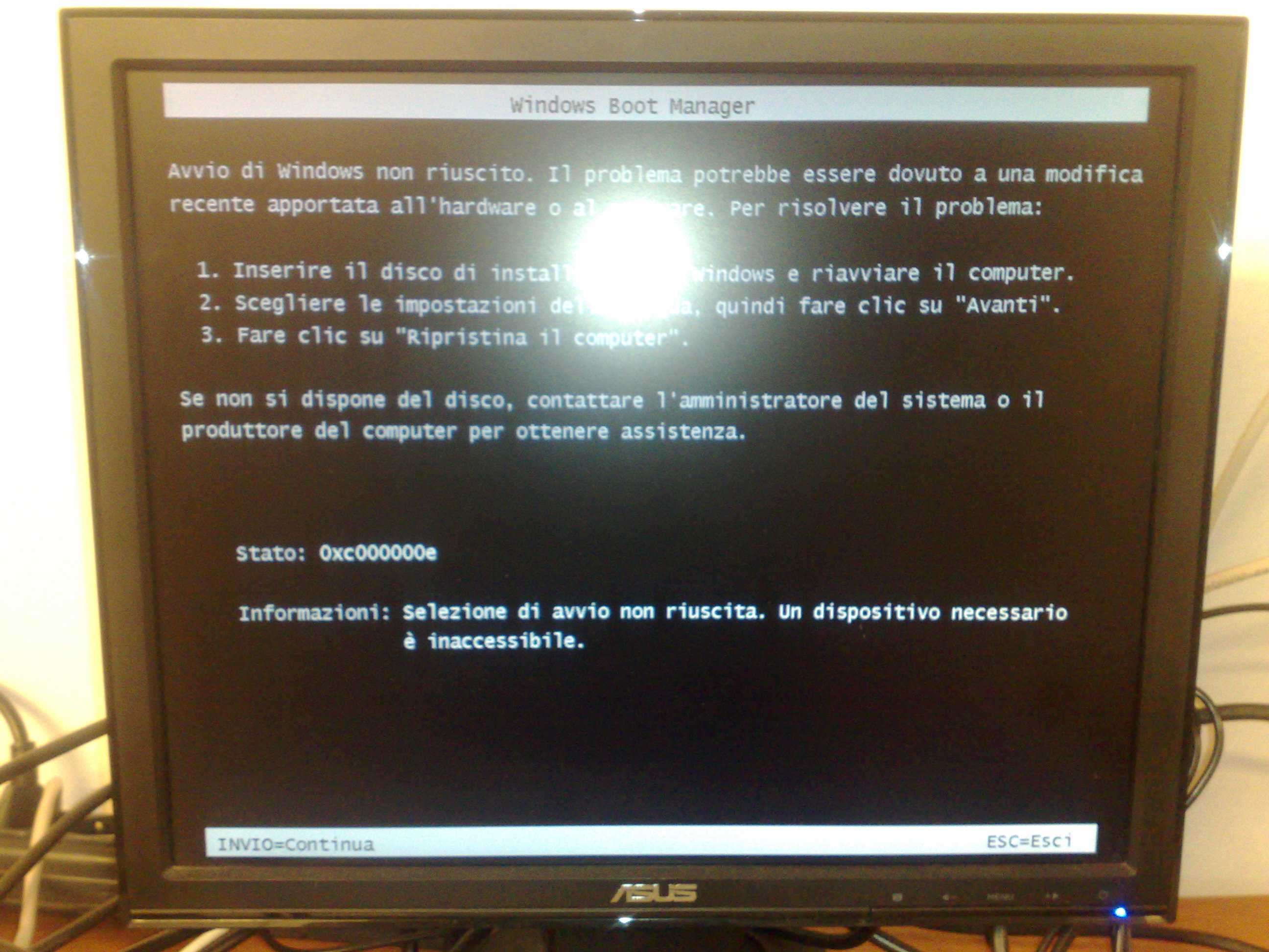

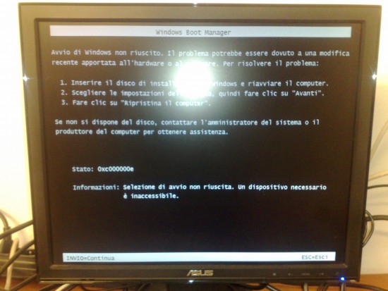

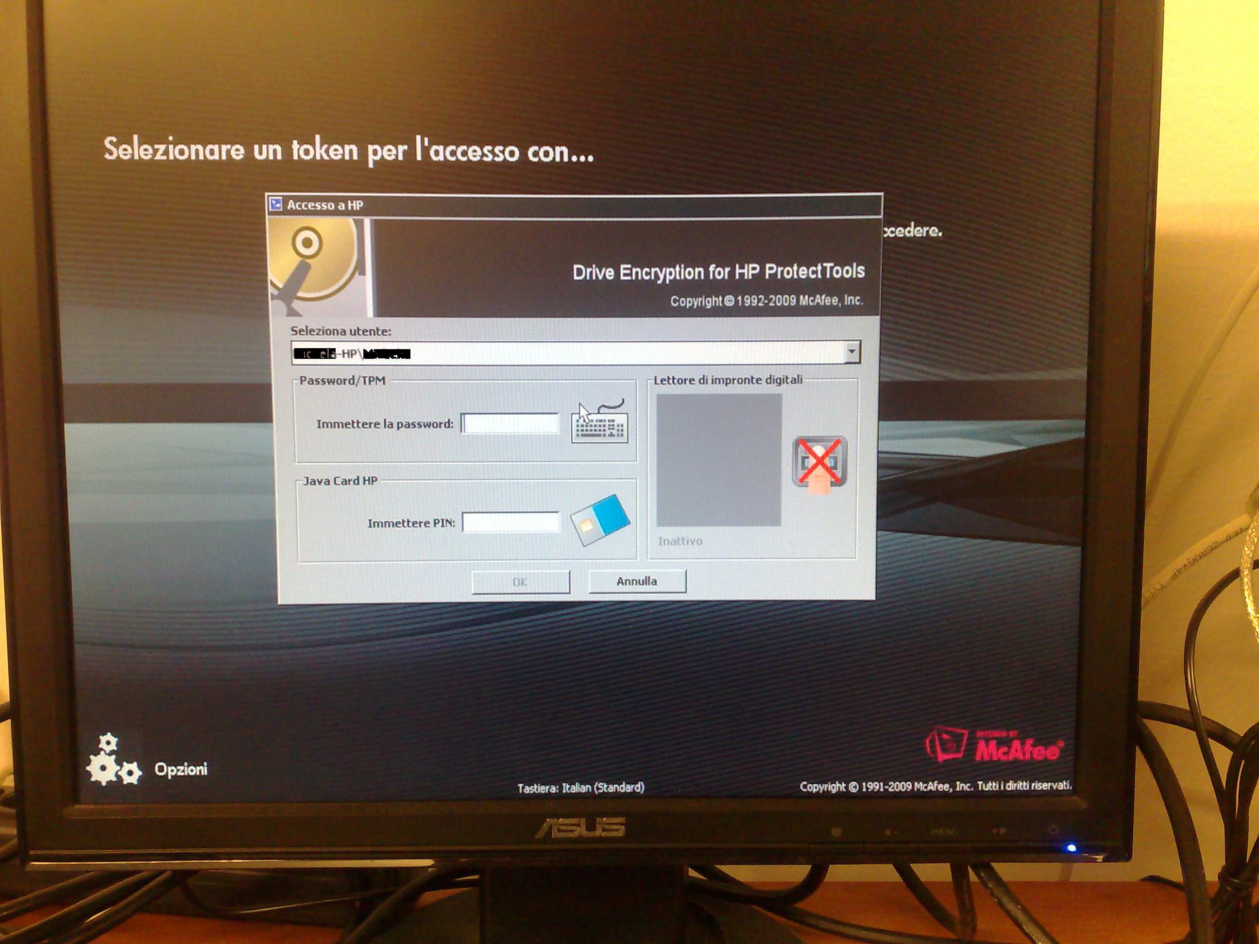

Windows is not anymore working so the data of my customer is encrypted inside.
Customer knows the password.

So tell customer to get to you the Safetech plugin and make bootable BART CD, then decrypt with relevant credentials.
You may need to get a daily code from Mcaffee, or maybe thats safeguard, I dont remember exactly.
Mcafee will help you if client gives them authorization to help you
