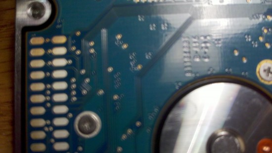

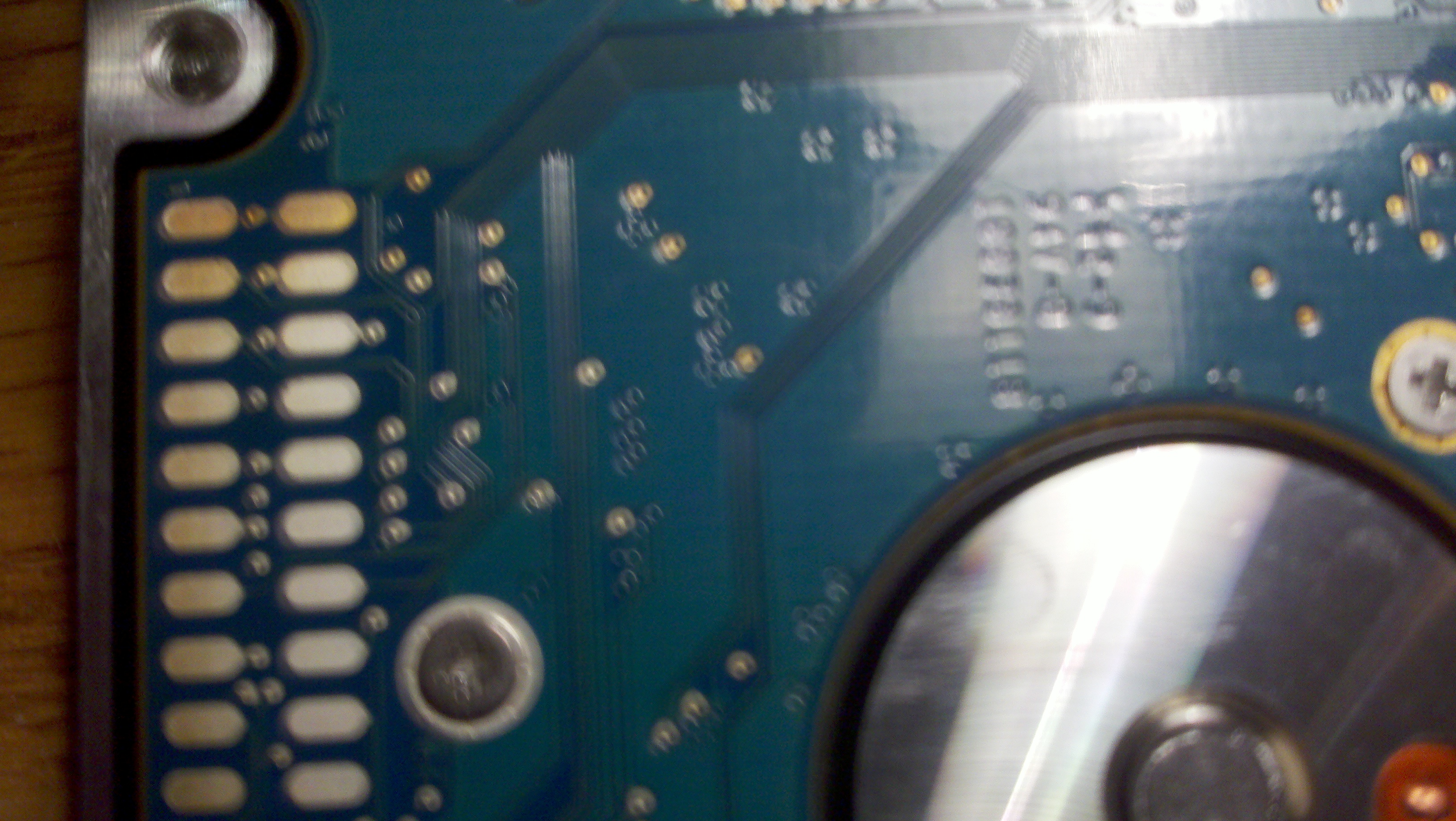

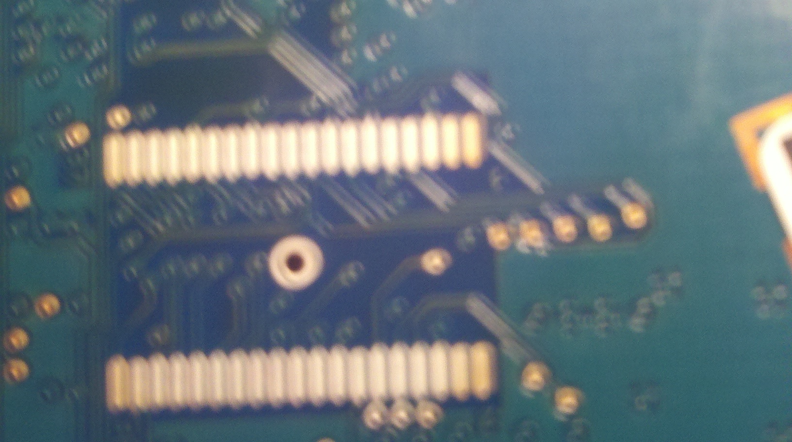

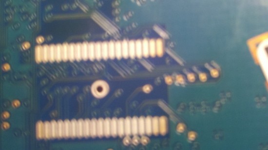

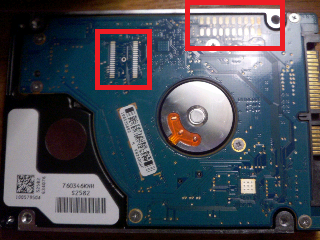

Recently my 500gb seagate momentus 5400.6 2.5" serial ATA HDD stopped working I am currently using a 320gb hard drive i had laying around but would like to get it back up and running with all my old files so im trying to find out whats wrong with the 500gb HDD. That being said so far I have found out nearly nothing. Some information that my help: 1. I did not hear any ticking noises before it stopped working. (2.) Windows will recognize it in an external enclosure but tells me it must be reformatted but when i try to boot to it (Both when installed internally and externally via enclosure) it never boots up although sometimes it says windows is loading files and but then it just keeps going in a boot loop like normal never showing any images or logos. (3.) When it stopped working i got the BSOD and restarted the copmuter and it said something like Hard Drive Does Not Exist. (4.) This is my # 1 guess: When i looked at the PCB it looks like there are some signs of burning at some solder points. My question is do these burn marks ( i will try to take good pictures of them) mean i need a new PCB. If so I could use some help finding it i have found 1 website that sells it hddsupplier.com however they do not have any in stock. For anyone worried they may speak a foreign language when replying, I am somewhat farmiliar with circuit boards, I took Digital Electronics last year (sophmore year in highschool) I did quite good in class and passed the college test to earn college credits but i do understand that is barely the tip of the iceburge in this field.
The PCB in Question is: (well atleast this is what the sticker on the PCB says)
100535602 H
In The provided pictures of the PCB in question note the clear discoloration at some of the solder points. Sorry for the lack of quality i used what i had on hand at the time (My phone :wink: ).
Thank you in advance to anyone reading and or responding.

As you say that windows is recognising the drive & not clicking but is asking for it to be formatted then the pcb should be ok.
Connect the drive directly to the laptop not a USB caddy as usb does not support at a commands. Once connected check in bios does it show the correct model & size? You can use mhdd boot cd & check that the hdd dsc & drdy are high lighted to confirm that the drive initialises. If there is not physical issues with the hdd then you could could also run rstudio demo & see if that can recover your files. Ideally you should image the drive to another known good drive & then recover data from the image.
Mhdd scan can also show you how many bad sectors you have etc.
You also mention that when you try to boot to the hdd it boot loops. Are you trying to repair the os or recover your data?
Remember that if you decide to try & fix it yourself then you accept the risks involved. Otherwise take it to a dr professional.

PCB is fine.
All suggestions posted are good.
Bad news is that these drives are notorious for severe media damage. If whatever you try does not yield in good results without much stress, do not abuse the drive as it will fail completely before you know it.
Best wishes.
 Post subject: Re: Seagate 500gb 5400.6 PCB question
PostPosted: October 5th, 2011, 5:05
Posts: 17387
Discolouration is an issue that affects Seagate and WD HDDs. It is due to oxidisation which is a consequence of materials changes mandated by RoHS.
It probably won't make any difference, but you could use a soft white pencil eraser to shine up the preamp connection pads on the component side of the PCB.
