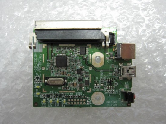

If there is something unique about your original USB-SATA bridge board, then it will be in the 8-pin serial EEPROM. If you transfer this chip, or its contents, to your donor, then you should be good to go. Such a simple soldering job could be easily handled by your local TV/AV repair shop.
If you need help in identifying this chip, then upload a photo of the component side of the PCB.

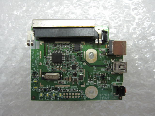

here is the controller
I can't see any markings, but the most likely chip is near the SATA connector, at about 2 o'clock to the largest IC.
yes
