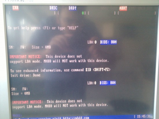

I have a WD10EAVS disk that stopped working. It was in a WD My Book mirror edition in raid 0 mode.
Now MyBook says that the disk isn't inserted. I tried it in another usb cabinet and it can't detect the device.
I connected in a PC and the bios can't detect it.
I thought that the board was broken, so I bought a donor disk. It's the same model (WD10EAVS) and it has the same board (2060-701590-000 REV A). The new disk is working.
Then I swapped the two boards, thinking that the old disk with the new board should work, but it doesn't. Then I tried the new disk with the old board, but it doesn't work too!
I tried to check information status with MHDD but I get the same message (photo shot attached) with both disks (old disk with new board and new disk with old board).
When I try MHDD with the new disk+new board, it can detect all the settings.
I think I'm missing something, but I don't know what :(
Do you have any advice or suggestion?

Heya m8. Well what you are saying that original mirror u changed and now the drives are striped right ? . Try connecting each one with their original PCBs to computer. If possible - record the sounds they make as you apply power to them. It will make remote diagnostics easier. In your situation we need both drives working to get the data. PS did u drop the caddy by any chance ?

Cant tell anything from the sound unfortunately. Not loud enough. I wanted to hear the sound the heads make as they calibrate and try to init... So with original board that drive is not seen in MHDD right ? BTW straight PCB swaps very rarely work for WDs. U need to program the donor board to be compatible with the patient drive. In some cases it can be done by moving rom at location U12. If the rom at u 12 is not present - then special equipment is needed...
So any chance u can put original board on original drive and try to record the startup noise again ? Also can u give the full model number of the drive plz.

hmm... cant say one way or the other. No clicks though. I cant tell if the heads are leaving parking or not though... Unscrew the bad PCB turn it around and tell me if there is a chip at position U12. I dont have a kermit handy so cant say if rom is embedded or not. If the position U12 is populated - u can try taking that chip and moving it to the donor board, then puting the donor board on ur drive and checking if u can see the data. Although at this time i will defiantly vote for the proper diagnostics...
