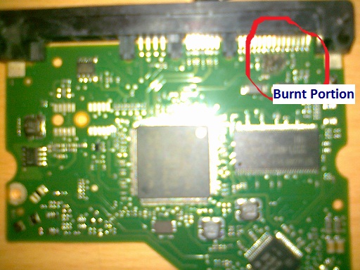

Dear Friends ,
Im new in this forum.
I have one Seagate 1 TB HDD.
Logic card is burned,so i arranged identical HDD with same model and FW and replaced logic card but its showing 8 gb in bios.
I want to recover this data.Any suggestion or procedure to recover that data.
 Post subject: Re: 1TB HDD
PostPosted: July 20th, 2011, 21:23
Post picture of your damaged pcb, low resolution, please.
PostPosted: July 21st, 2011, 9:59
Joined: July 20th, 2011, 8:09
Posts: 5
Location: Pune-India
Here damaged PCB'S Pic
PostPosted: July 21st, 2011, 15:57
Sorry, can't see well enough.

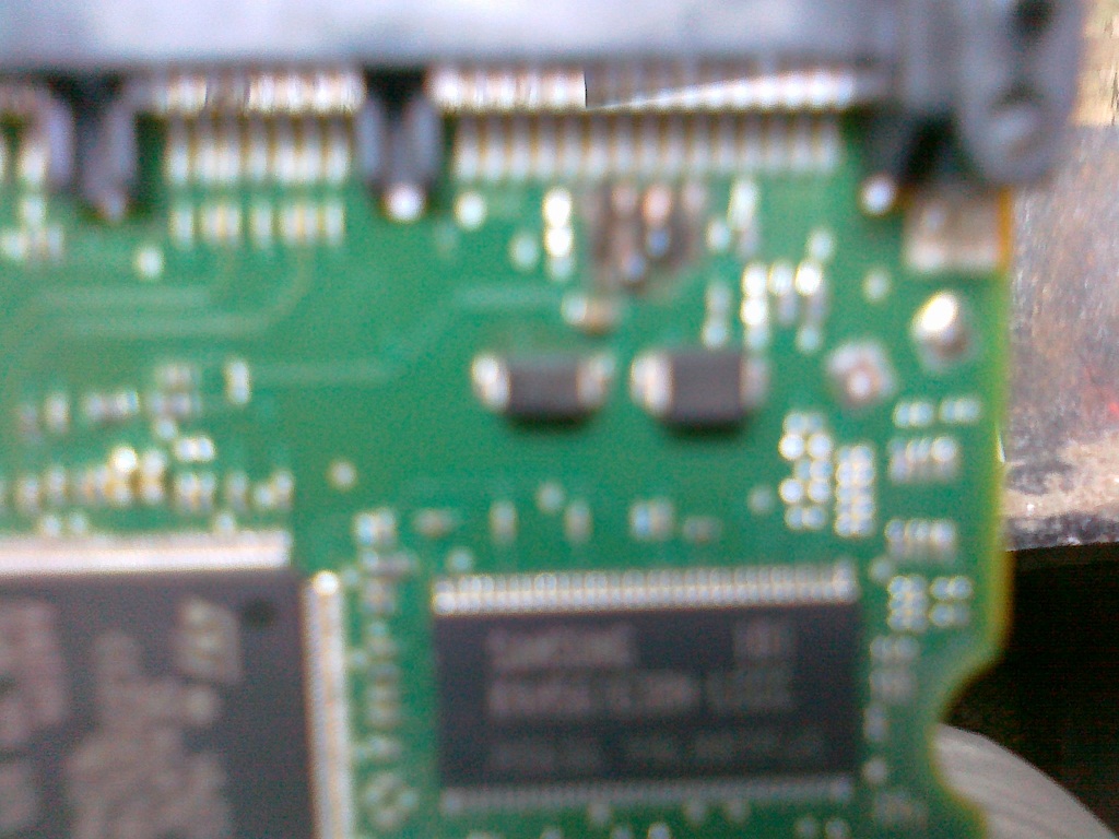

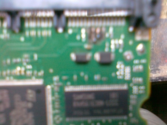

PostPosted: July 22nd, 2011, 1:21
Posts: 5
Pic of pcb

Model is ST31000524AS /Firmware JC45
i purchased another identical HDD with same model and firmware replaced Logic card.It gets detected in BIOS But showing 3.9 GB in bios,i checked this disk by seatool it passes all test.Also showing 4 gb in disk managment in windows.
Regarding solder track of pcb are bad at burnt portion

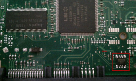

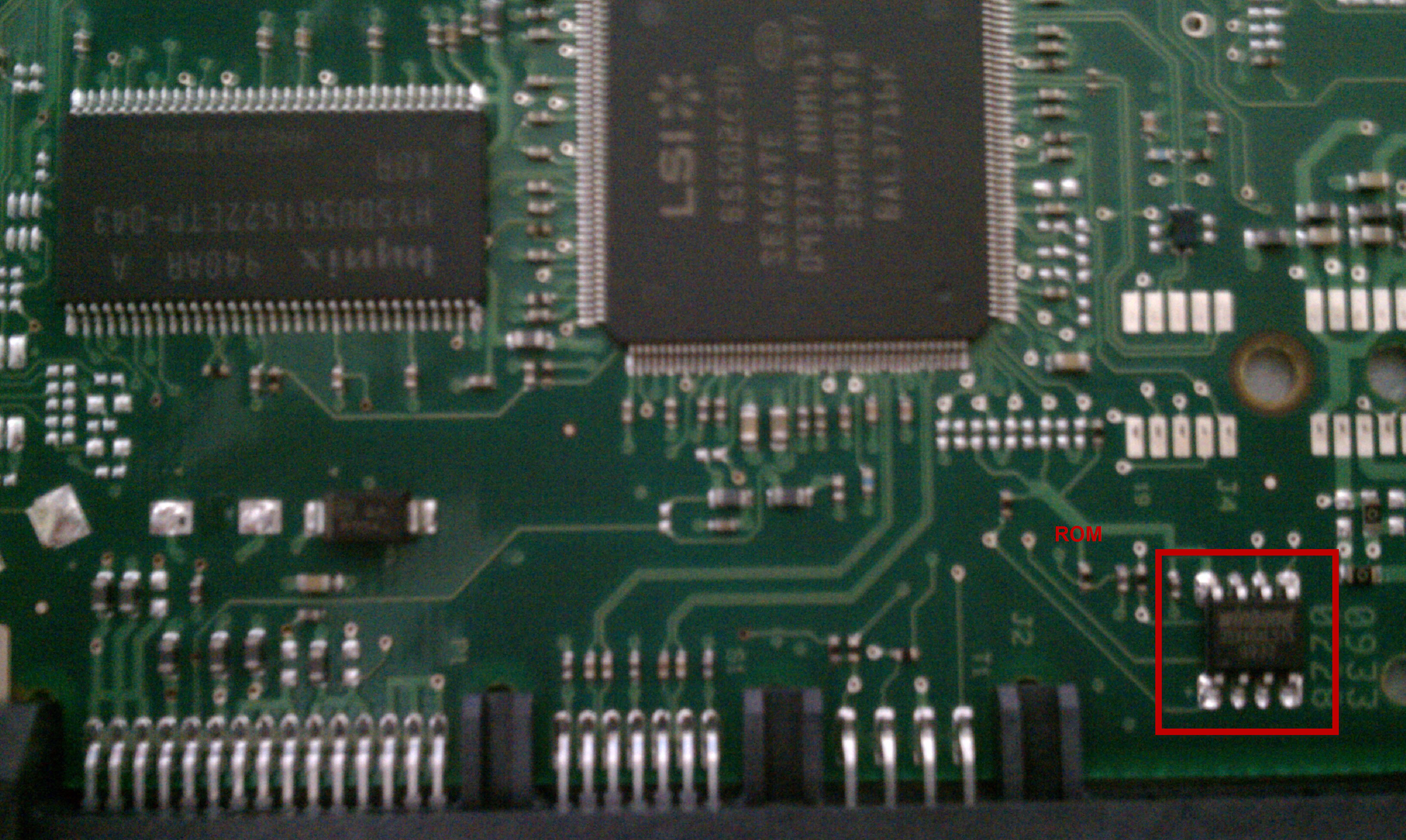

PostPosted: July 22nd, 2011, 8:23
Alright, so I like stated previously I can not quite make out from the pic what is and what is not burnt, plus there can be other components that have been damaged as well.
So, your best bet is to solder the lower right ROM chip to your donor board (marked Winbond - see pic).
Make sure you know what you are doing (suggest practicing before working on the target drive).
If you are not comfortable than let a professional do it.
If you mess up, this will be very very expensive to recover data from.

PostPosted: October 6th, 2011, 2:02
Joined: July 20th, 2011, 9:02
Posts: 91
:D Guys thanks problem solved diode short of original board replaced n got data
Thanks alot to all
PostPosted: October 6th, 2011, 3:35
Posts: 3551
:shock:
A shorted diode was giving wrong capacity in BIOS?
PostPosted: October 6th, 2011, 3:44
Posts: 91
:roll: nope used original burnt controller,replace diode and inductors.
