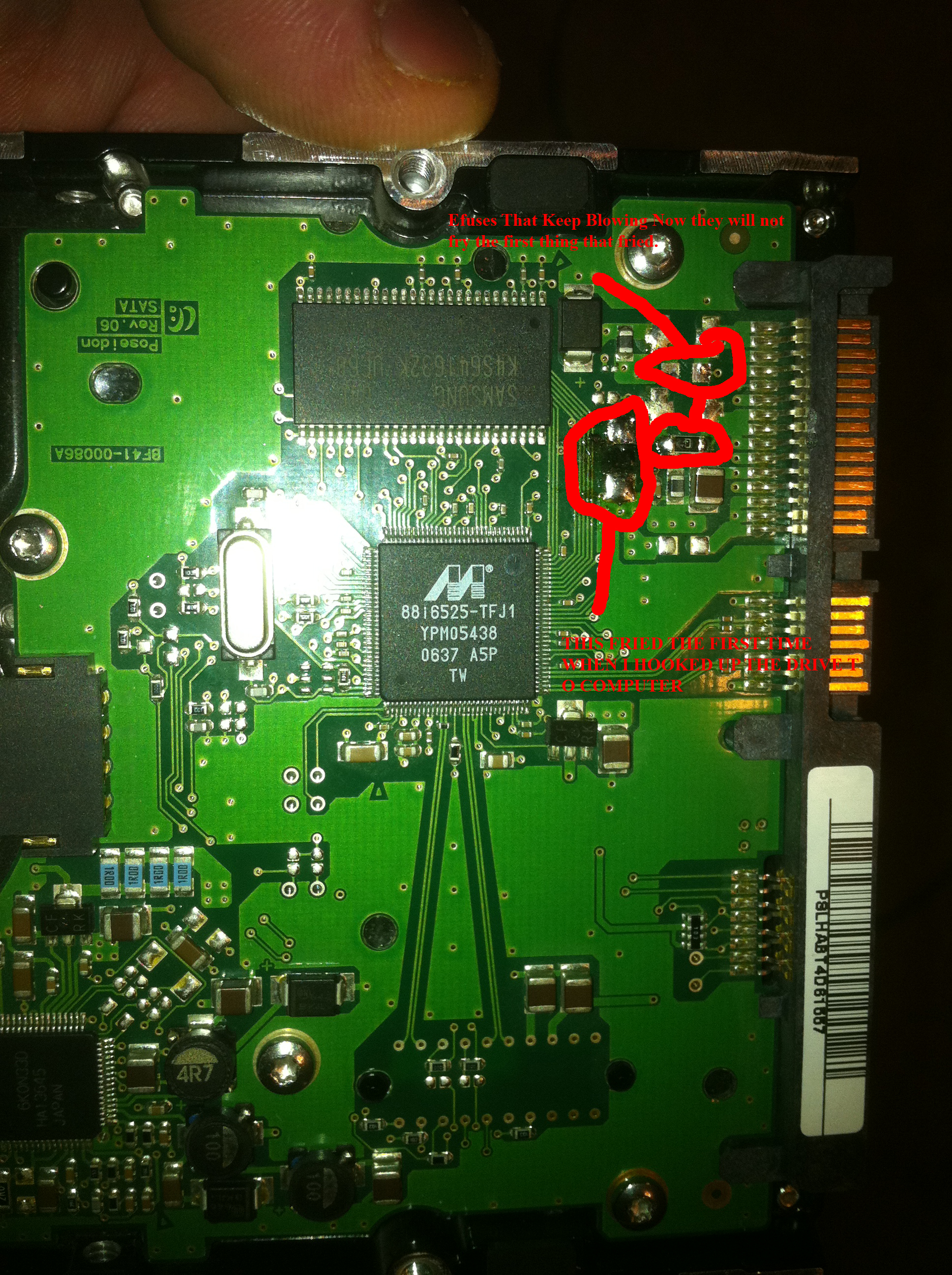

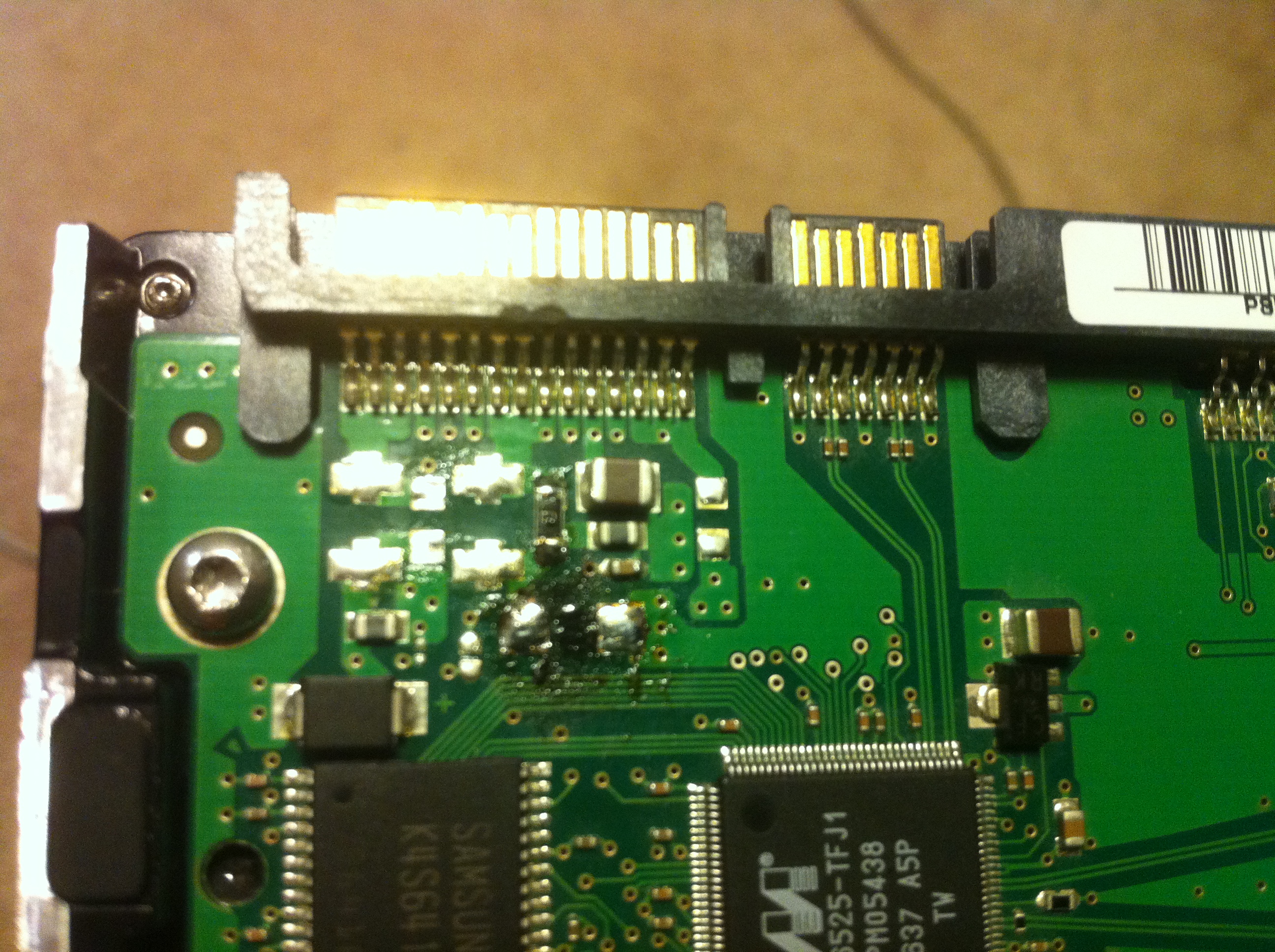

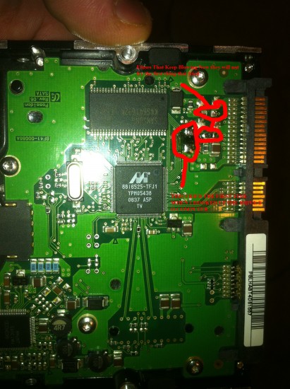

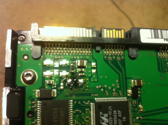

I have a samsung 250GB Hard Drive With PCB Problems
It keeps blowing 1 of the eFuses I bought a like pcb and replaced the components that blew but they keep poping?
so my question is what would make the efuses blow and the other resistor as well.
I made notes on the photo.
Thank you so much for any help
File comment: closeup of fried pcb
File comment: Shows what is fried on the pcb

If the "fuses" (= zero-ohm resistors) are blowing, then there is a short circuit on the PCB or perhaps in the preamp.
The most likely culprit on the PCB is a shorted TVS diode.
A shorted preamp is easy to determine. First measure the resistance between ground and the +5V pins at the SATA power connector with the board removed from the drive. If there is a short, then check the 5V TVS diode. If there is no short, then install the PCB on the drive and perform the same measurement again. If a short now appears, then it will be due to the preamp.
