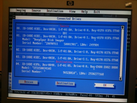

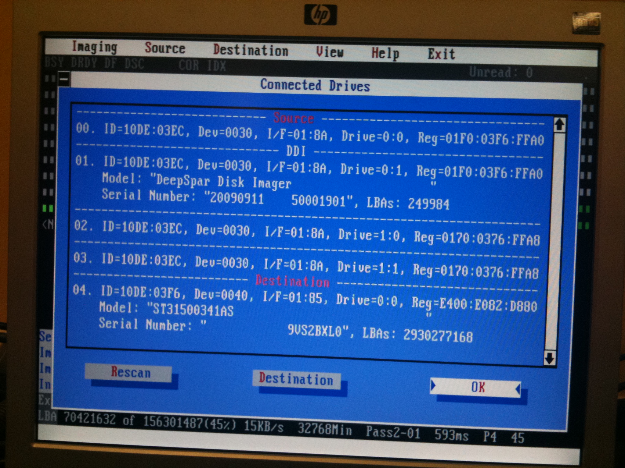

Hi
I have seagate 160GB hard disk
Seagate Momentus 7200.3
ST9160411ASG
PN: 9GEG42-034
FW: DE16
The hard disk give mild constant beeping sound. You can hear it here
http://www.youtube.com/watch?v=eFP3uPQuvUI
When I connect to DDI, it seems to come ready and when I scan I see the following in the attached screen shot
Please let me know what could be the possible issues with this disk?.
Thanks for your help
Cheers
-Jag

Heads stuck to platters.

Yes, sounds like it. But the DDI screen does not show the classic signs of it.
Open the media and see if the Head Stack Assembly is not on the load ramp or in the Inner Diameter Landing Zone area. If the heads are in the Data Zone be very careful when moving them to the correct spot.

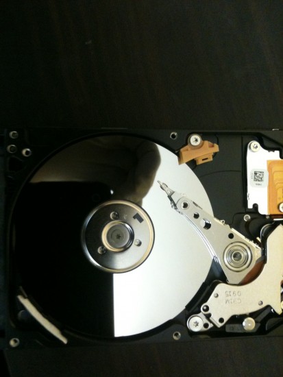

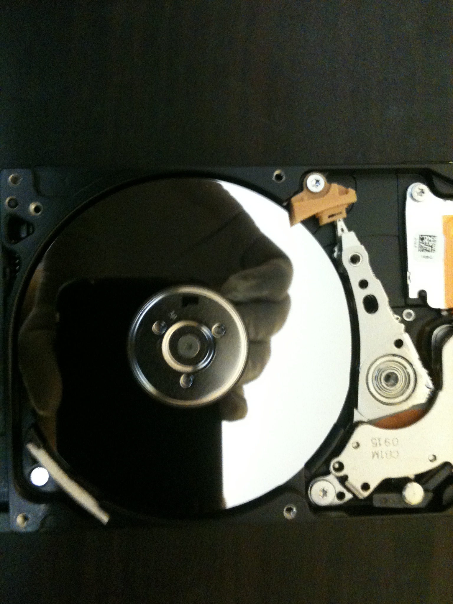

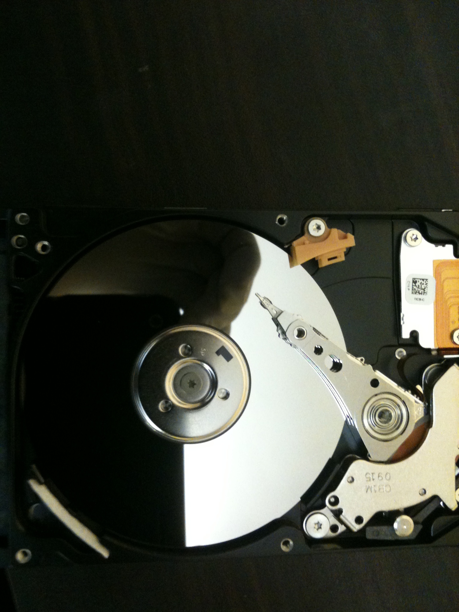

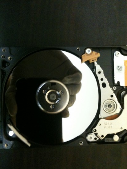

 Post subject: Re:[SOLVED] - Seagate hard disk - mild constant beeping soun
PostPosted: June 24th, 2010, 4:48
Joined: May 19th, 2009, 5:05
Posts: 97
Location: Singapore
Yes it was due to stuck head on platter.
after moving the head to the ramp, I was able to image using DDI.
I have attached pictures before and after picture, I hope will be helpful for beginners
Thanks for all your help
Cheers
-Jag

For beginners:
Please note that when moving the head from the platter to ramp, need to rotate the platter slowly in the direction where the arm is pointing to.
Your rotation of the platter and movement of head to the ramp had to be done simultaneously and slowly, otherwise you may break the head.
Cheers
-Jag
