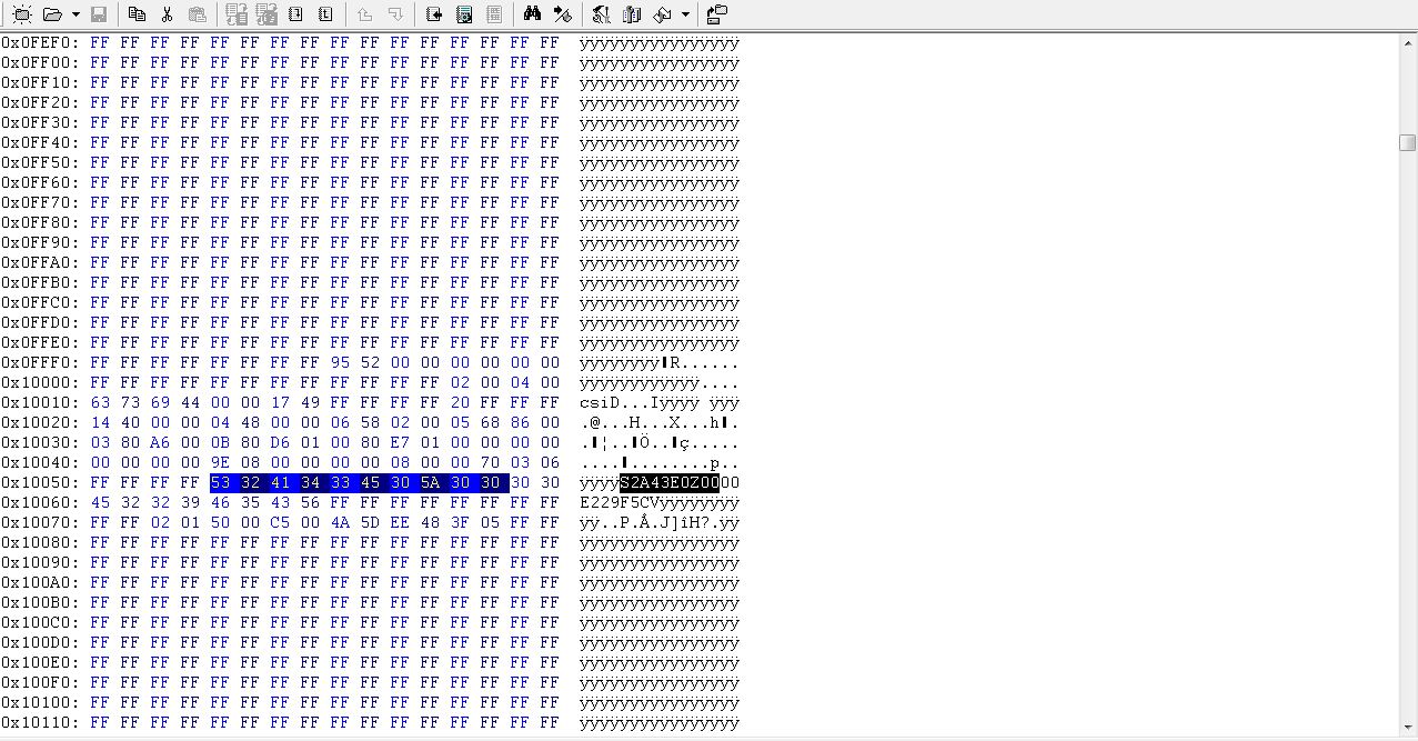

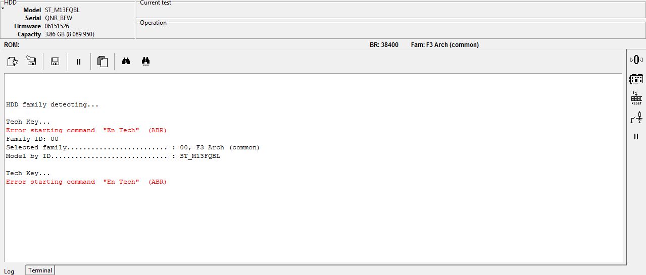

ST3500413AS JC66 which initializes perfectly, as if FW issue but does not give terminal access even after shorting Read Channel. DRD DSC okay.
Has any one faced this issue ever ?

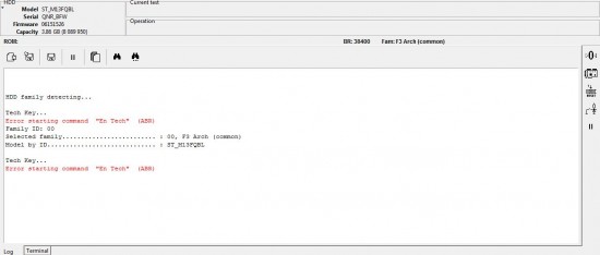

This drive definitely does not initialize perfectly. In fact, it doesn't initialize at all, based on what I see.

Unless you accidentally posted the wrong picture, the SN in your picture is not a true SN. It is a generic code. Unlike other F3s, this model is one of those that does not seem to post the SN.
If the heads are good, then the problem is likely related to firmware corruption of some sort. Have ruled out the PCB already, just to ensure?

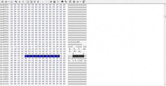

When i say SN means i am talking about the Sr No. in ROM
Pls check the attachment
So it looks like SA corruption. Any chances of retrieval ?
