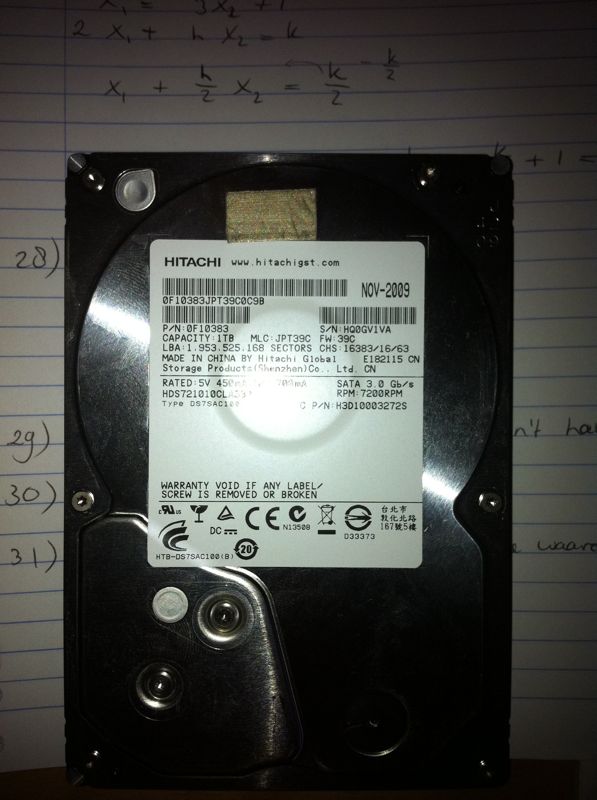

 Post subject: Hitachi HDS721010CLA332 wouldn't spin
PostPosted: September 14th, 2011, 6:41
Joined: September 14th, 2011, 6:21
Posts: 10
Location: Netherlands
I've got a Hitachi HDS721010CLA332 but it wouldn't start spinning at all. So I bought a smiliar drive, same P/N, firmware and MLC.
Then I replaced the PCB with the new one. Now you can feel the motor starting to spin after. But after a few seconds it stops. There are no strange noises like clicking of the headset of something like that.
Does anyone have an idea? Or can I check some parts by measuring with a multimeter?

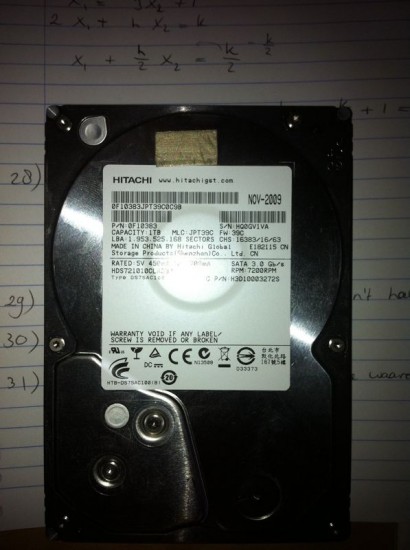

I've attached a picture of the broken hard drive. Within a few hours I'll add more pictures of the new one and both PCB's.
File comment: This one is 'broken'.

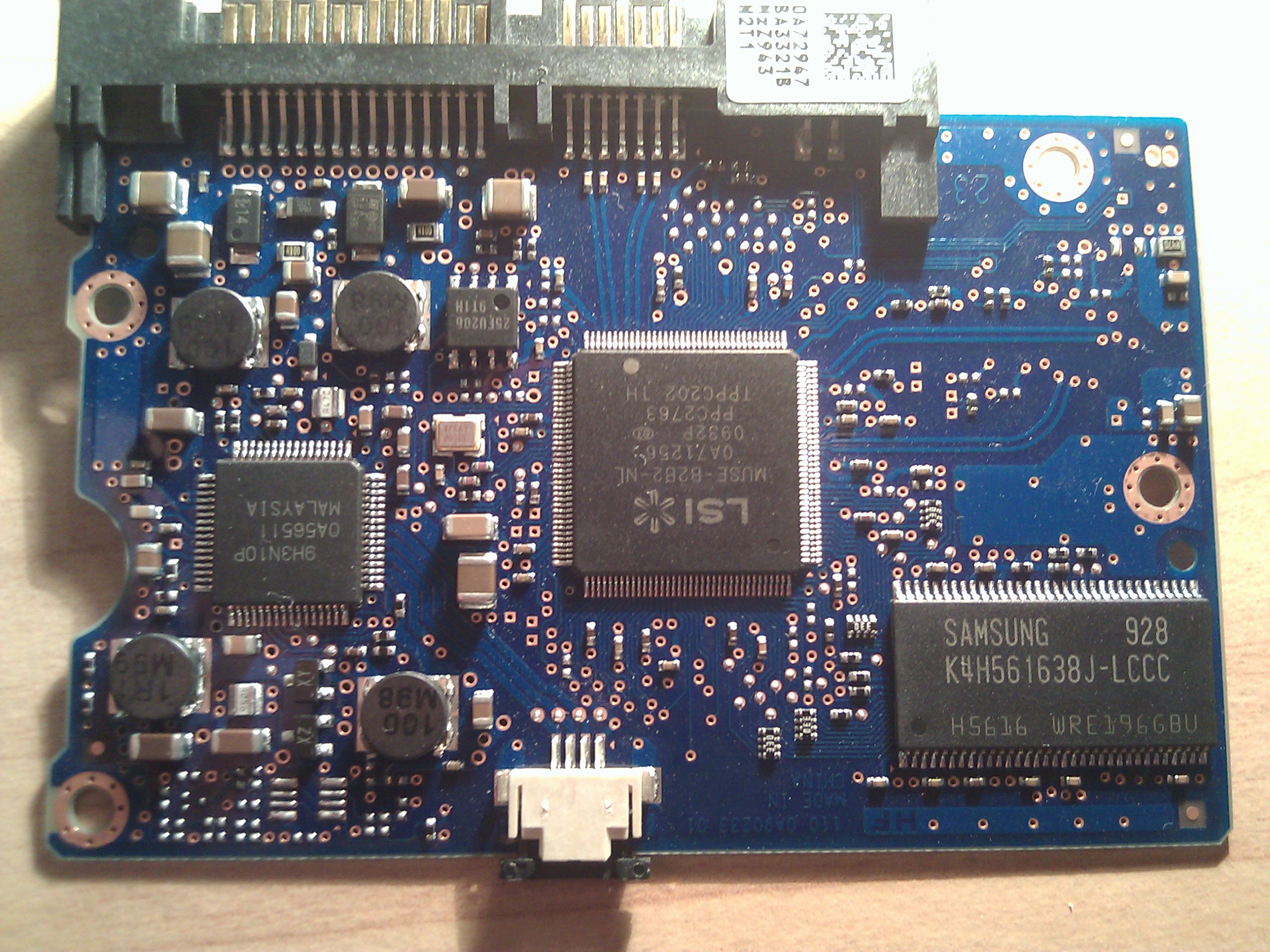

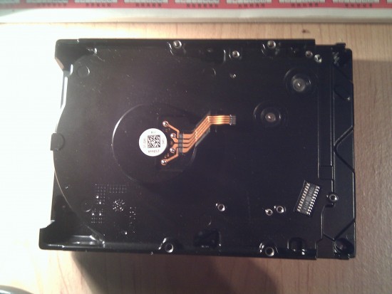

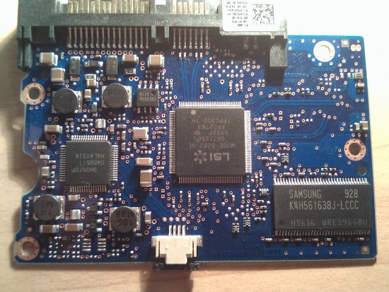

 Post subject: Re: Hitachi HDS721010CLA332 wouldn't spin
PostPosted: September 16th, 2011, 14:32
Posts: 10

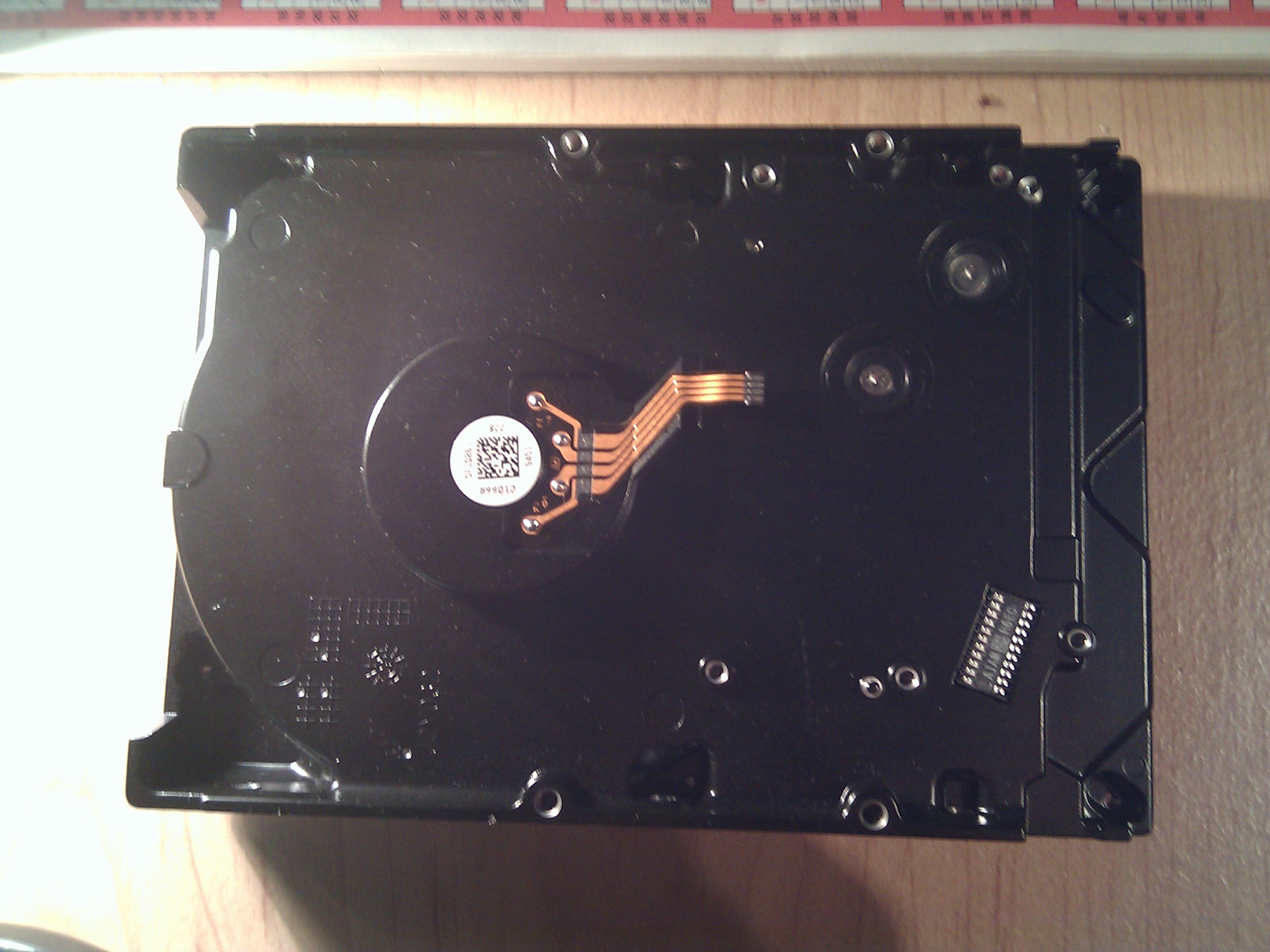

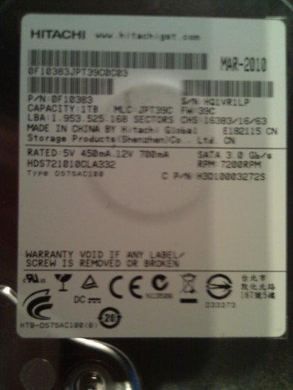

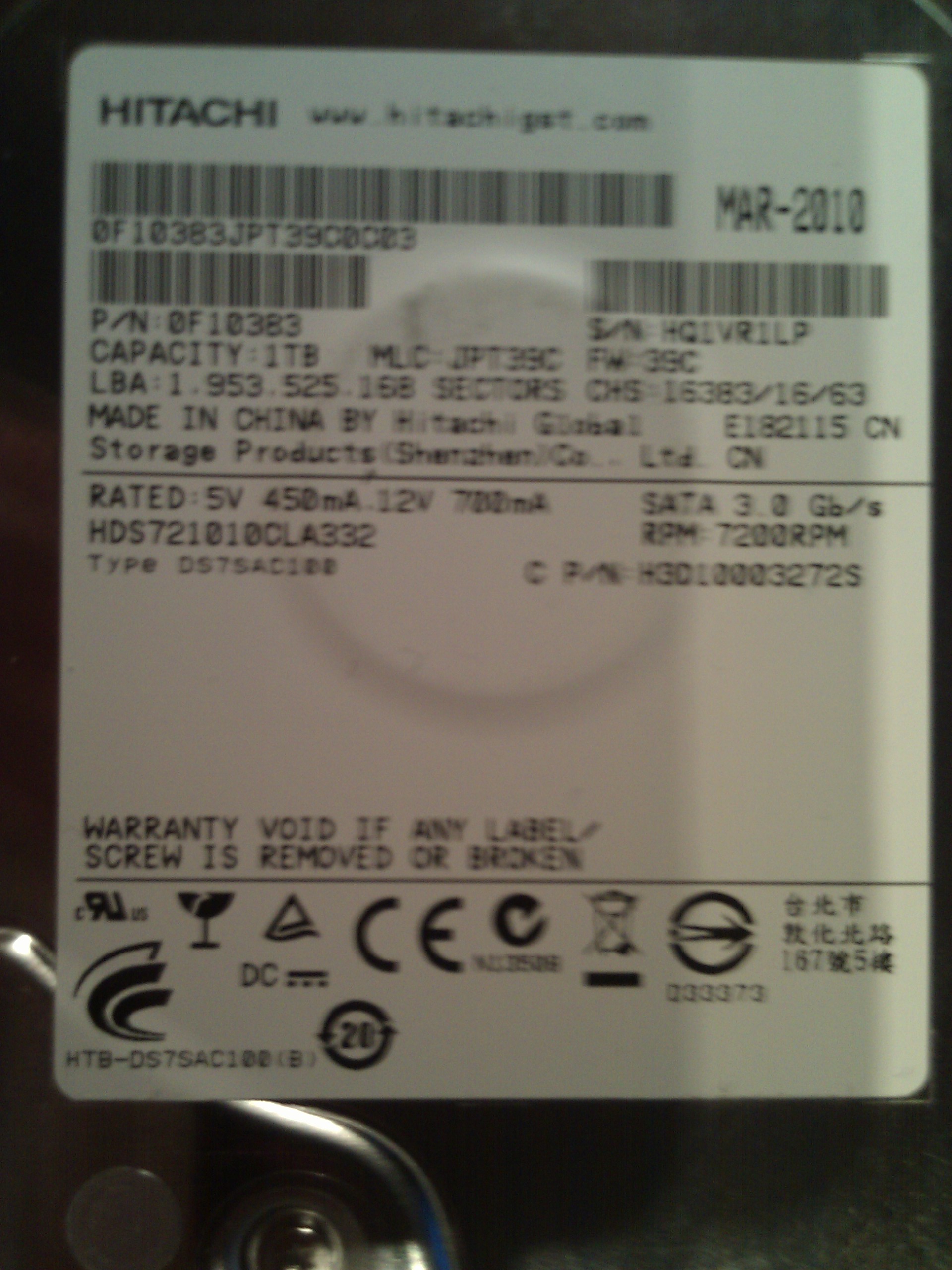

Here are more pictures. I was editting the post before but I got an announcement that I couldn't edit anymore..
File comment: Drive without PCB
File comment: New HDD
PostPosted: September 17th, 2011, 16:40
Posts: 1752
You can try to swap 25F chip at your own risk and if your data is not that important.
PostPosted: October 15th, 2011, 8:16
Joined: February 2nd, 2011, 12:41
Posts: 31
Location: France, Strasbourg
Be really carefull when removing the chip on the new pcb not to damage board contacts and other components. If it's your first time, would be really better to find some older PCB and have some trainning before…

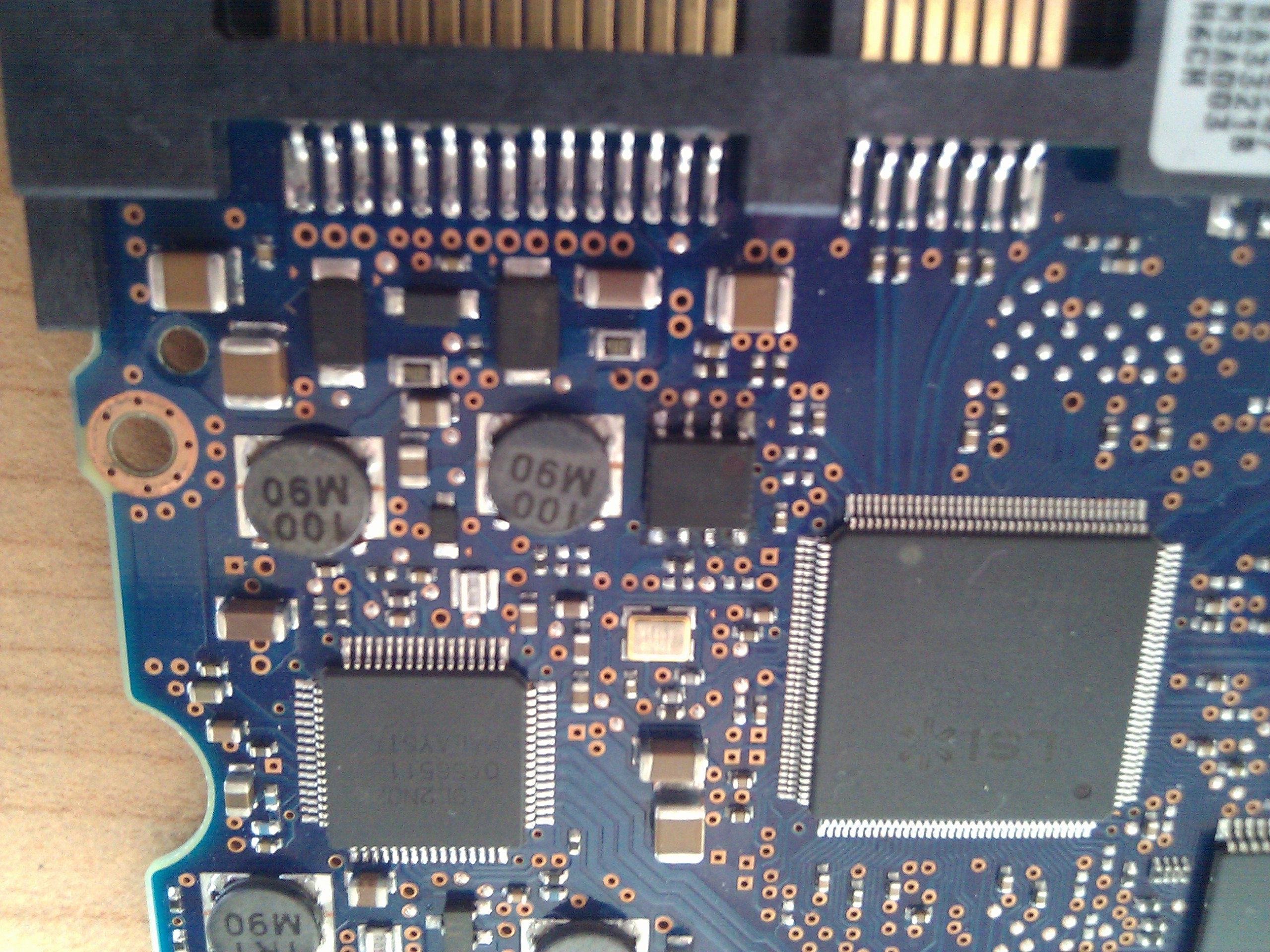

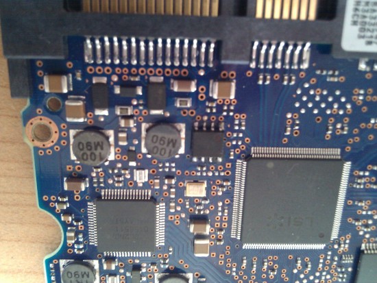

PostPosted: October 17th, 2011, 7:13
Posts: 10
Well, It is spinning once, at start-up. Then it stops. So, it would keep spinning till complete start-up.

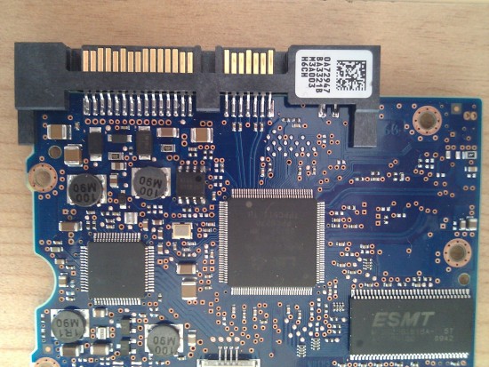

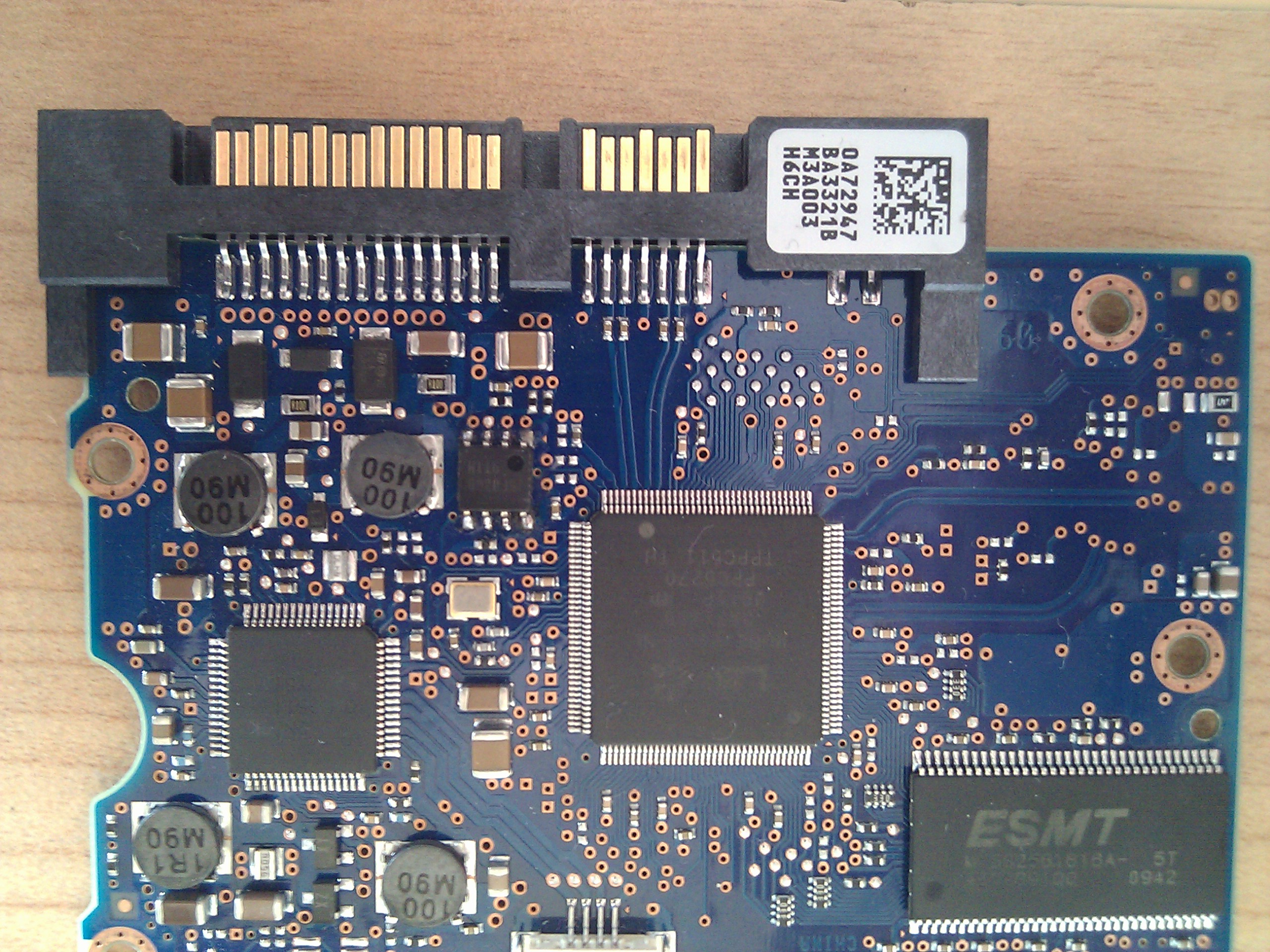

File comment: New PCB with old NVRAM
PostPosted: October 17th, 2011, 8:42
Joined: July 21st, 2010, 5:03
Posts: 247
Location: Norfolk, UK
If the drive spins up to the point of comming ready, then spins down again (i.e. does NOT come ready) with NO abnormal sounds, then this is most probably an NVRAM issue (quite common in these drives). If so, you will need specialist tools and knowledge to fix this as it's not DIY'able.
