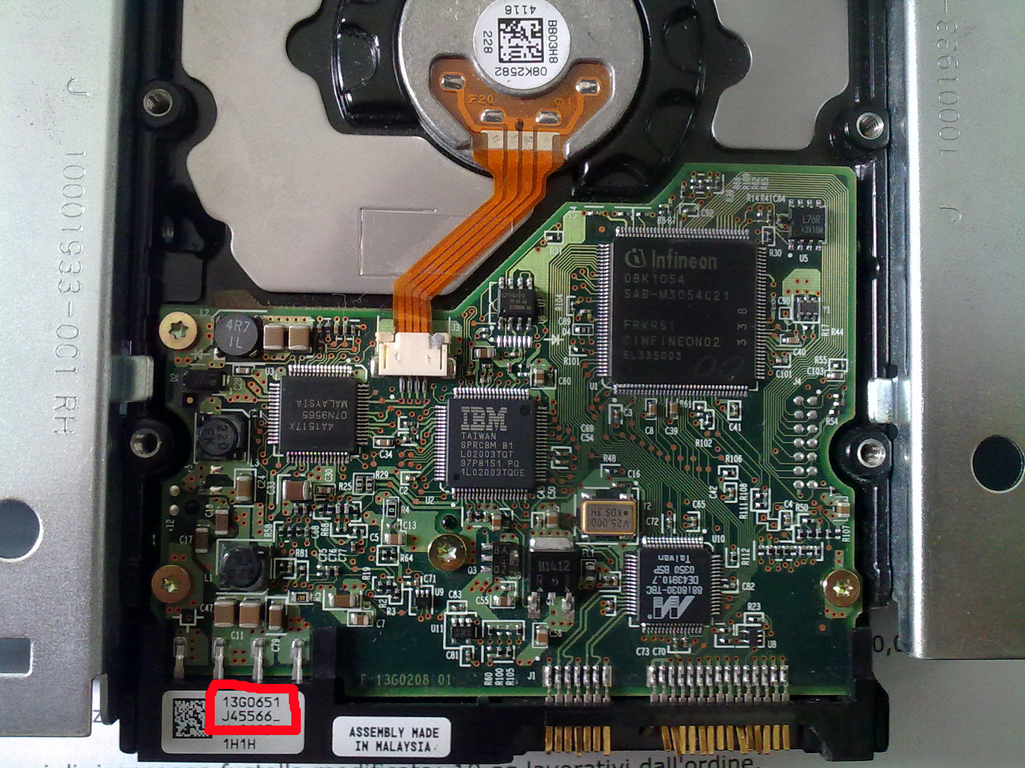

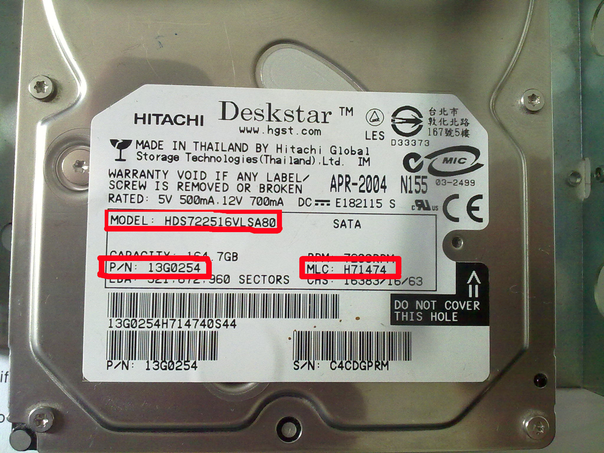

Good day,
I'm looking for a PCB (new or refurbished) for my hdd Hitachi because I
think the elettronic part is fault.
Hdd doesnt give out strange sounds from the internal disk when it's working
after pc is starting but the bios doesent recognize (it's master disk)
I think could be only a elettronic fault so replacing the PCB maybe I could
use again my hdd without lose my data or recovery immediately my data and
then use it as a paperweight in order to leave out any future problems :)
So, below the features who I read on the label.
model: HDS722516VLSA80
p/n: 13G0254
mlc: H71474
on the molex connector there is this label: 13G0651 J45566_XzG4051H1H
Do you have the right pcb for me or any idea?
I suppose MLC number must be the same, however from the same hdd model, must
be?
Could I solve my problem just only swapping the PCB?
Thank you very much for your support.

 Post subject: Re: Hitachi HDS722516VLSA80, pcb need....
PostPosted: May 15th, 2010, 3:33
Posts: 17316
You may need to transfer "adaptive" calibration data stored in EEPROM, from patient to donor.
Here is a datasheet for the component at U5 :
L76R, Microwire BUS 8Kbit (512 x 16bit) EEPROM, SOP-8P, BR93L76RF, Rohm:
http://www.rohm.com/products/databook/e ... r93l-e.pdf
I can't see the numbers on U7 (to the left of the Infineon chip at U1).

PostPosted: June 14th, 2010, 2:41
Joined: May 14th, 2010, 11:08
Posts: 6
Location: Venice
BlackST wrote:
Che sposti il problema da un disco all'altro o ne rompi due :mrgreen:
..that you shift the failure from one disk to the other or you have 2 broken HDDs
Very cool news.
I bought an used PCB from Ebay from same drive manufactured in the same month (April 2004) and same MLC: H71474 and same main chip number.
Well, some people told me swapping bios on the donor PCB maybe was the only one solution and not sure.
Some other people told me swapping was useless.
Some people told me trying the donor PCB on my hdd without swapping sure this operation would destroy it.
Well people: Friday I received the PCB, just for curiosity I tryed to install it without any swapping operation and.......WORK!
Immmediately my laptop recognized the drive and I get back my data.
The hdd now is perfectly working and booting.
This post just for information.
Thank in any case to everybody.

It was good luck , most of the time swapping ROM is required .
PostPosted: June 16th, 2010, 15:00
Posts: 489
If you simply Swap boards you can risk NVRAM overwrite.
Then the headache will become a migraine.
