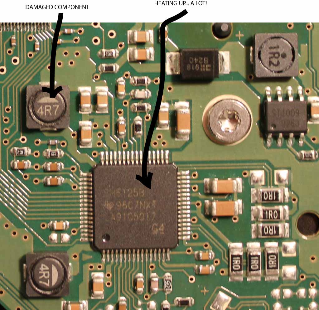

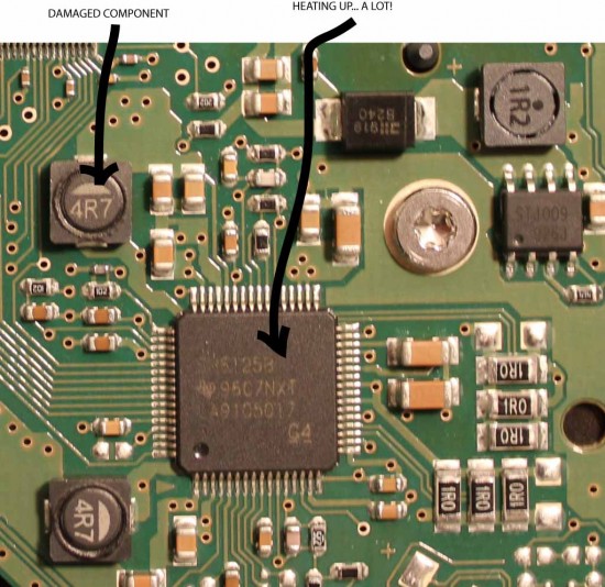

Hi All,
Firstly, I would like to state that I am completely new to the art of DR. I am from South Africa, so responses and requests for information will be slow.
As such, please bear with me.
On to the issue:
I have the above drive. The drive was working, and plugged into a machine using a "drive walker" as we call it, transferring PDFs for a print run. I managed to damage, while transporting the drive back home, the component marked. Now, when I power up the drive, the second marked component heats up. I would dearly love to recover the data from this drive but if I lose it, so be it. Also, 1.5TB is quite huge here, so its a great loss for me considering the price of drives here. The attached image is one I found on this forum and is exactly the same as mine.
I can post a pic of my board tomorrow, with the 4R7 marked component removed. I have access to an electronic technician with a wide array of tools etc (Hes a SonyCam repairman)... If there are any questions, you can also mail me directly, if you wish, on brendan at adsend dot co dot za :)

The damaged component is an inductor. It is an important component in either the Vcore or Vio supply for the MCU chip. The chip that is heating up is the motor controller. It contains the MOSFET chopper that energises the coil.
The worst case solution would involve a board swap and NVRAM transfer. The NVRAM chip is an 8-pin component -- it stores drive specific "adaptive" data that must be transferred to the replacement PCB. I have no idea what Nick_CT charges, but a typical firmware transfer or "ROM" transfer costs between US$10 - $20. Some board suppliers will even include it for free.

that said, I think replacing the board is unnecessary. Im currently trying to source the correct inductor to replace the one I damaged. Unfortunately, Im having a little problem: its quite easy to find a 4.7microHenry inductor to replace the one that was damaged. However, Im not sure if the one that was damaged IS 4.7... It DID have 4R7 printed on it, but Ive already found ANOTHER inductor with 4.7 emblazoned on it but that one was actually WAY different... so Im a little wary of what I put onto the board.
We managed to find a 4.7 (radial) on an old sony board BUT it didnt change the drives behaviour. (no spinning up, overheating chip), so I suspect that either the inductor was faulty or there is something else wrong. Also, we have access to thousands of old camera boards and just need to look. Im sure Ill be able to find a replacement motor controller in there somewhere... If the motor controller is heating up, what else could possibly be wrong? I think we can safely assume that both TVS are intact, since the heating means there IS voltage reaching the controller which means the TVS' are working as normal, or am I wrong? Also, since the controller is heating, doesn't that mean that something AFTER it on the board is faulty, or is my logic like my board: FUKCED?
However, I KNOW that there was nothing else I damaged... The screwdriver bounced DIRECTLY off the inductor... We checked the board for cracks and also checked EVERY track for damaged using a multitester. FLUKE ROCKS! Nothing wrong. Now, if I can get a few pointers, Ill be happy to try ANYTHING. Dexter says that he can move the NVRAM easily.

4R7 is 4.7
Here is a datasheet for a typical HDD coil:
LPS3015 Series SMT Power Inductors, Coilcraft, 3mm x 3mm x 1.5mm:
http://www.coilcraft.com/pdfs/lps3015.pdf
Note that the DC resistance is very low (0.2 ohms) and the inductance is flat all the way to 10MHz. I believe that switchmode DC-DC converters in recent HDDs have switching frequencies in the MHz range.
BTW, I'm not a data recovery professional, so I can't be certain that a chip transfer is necessary for your Samsung PCB. I have seen threads where some DR specialists say that a chip swap is required, whereas others say that a straight board swap should work. I have also seen a thread where an end user was only successful after transferring the chip.
If you have a multimeter, measure the voltages at the two 4R7 coils. One will be the Vcore supply for the MCU, the other will be Vio, probably +2.5V or +3.3V. Also measure the resistance between each coil and ground.
The 1R2 coil is part of the negative supply for the preamp. Measure the voltage at the anode (non-striped end) of the B240 diode to the left of the coil. I believe you should see -5V.

The datasheet for your component indicates that it has a DC resistance of 4 ohms and a current rating of 280mA. AFAICS, that makes it unsuitable.
http://www.mantech.co.za/datasheets/pro ... WXXXXX.pdf
The part that I have recommended was called out in an application note for a DC-DC converter used in SSD applications. Therefore I suspect that it would also be suitable for HDDs.
I would measure the DC resistance of the second 4R7 coil for comparison purposes.
I suggest you also measure the resistance between the coil and ground. This will tell you if there is a short circuit on the load side. If so, and if the regulator supplies the Vcore, then the MCU will be dead. Otherwise, if the short is on the Vio supply, then it could also be that the SDRAM or flash are dead.

Ive measured the resistances and here they are:
At the damaged coil: on the 200 setting, one side gives 46.5 Ohms while the other side is out of range. A continuity check proved positive.
At the second 4R7 coil: both sides give 1.1 on the 200 setting.
at the 1R2 coil: 1.1 on both sides.
HOLD ON! I think my stupid el cheapo meter needs calibration, since when I touch the probes together, it gives a reading of 0.9... Would this then indicate continuity at the 1.1 ohm readings, which would mean those readings indicate ground?
I also noticed that the striped ends of the TVS' arent aligned... its as if one was mounted wrong way around. Is this correct? I shouldnt be questioning this since the drive was INITIALLY working...
