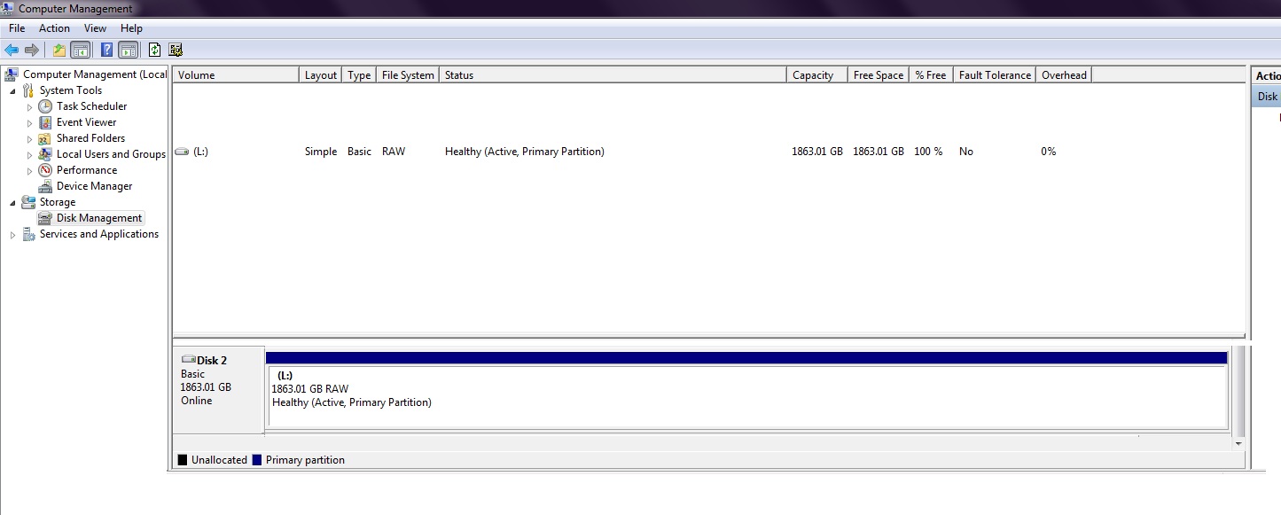

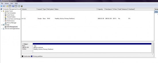

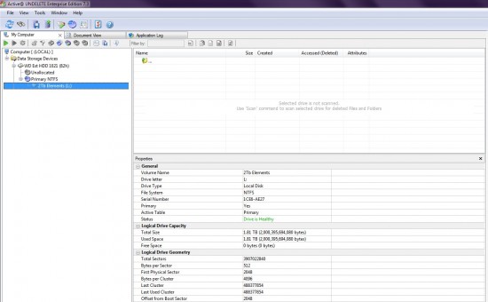

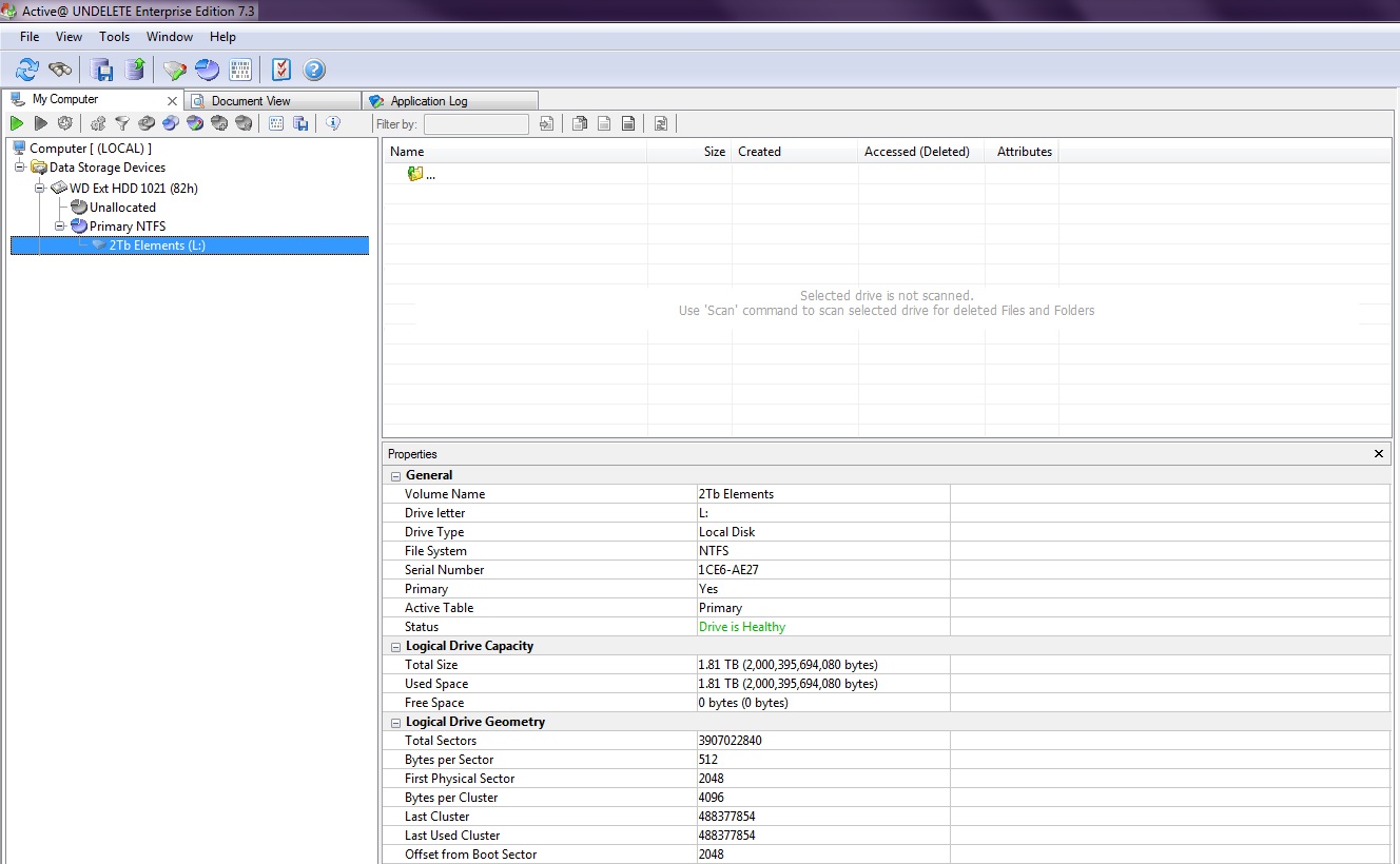

I have windows 7 on my computer. I plugged in my 2Tb HDD, used it, then unmounted it. During the unmount it told me that the drive was in use a couple times, then it unmounted. I plugged it back in later and now my computer shows it as "Local Disk". I opened Computer Manager, went to Disk Management, and the HDD shows as RAW. Using the program Active@UNDELETE I view my HDDs and the HDD displays as two partitions, the small unallocated partition and the Primary NTFS that looks perfectly normal like it should. Then I noticed that under Logical Drive Capacity it says that the HDD is full, it's is not even close to being full. I then scanned the HDD with Active@UNDELETE and I can see all my files. I have looked for an answer but I am not asking Professor Google the right question to get the answer I am looking for. So am I correct in thinking that my partition table is corrupted? If so, how do I correct the issue? I'm not sure if my Hirens disk has anything on it that will help me. I don't have Partition magic but could download it or Active@Partition Recovery. Any help will be much appreciated. Thanks

chkdsk will not run because my computer sees the drive as a RAW drive. The Active@Delete picture above shows how everything was before the issue, it's the same as it is now. The program sees it properly but I cant seem to get a computer to see it that way. I do see that the boot sector shows all 0s

chkdsk will not run because my computer sees the drive as a RAW drive. [...] I do see that the boot sector shows all 0s
Assuming you're referring to the partition boot sector (a.k.a. volume boot record etc.), then that explains why Windows report it as a raw filesystem, and why chkdsk won't run. I believe that leaves you having to do manual filesystem analysis & editing (with all the risks & requirements that has), to achieve your aim of not formatting that partition - I can't think of any other options for you, within the limits you have set.
