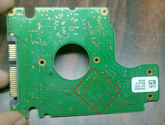

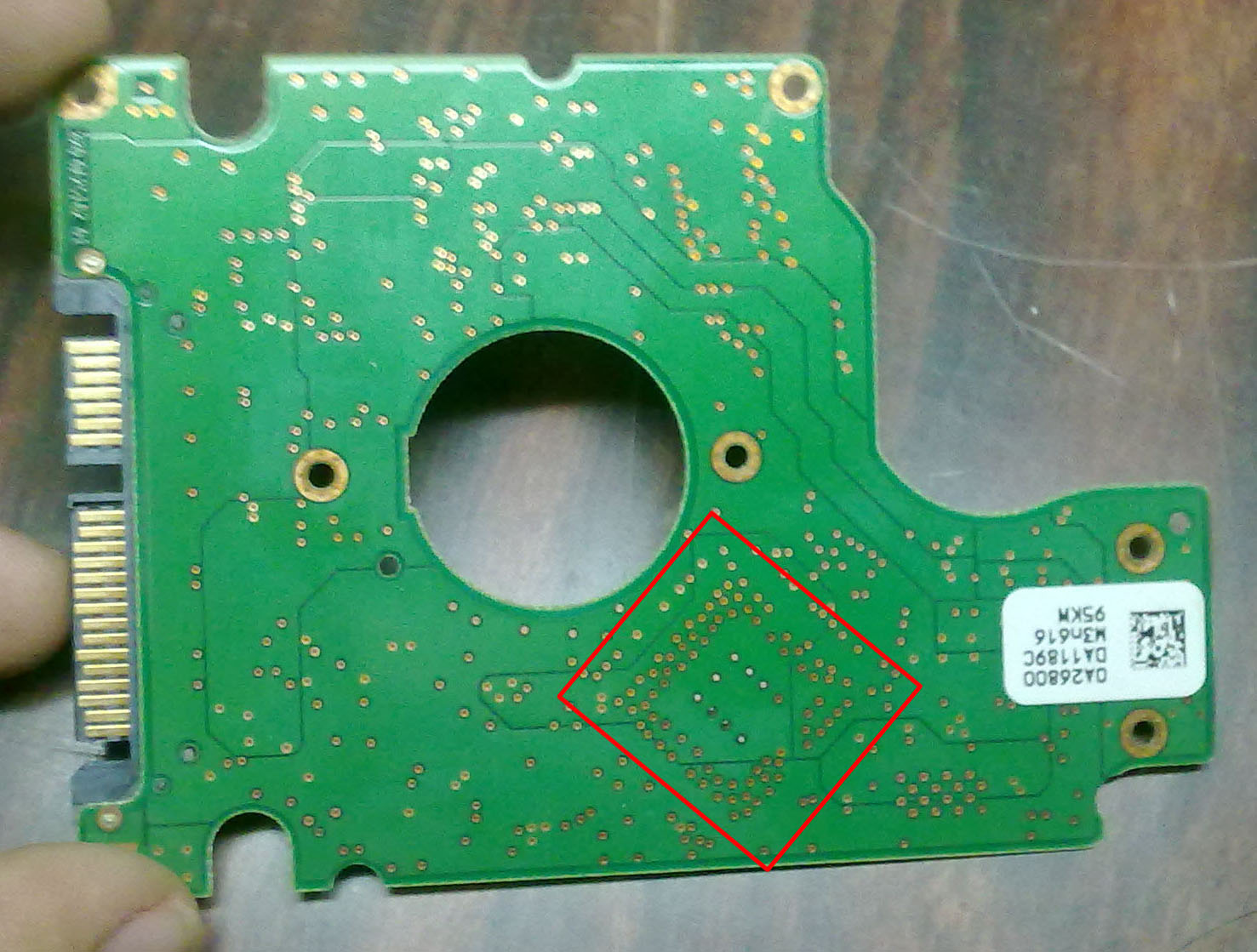

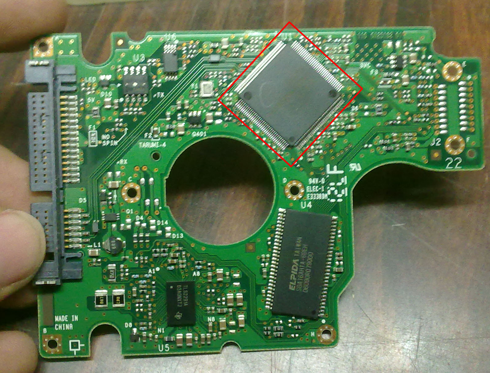

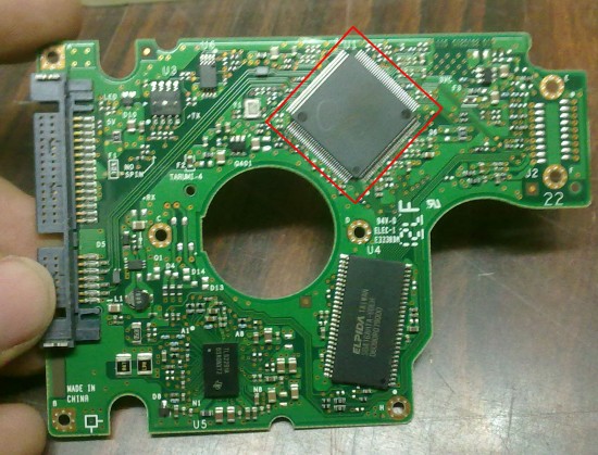

The hard drive does not spin and the IC marked in red box gets heated after i connect the hard drive
File comment: the portion marked in red gets heated

If you want to try a PCB swap, you need to find a donor with the same first two lines on the white sticker: 0a26800 DA1189C.
Then, you'll need to swap the ROM chip, which I believe will be the little 8-legger in U6 (I'm sure *someone* will correct me if I'm wrong).
Hope this helps!
