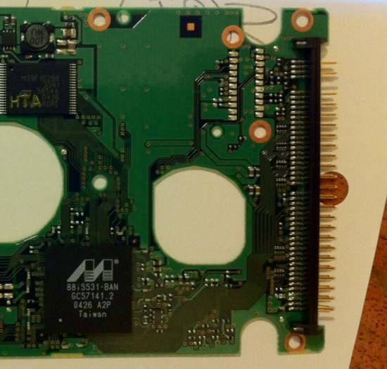

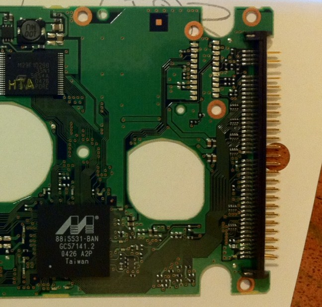

OK,
I have now got the donor hard drive, and before I started taking it apart I plugged the donor drive into my 2.5" PATA USB adaptor and it was detected by OS-X immediately (good start). I then took the logic board off the donor drive and attached it to the failed drive and then connected it as above.
Immediately the drive span-up (it wouldn't do this before) and I heard a second or two of disc head movement (normal sound - no horrible noises - I was feeling confident), but then it was not detected by OS-X, it just sat their spinning, but nothing else. I tried the disc in an XP PC (using the same USB adaptor), and the results were the same, it wouldn't detect!
Where should I go from here?
Could it be that the drive is OK, but doesn't like the donor logic board?
Is it worth trying to fault find the old logic board to see if we can get any further?
@fzabkar, you mentioned the fuse located near the ATA connector, can you identify where the fuse is on this photo (to confirm that I was shorting the right part when I tried it before).
Thanks in advance
Robbo100

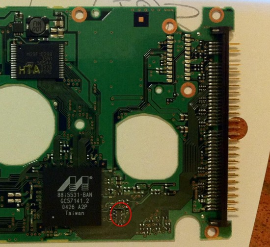

The fuse is located in the bottom right corner of you photo.
Here is the fuse on a similar board:
http://www.users.on.net/~fzabkar/HDD/MHV2100AT_fuse.jpg

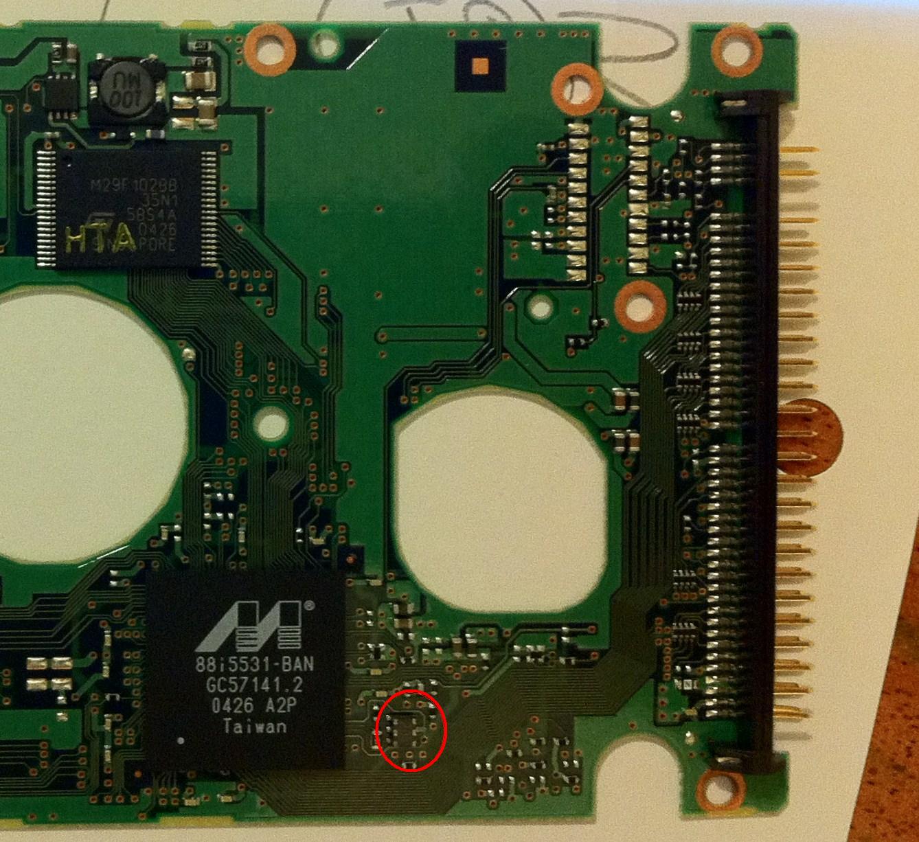

Thanks fzabkar,
That is the item I shorted, and it didn't work.
I have been told via PM that I need to also swap the ROM, so I am looking into that (I have a friend at work who has done this before).
Can anyone tell me what item the ROM is on the photo. I think it is the item in the red circle, am I right.
Rob

The chip in the top left corner, with a part number of M29F102BB ("HTA"), is a parallel flash memory. It is the so-called "ROM".

I have successfully transferred the ROM (well, I say "I", but what I mean is that I got someone with more skill than me to transfer it).
The drive is now correctly recognised by the operating system (but showing no active partitions).
Now to recover the data (hopefully).
