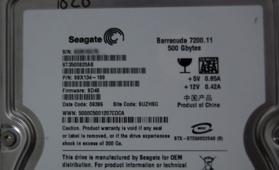

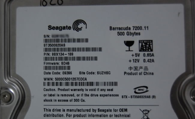

I've got a tough one.
SUZHSG.
 Post subject: Re: Seagate 2TB head compatibility
PostPosted: November 3rd, 2011, 5:59
Posts: 2984
Suzhou plant in China maybe?
PostPosted: November 3rd, 2011, 9:23
Joined: May 5th, 2004, 20:06
Posts: 2782
:lol:
SUZHSG= China-Singapore Suzhou Industrial Park
