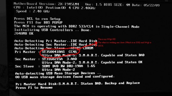

This is Sheeraz. I have a SATA hd (500gb)
One fine day out of nothing my computer showed me an error saying my hard disk might be unstable and may crash and i should make a back up and in the process of making the backup my pc rebooted and now it does not boot anymore..
I checked my hard disk by connecting it to other computers as a slave disk..
Now the thing is that it is being detected in the bios , but when i boot in the OS it doesn't show it. Even when i try to install a new OS then two things happen -
1:- When i try to install Win XP .. during the setup it shows the partitions but when i try to either delete or format a partition it says it cant and aborts.
2:- And when i try to install Win 7 Ultimate.. it just doesn't detect the drive itself.
I need help desperately because I am a VFx artist and all my work that i have done yet is on it, including a lot of pics which are equally precious.
Any help or suggestions will be truly appreciated.

1. Need more info. What drive it is, make, model...
2. If i understand correctly, your disk contains all your important data and yet you tried to install new OS on it, format it, delete and create partitions etc?

I have attached a photograph.. i hope it'll give all the required details...
And about formatting and deleting the partitions .. If my disk is being read in the OS . i can recover all the data that was thr on it no matter how many times has it been formatted...
But my biggest issue is that it is not being detected in the OS...

I appreciate it brother. But this isnt the first time i have formatted the drive and recovered the data from it. I have asked a pro, he worked on it but he dint have the time. I will get back to him whenever possible. Anyways thats altogether a different matter..
The only problem which i am facing is it isnt being detected in the OS.
I am trying to format it coz that wud reset the MBR and according to what i figured thats what is stopping it from being detected in the OS.
So.. Any help.. Any ideas..

Again, i don't think the MBR has anything to do with the problem of your disk.
Nor is formatting and deleting partitions an accepted solution to ANY problem regarding a disk that has critical data stored inside.
Having said that, i would suggest you run a Linux LiveCD and see if you see the disk there.

Your target is wrong - you do not need to make this drive readable in Windows (and in fact you should not try to do so, based on the symptoms you are seeing now).
I am not guaranteeing to hand-hold you through to recovery via forum messages (it is very inefficient in cases like this, and I have a real day job to do), especially since you have already been getting good advice from northwind, but if you answer all of these questions, you may get further suggestions:
a) Do you accept the risks that your DIY actions might make things worse, and during DIY attempts, your errors, or misunderstandings, or just bad luck, could make recovery more difficult / more expensive / less successful / potentially even impossible, even if you later choose professional recovery? In other words, you are choosing that your data is worth less than the cost of professional recovery, and you accept that you might change a recoverable situation into an unrecoverable one?
b) If you accept that, have you checked whether the disk drive itself e.g. the raw device /dev/sda is recognised by Linux (don't worry about any of the filesystems e.g. /dev/sda1 - we don't care about those at this stage), by following the suggestion from northwind? (Note: Be careful to identify the correct disk of your two disks - checking the dmesg output will be helpful. Your "problem" disk might be /dev/sda or /dev/sdb or something else, depending on your h/w config, which is why you need to check dmesg etc.)
c) Where in the world are you? There might be a local pro on this board who might be willing to offer their services at a reasonable rate.
d) Do you have another 500GB (or larger) drive which you can connect (internally or externally) to this system, and which you would be happy to erase / overwrite - or if you don't have one, would you be willing to buy one?
e) How familiar are you with using Linux, Linux sys admin, and using raw devices?
