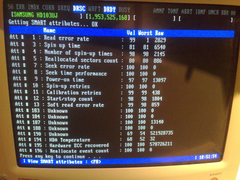

I am trying to repair my drive using MHDD and have a few questions.
I have just installed W7 on the drive and the W7 format did not discover any errors but it is now reporting disk errors. Chkdsk gets to stage 4 with no error but then says The disk does not have enough space to replace bad clusters detected in file 58187 of name . ( the disk has 900 GB free?)
I'd like to save the 2 days it has taken to do my W7 install, apps and updates.
    Some posts on this forum say MHDD does not work with Samsung drives - is this true?
    I have tried to run MHDD and turned remap on - its been running 24 hrs and I thought it was going to finish a few minutes ago but seems to have restarted - did it do a scan and is now remapping?
These are the results shown
x=233
!=173
s=174
a=
0=173
*=173
After the second pass finishes what should I do? ( it is going much quicker 50% after 80 minutes)

The disk was in my media centre for 3 years and then about a month after its warranty ran out the disk crashed. I was thinking of upgrading anyway so put a 2Tb disk in and thought I'd see what can be done with this one. I suspected a faulty head and the disk was going to be unusable.
I wanted to try Windows 7 but didn't want to be left with out my media centre if the 5 year PC couldn't cope with W7. So tried installing on the old disk and ran through the default install. Thinking about it the format was too quick to be a proper format which is why no errors were found I guess. W7 installed and everything seemed fine until I started giving the disk some work to do - copying over 200 Gb, then it started failing.
I have a attached a photo of the Mhdd Smart screen

Thanks for the info.
Since the disk had a problem in the media centre, it should be no surprise that you're having a problem with the disk elsewhere. As always, don't try to troubleshoot just the situation now, look at the history too :)
A quick format on Win7 does minimal testing, so yes, that's why I was asking and so it's also no surprise that no errors were detected at that stage.
Although I would have expected a couple more SMART attributes to be shown after you pressed a key, that screenshot contains SMART attribute 5 which shows 886 reallocated sectors - so the disk is clearly faulty.
See the earlier comment from BlackST about professional refurbishing, or just buy a new disk.
