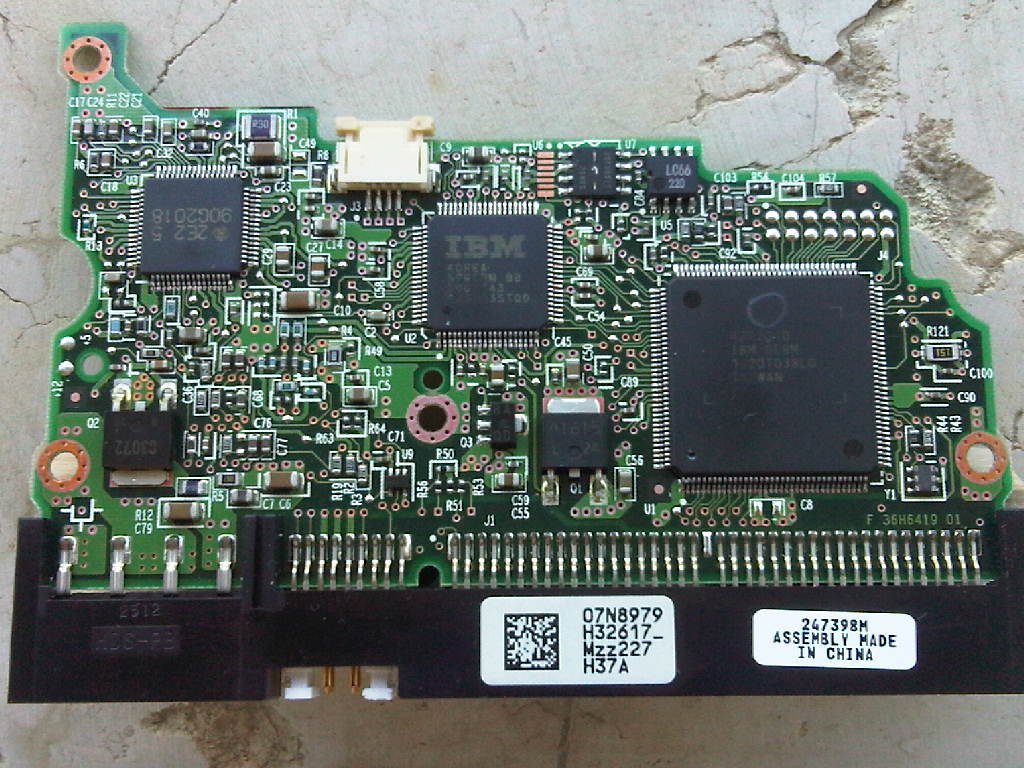

I have two almost identical of these drives.
They only differs in what looks like to be the firmware version:
the bad one is MLC69005 (its motor doesn't spin up anymore) with P/N 07N9679
the good one is MLC68883 with P/N 07N8450
on the boards them self, the motor driver is for both 90G2018 but on the good board it is "2C3 5" while on the bad one it is "2E2 5"
Swapping the boards makes the motor to spin up, but the head makes just and only one click.
Now what is the best practice to do in such situation?
Naturally I'd like to copy the data.
I'm in touch with a micro-electronic laboratory and they can do a good job swapping ICs (if this can make sense)... yes... but which IC?
Would you swap the motor controller on the defective board or the firmware IC on the good board?
Looking at the picture, the first on the left is the motor controller (right?).
Can you kindly tell me which of the remaining two is the chip with the firmware?
Thank you for any help and tip.
Robert

No need to touch any of the big ones. If ur boards are same - u need to take ROM from position U6 of ur dead drive , soldier it on a good PCB , and put that PCB on the dead drive. Should work unless there is preamplifier damage , in that case u are in for some spending. Note , dead preamplifier can cause havoc with ur drive. Kill ur donor PCB as well.

Location: Italy
Thank you Alexii for the answer
You mean not the LC66, but the low profile one to its left right?
Only 8 pins, correct?
Thank you for the clarification.
Robert
 Post subject: Re: Kind info please, two identical IBM IC35L040AVVN07-0
PostPosted: September 1st, 2010, 14:14
Posts: 775
Location: Toronto
Robert
That is correct m8.

On the new HDDs what can be called FW is actually writen on the platters of the drive. Some limited ammount of adaptive info is ether embeded in MCU ( ur biggest chip on the PCB ) or some drives ( like ur IBM ) hold it in eeproms ( like urs at the position U6 )

You need to transfer the NVRAM IC at U5 (LC66), not U6.
On your board the contents of U6 are internal to the MCU (the largest chip).
