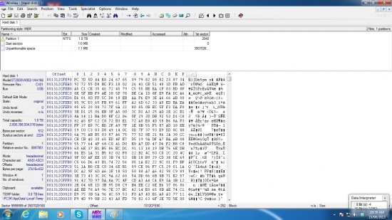

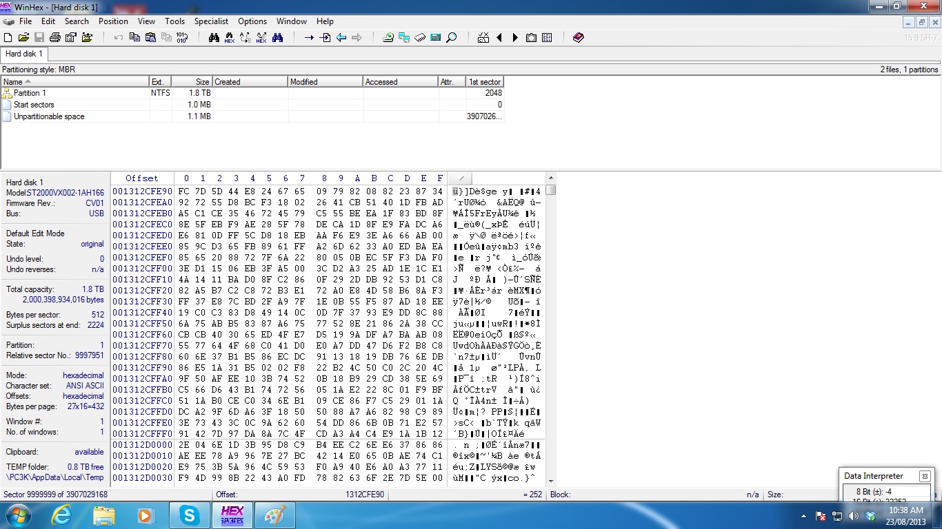

Joined: March 24th, 2011, 0:18
Posts: 182
Here is a screenshot.

 Post subject: Re: Seagte 2TB with scrambled data
PostPosted: August 23rd, 2013, 16:08
Posts: 17317
This sector is in the data area. Instead I would go to the very last sector and work backwards. Look for sectors containing a repeating pattern of 16 bytes.
