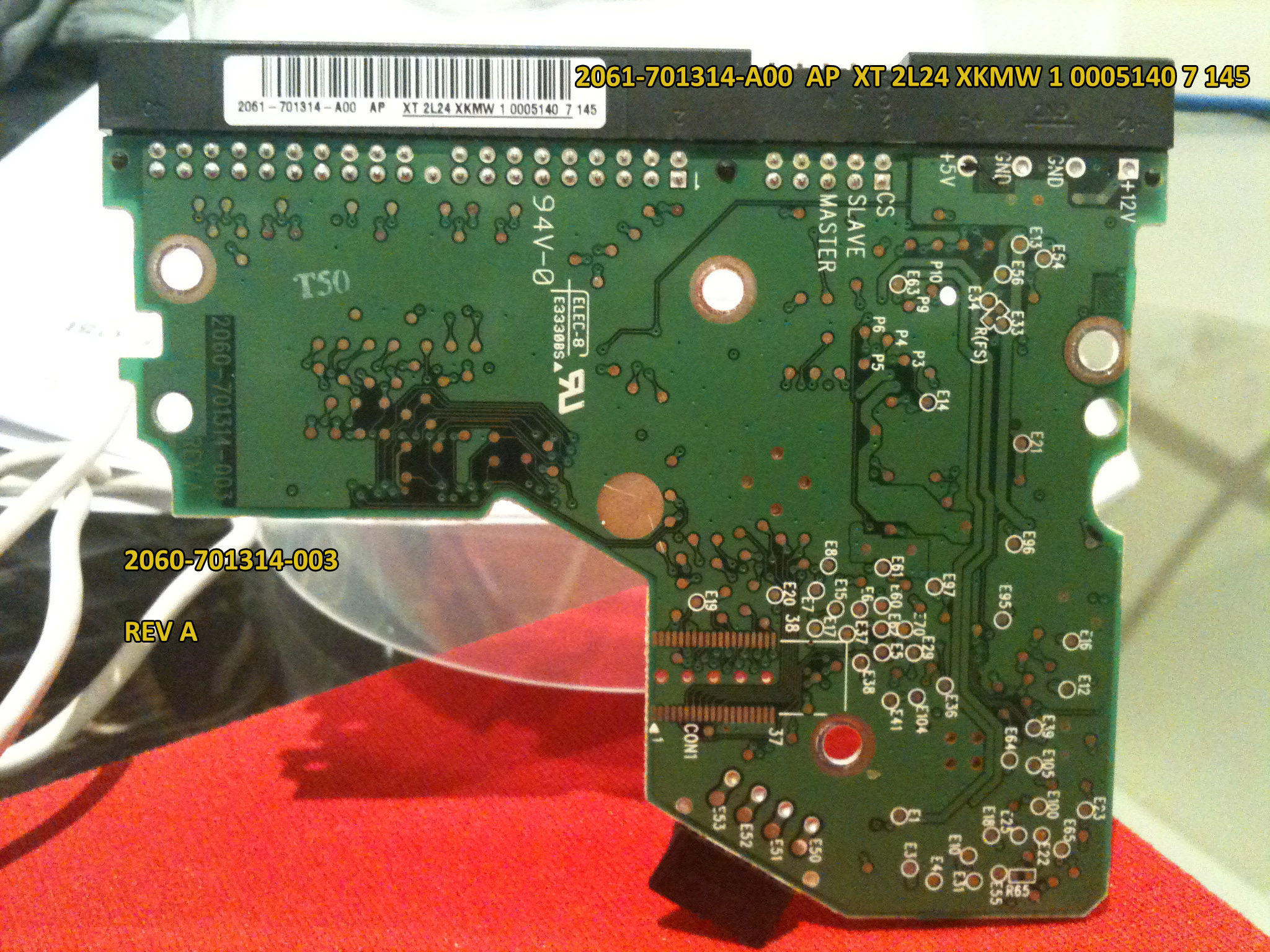

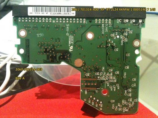

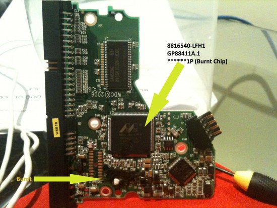

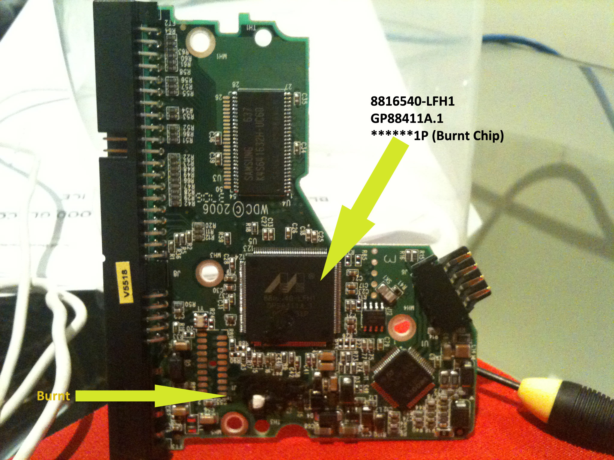

My HDD stopped working months ago and ive finally got around to doing something about it. It was analysed as
"We have completed our examination of the faulty WD 320GB you delivered to us. We have confirmed that the PCB (Printed Circuit Board) of the hard disk is damaged. The hard disk does not power up. This is a difficult problem to fix in order to recover your files."
Due to a recent car accident (wife! zzz) I'm stripped of sums of cash and read online that if i were to find a PCB it would be an easy replace. I contacted HDD zone with the below info
"I have attached 2 pics of my PCB that is burnt out.
There are a bunch of burnt chips so some numbers are unreadable and are indicated as **** on the photos.
My HDD is a 320GB WD
MDL: WD3200JB-00KFA0
DCM: HHCACAJAHN"
This was my response from HDDzone (even though I found the same coded PCB online on their store for $40)
I checked the pictues. So sorry to say that the PCB should exchange the Main Controller IC. However, your Main Controller IC is damaged. To swap the PCB can't help you get back the data.
This operation need professional tools. After the recovery company swap the PCB, they will rewrite your Main Controller IC information to the donor Main Controller IC. You can ask help from http://forum.hddguru.com/. Maybe you can find a cheap price to recover your data.
Now he is far more experienced than I and he referred me to this site so I do believe him, I was more after an explanation of my current situation...
The Main CIC (as seen in pics) is a bit fried. Therefore does this mean quite a bit of work has to be done to recover the stuff off it to put on the replacement MCIC?
If I were to get the PCB does anyone know a good place to get this fixed/recovered?
Payam seem good and they have great service (they analysed it) however $500 was more than I was expecting for a PCB. Now there are complications.. is this quite a valid price?
Cheers for any input,
Glenn

I don't think that Marvell chip is the one holding the critical info on this board. I would search around this forum some more looking at similar model drives, you should find your answer if you dig enough and my theory is correct. Also assuming that the electrical issues didn't harm any of the drive internals either.

The serial EEPROM chip at U12 stores the "adaptive" data, not the Marvell MCU.
The following vendor will supply your board and transfer your firmware. Otherwise your local TV/AV repair shop should be able to transplant the serial EEPROM chip for you.
http://www.hdd-parts.com/firmware-transfer.html
http://www.hdd-parts.com/10021173.html

I contacted HDD-parts and they have the part. Its about $69 and that includes the firmware transfer as well as free shipment back to me in AUS!
My understanding is that is going to fix my little issue, as I assume the firmware transfer fixes my issue stated regarding the controller IC stated in my OP??
Could anyone verify im on the right track before I sent it off to canada!!?
 Post subject: Re: WD3200JB - Info plz RE: PCB + Main cont. IC?
PostPosted: October 26th, 2010, 14:35
Nobody can tell as - for example - it is unknown if there is further damage to drive internals. So it may work or not. I am a service tech , not a clairvoyant who can tell and make love potions just seeing a picture....
P.S. sometimes data in the MCU gets corrupted but in a manner that won't prevent drive to start even if it won't work, if you "move" the problem ... you have a "working" pcb with "problems" :D
PostPosted: October 26th, 2010, 15:48
Posts: 17232
Yes, go for it.
