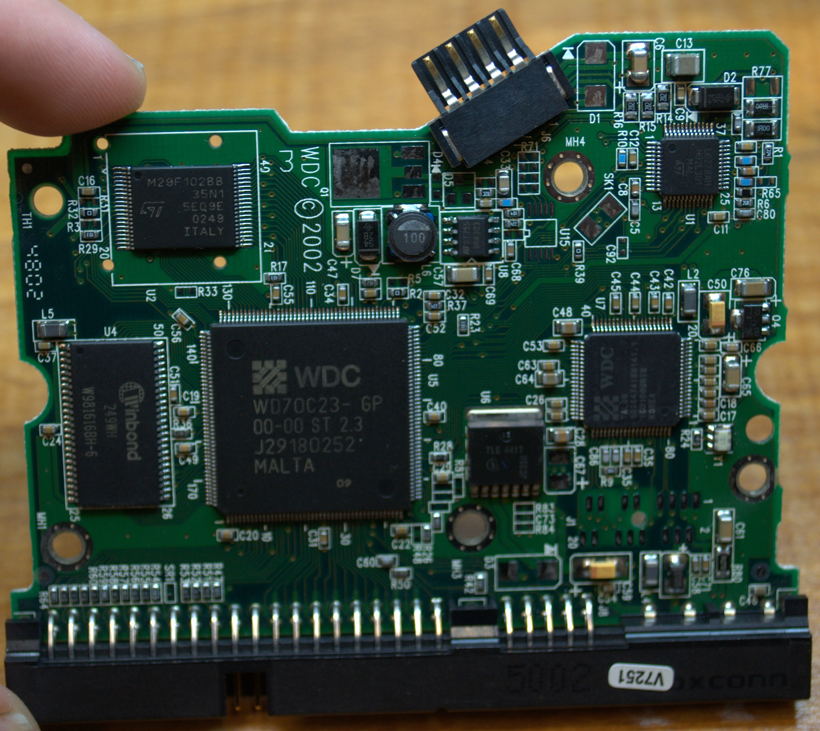

Can somebody confirm rom in U8 i am not sure from WD2000 caviar Eagle

If your looking for the ROM chip, U8 is not a ROM chip.
It looks like the board in the picture doesn't have a ROM chip.

ROM is 40 pin chip at U2
Thanx, my second suspect was on that one.

See my database:
http://www.users.on.net/~fzabkar/HDD/HD ... Flash.html
28Fnnn, 29Fnnn, 25Fnnn are flash memory part numbers
