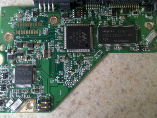

To this end, could you upload a photo of the component side of the board?

The good news is that your board has a discrete serial flash memory chip at U12. If you are unable to fix your board, then this chip will need to be transferred to your donor. Some board suppliers offer such a service for US$10.
That said, I would first set your multimeter on the 200 ohms range and measure the resistances of components D4, D3, R67, and R64 near the SATA power connector:
http://www.users.on.net/~fzabkar/HDD/bi ... diodes.jpg

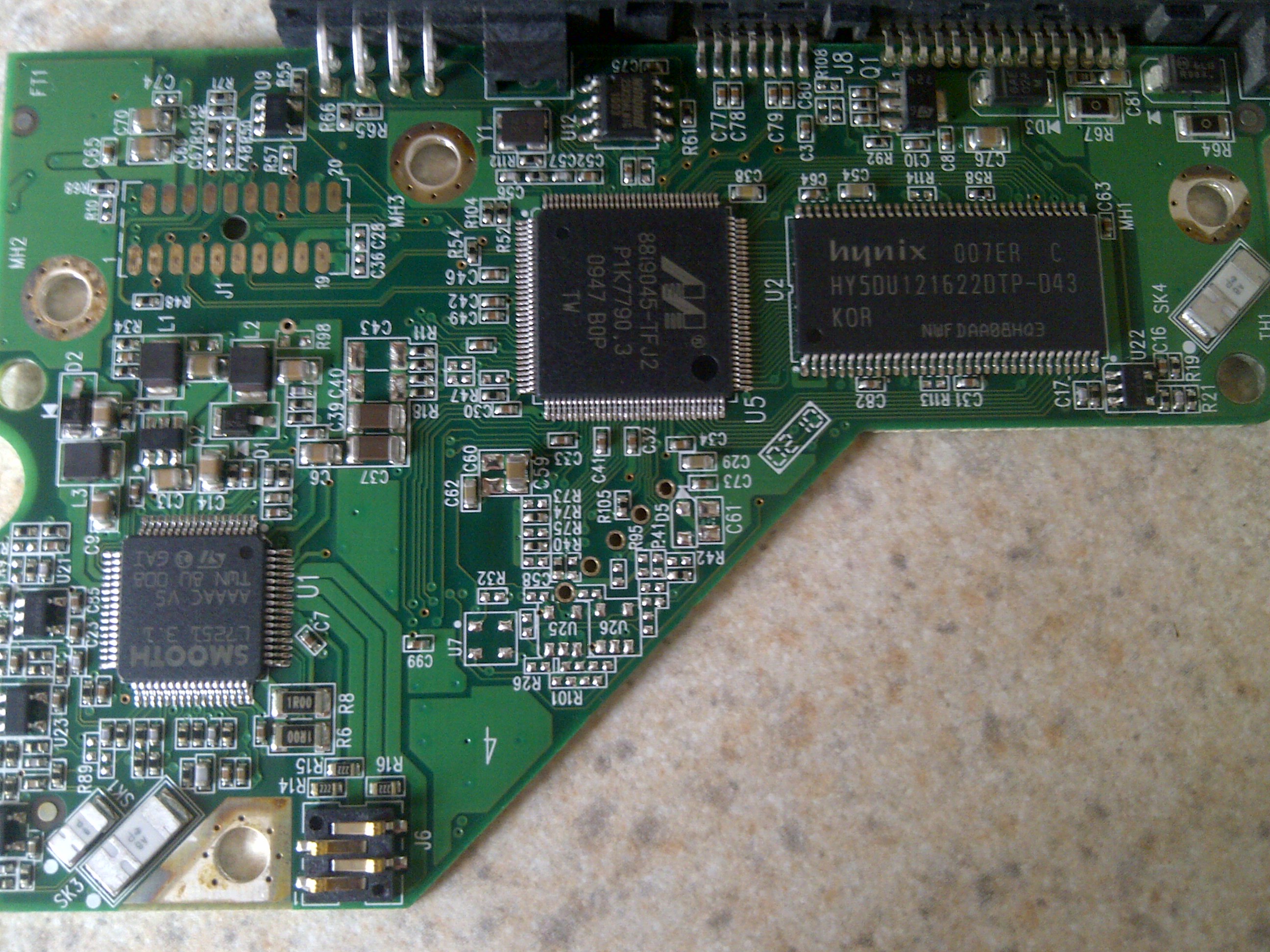

This drive was provided to me with an extra PCB. The other PCB does not spin up the drive either. Also, the extra PCB always shows there is nothing connected in the BIOS, under any configuration previously discussed.

I covered the contacts at J1 on both boards. Neither spun the drive up.
I did notice a change with the extra board in the BIOS, instead of reporting nothing connected, it now showed blank. This is the same result I received initially with the original board.

My apologies. Here are my findings.
Original Board
L1 1.1v
L2 2.5v
J1
Pin 2 nil
Pin 4 .1mv
Pin 6 5.2v
U12 .5mv
J6 2.2k and 4.4k
Extra Board
L1 1.1v
L2 2.5v
J1
Pin 2 385mv
Pin 4 .1mv
Pin 6 5.2v
U12 .3mv
J6 2.2k, 3.3k, 1k
Additionally, I visually inspected the pins on the HDA which are ok.
If you think there is more we can try, I would be more than happy to continue. Otherwise, I will take jono-ats's advice and contact DRC.

Thanks very much for the feedback. I'm not a data recovery professional, and I don't have access to failed boards, so I have to work from photographs and feedback from end users.
L1 appears to be part of the Vcore supply (= 1.1V) for the MCU.
L2 is part of a second Vio voltage regulator, let's call it Vio2 (= 2.5V). It supplies the SDRAM chip.
Your result for U12 make me wonder whether you measured the correct pin. Pin 8 is at the top right corner of the chip in your photo. Pin 1 is adjacent to the dot, and the pins are numbered counterclockwise, down the left side and then up the right side. This chip requires a 3.3V supply, let's call it Vio1. Vio1 is supplied by transistor Q1 below the SATA power connector. I would test for the presence of 3.3V at Q1. AIUI, the tab should measure +5V, and the two end pins should measure 3.9V and 3.3V.
Your results for J6 don't actually test the motor. You need to test the resistances at the terminals on the motor itself.
I don't understand why -5V is missing from J1. IIRC, this is sometimes not present even on a good board, so I'm wondering whether the MCU disables this voltage if it detects a fault. Also, I previously theorised in another thread that some models may test for the presence of a working preamp. From jono's response, it appears that this is indeed what is happening, and this would also explain why neither board was able to spin up the drive when J1 was isolated.
In short, my approach would be to test for the presence of +3.3V at U12, and confirm the resistances at the motor terminals. If these are OK, then I can't see that there would be anything more you could do. Check my PM.

The measurements from the motor were 1.7 and 2.7. I double checked U12 at the correct pin 8 and received 2.5v. I checked Q1 and the voltages were exactly what you stated. 3.3v, 3.9v, and 5v.
 Post subject: Re: WD5002AAEX Doesn't spin up
PostPosted: December 15th, 2011, 18:24
Posts: 17386
Thanks again. Clearly U12 is a 2.5V part, like the SDRAM, not 3.3V, so that's OK. I couldn't see the markings on the chip, so I couldn't be certain.
Vio1 (= +3.3V) must be used internally by the Marvell MCU, so that's OK, too.
The motor windings also check out, so AFAICS your DIY efforts have come to an end. :-(
