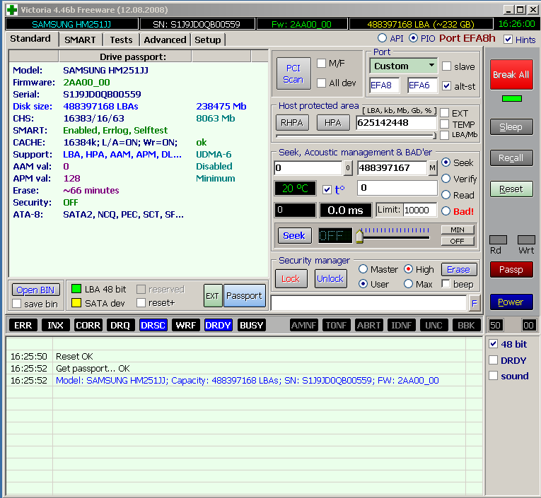

Ok...I was thinking of bad heads too but can a hdd with bad heads ID ok in victoria for example?...Here is how it ID's after soft reset...
So it looks like it can read al least something from SA....
