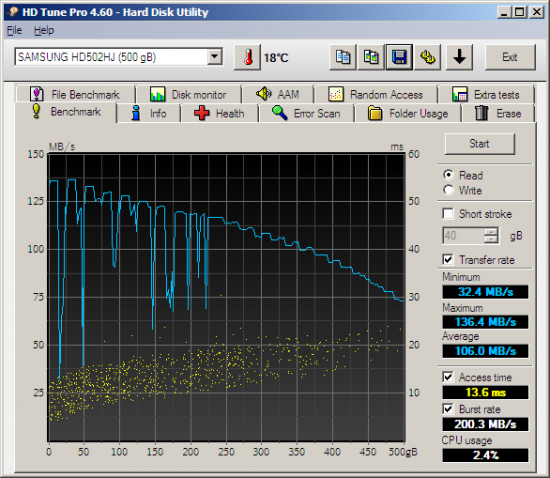

In 20 years I bought 7 or 8 hdd, from 80 MB to 40 GB. Never had a problem.
In late 2008 I built a new computer, I chose a Samsung F1 320 GB. In late 2009, I found out it had some bad sectors.
In february 2010, I bought a Seagate 7200.12 500 GB to replace the Samsung. Some months later, just because I was curious, I checked the SMART data and found out the reallocated sector count value was in yellow. Since I knew software sometimes don't know exactly how to interpret SMART data I wasn't very worried. Moreover I scanned the drive with hd tune pro which found no bad sector. But in october 2010, I got a SMART error message at the boot telling me the drive was going to fail. CrystalDiskInfo and Speedfan reported the reallocated sector count reached the error level. Again no bad sector according to hd tune or chkdsk. I sent it to the after sale service.
In november 2010 I bought a Samsung F3 500 GB to replace the dying Seagate. But in january 2011 I had a weird issue: Many files were corrupted (exe, dll, jpg,...). Files were not gone but the bytes were corruped. Not zeroed but something like random or compressed data. Chkdsk fixed some orphaned files and other errors. It may look like a virus but I have an AV running in background, also did a full scan and it found nothing. I checked the running tasks, the executables ran at startup, the services,...: nothing suspect. Moreover the modification time of the corrupted file were not changed. I thought it may be again the HDD but SMART is ok and hd tune reported no bad block. Finally I replaced the corrupted files (identified thanks to sfc /scannow) from the original windows dvd. I really didn't understand the problem, but well, disk crashes happen sometimes. One month later, it happened again but this time I couldn't even boot! Not a surprise: with the help of the recovery console and an hex editor I found out that something like 100 system files were corrupted! Again I manually restored them (what a painful task!) Then, again, I scanned it with hd tune: no bad block. Since I was using it, I launched the benchmark test and saw the curve was weird:

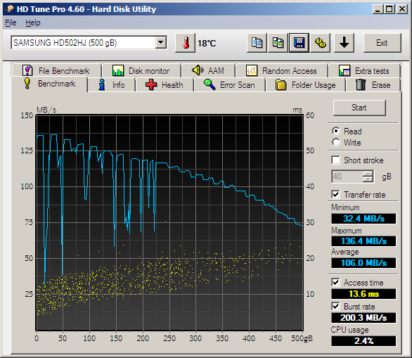

I redid a surface scan and saw the scanning speed decreases (down to 60 MB/s) while readind some blocks. ESTool by Samsung reports no error but I can see the progress bar slows down sometimes and hear the head making noise on some sectors. HDAT2 reported no error (but I saw some slowdowns during the scan). I tried MHDD but it didn't detect the drive.
So my questions:
- What does mean these slowdowns during the scan but with no error? Are some sectors "weak" but still readable after some retries? And maybe sometimes the drive doesn't correctly read or write these sectors and makes some files corrupted?
- The most important question: Why my drive are always get damaged !?
In a bit more than 12 months, three drives damaged (Samsung F1: bad sector, Seagate: reallocated sector count, Samsung F3: slowdowns during the scan and data corruption) For me it's hard to believe it's just a coincidence.
My box is an Antec P182 so the drive is at the bottom, near the PSU. Is it possible that the magnetic field generated by the PSU damages the plate of the HDD? The PSU is a Corsair 520HX, on a Seasonic base, then it's supposed to be a good PSU.
In the P182 the drives are in a vertical position, not horizontal. Could it be the cause?
It could be electric surges generated by the PSU or the motherboard but I suppose it should damage the PCB, not the plate, am I right?
By the way I never move the box and the drives are never too hot.
Can it be really a coincidence?
More generally, what is the cause for bad sectors? Magnetic defaults on the plate or the head that hit it?
Thank you for your help in advance
Yes, that's possible.
It would be useful to see similar benchmark graphs from your previous "problem" disks, but you don't mention that they are available. It would also be a good idea for you to repeat this test several times on the current disk, and see whether the "dips" in the benchmark graph occur at the same parts of the disk each time, to confirm the disk as the likely cause of those "dips".
It is interesting (but inconclusive at this stage), that the dips in the benchmark graphic which you included, are all towards the outside (OD) of the drive. Again, it would be good to compare this pattern with other "problem" drives.
It would also be a good idea to watch for changes over time in that benchmark graph and in the SMART data, so you should be collecting and keeping those results frequently from now onwards, for later analysis.

ISTM that the dips in HD Tune's read benchmark graph are probably consistent with the slowdowns in ESTool and HDAT2. To confirm this with MHDD, you need to temporarily reconfigure your SATA controller for IDE, legacy, or compatibility mode in your BIOS setup.
I'm sure the Samsung F1 HD322HJ 320 GB, the Seagate ST3500418AS 500 GB, the Samsung F3 HD502HJ 500 GB had normal benchmark / surface scan when I installed them in the computer.
I still have the F1 somewhere (not in the PC). I don't remember if I benchmarked it after the issue appeared but the curve had very probably the dips because it had bad blocks (red in hd tune) and I could see the test slowing down a lot when on the bad blocks. I name hd tune but I tested other tools and results were similar.
About the Seagate, I don't remember if I benchmarked it. I only remember surface scans reported no bad block. No data corruption/crash either. The SMART reallocated sector count was the only issue. I don't have it yet, I gave it back to the store where I bought it and they sent it to Seagate. After more than 2 months with no news from Seagate they accepted to replace it by a Western Digital Caviar Blue. It's my current drive.
As explained above my current system disk is a WD. But my latest problem disk, the Samsung F3 HD502HJ is still in the box. The results are consistent, the dips are always at the same part, like the capture I posted in my first post.
The bad blocks on the Samsung F1 were in the same zone: In my sytem partition (50 GB), 2 groups of bad blocks.
I took some copies of the benchmark result and of the SMART data for the WD I currently use.

Well I used sfc /verifyonly because it's an easy way to identify corrupted system files because windows knows the original hashes. For other files files it's less easy. I know that 2 or 3 jpegs in my pictures folder were damaged, that one day I tried to launch an audio editor but 3 or 4 files were damaged (exe, dll...). And one part of a big thunderbird file containing my emails. Unless I open and verify all my files, documents, softwares, it's not easy to find out what is corrupted. Same thing for my data partition: it mostly contain music, videos, ISOs. And copies on my previous damages disks lol. I found no corrupted file on this data partition but I didn't have the patience to watch all the videos...

If I'm understanding your descriptions correctly, I suspect there may be 2 problem behaviours - something affecting your disks causing difficult-to-read blocks, and something affecting another part of your system (RAM? CPU?) causing corruption of the MFT and/or Registry. I reach this conclusion because it is highly unlikely for multiple disks to return so much corrupt data. If we assume (and, of course this is an assumption), that there is one cause (i.e. something common to both sets of effects), then as Dave48838 says, the PSU must be on the list of suspects.
For example, a faulty CPU could not cause difficult-to-read sectors on a disk; nor could faulty RAM or SATA interface etc. cause that. However, poor quality power (dips, ripple etc. etc.) to the internal electronics can cause RAM corruption (which affects the MFT, as that is held in memory) and also affect the disk drive(s).
Of course there are other possibilities (including the possibility that there are multiple faults), but I return to the fact that in my experience, large amounts of data corruption are almost always not caused by the disks. Therefore I suspect that the disks may be victims, not cause, here.
FYI, for the recent Samsung F3 500GB SMART data - I see no obvious evidence of a disk drive fault. Yet the graph shows that there are clearly parts of the disk which are difficult to read (i.e. slow) - this might be because those sectors were somehow "badly" written and are now difficult to read, and not a disk fault at all. Since you've explained that you don't use the whole disk, that explains why the problems are in the OD (lower LBAs).
However, you said that you don't want to get a new PSU (even to eliminate that as a possible cause), even though you agree that your specific PSU might have a problem. Please remember that I told you this type of investigation may need your time & money. By choosing not to spend some money, then you may delay (or prevent) a successful investigation.
I can think of several possible test approaches, depending on availability of other PCs for you to use as test beds - other members might suggest tests too. In any case, I would run some long-term RAM & CPU tests on your current PC - successful tests tell us nothing (they do not actually mean that there is no problem); however a failure would confirm that there may be something affecting the RAM / CPU on that PC (which would then potentially explain the Registry / MFT corruption). That cause might be discovered to be the PSU, or something else.
The first thing that would help you to make progress, IMHO, is to find a failing test.
Another approach would be to confirm "slow" sectors on the Samsung F1 disk (I suggest that disk, so you don't affect the test case of the Samsung F3 disk), then write to all sectors on the Samsung F1 disk in another PC (of course there is the assumption that another system will not have the same problem as yours).
Then do lots of reading (only!) of that disk in your current system. Does it read normally (fast - no dips in the benchmark graph) in your current PC, after being written completely in a different PC, and also when used for read (only!) tests for months in your current PC? If so, then the likely conclusion is that disk has no problem - it was the victim of sectors that were written badly, when it was written in your current system in 2009.
Of course it would be possible to spend time thinking of many other tests, depending on what you have the time & money to do, but I hope those suggestions give you some ideas.

Since my last post I haven't worked a lot on the issue. So just some additional informations:
- As I expected, other people owning the same box + PSU + HDD in vertical position confirm they have NO issue
- No problem so far on my new HDD (WD blue), according to hd tune pro. No slow sector, unchanged SMART data
- Already did some stress tests (occt and memtest86), nothing wrong on the cpu/ram. By the way, it's not overclocked.
- The F3 that is still in the box (but in idle mode) is unchanged. Same slow sectors. Not more, not less.
- Unfortunatly the only other PC I have at home is IDE only. Of course I know some people with SATA controllers but I can't ask them to use their computers to do the tests.
One question to Vulcan: You say the sectors are slow because they were badly written. Does it mean I could "fix" them by writting to them (or formating)?

Bernd wrote:
Thanks again to Vulcan and other hddguru members who took the time to reply to me.
And thanks for this update. :) Replies below...
Understood - however that does not mean that your specific PSU is working (or has always worked) correctly; it just means that there is no known generic issue with that combination of components.
In one way, that's good news - but in another way, the lack of further problems means that you've not got a "failing test", as I mentioned in my earlier reply, and hence we can't make confident conclusions from this current "no problems" situation about what may have caused the previous problem(s).
One thing I would suggest as a possibility comes back to power - you now have a different disk drive (with different, perhaps slightly lower(?), power requirements), which is apparently working OK. If this "no problem" situation with that disk drive, continues for long enough that you are sure the system is now working better than (for example) when the Samsung F3 was being used, then consider testing what happens if you use that Samsung drive instead again (after re-writing it all - see below)?
Understood - although my comments above regarding unchanged SMART data, apply here too. Lack of errors during testing, does not prove that not problem exists, and does not prove that different tests would also pass.
Interesting. This suggests that the sectors are not deteriorating due to something in the environment (e.g. magnetic field), and that they may have been written in a way that made them difficult to read, due to an unknown (e.g. power(?)) problem at that specific time.
Understood - perhaps you could buy a little PCI SATA interface card? However, again, IMHO what would help most is for you to find a failing test. Therefore although using another PC (e.g. to re-write and then continuously read the Samsung F1 disk), may lead to a suggestion that the disk is not at fault, that's less conclusive than provoking the fault again - which may be easier for you to do on your "main" system, since you know that the problem has definitely been caused there in the past.
At the moment, this is my hypothesis, yes - but until the root cause is found, I can't say that this is definitely the reason. :)
If my hypothesis is correct, then yes. If you re-write all the slow sectors, or just re-write all the sectors (e.g. using any of the normal disk erasure techniques - but that does not mean all types of Windows formatting), and if the original (currently unknown) cause of the writing problem has been removed (use a different PC?) or is not triggered, and if (as we suspect) the disk itself is not faulty, then the re-written sectors should be readable as normal (i.e. fast) afterwards.
Hope that helps. Good luck, and please let us know when you have time to make any more progress. :)
