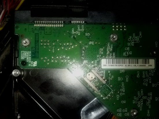

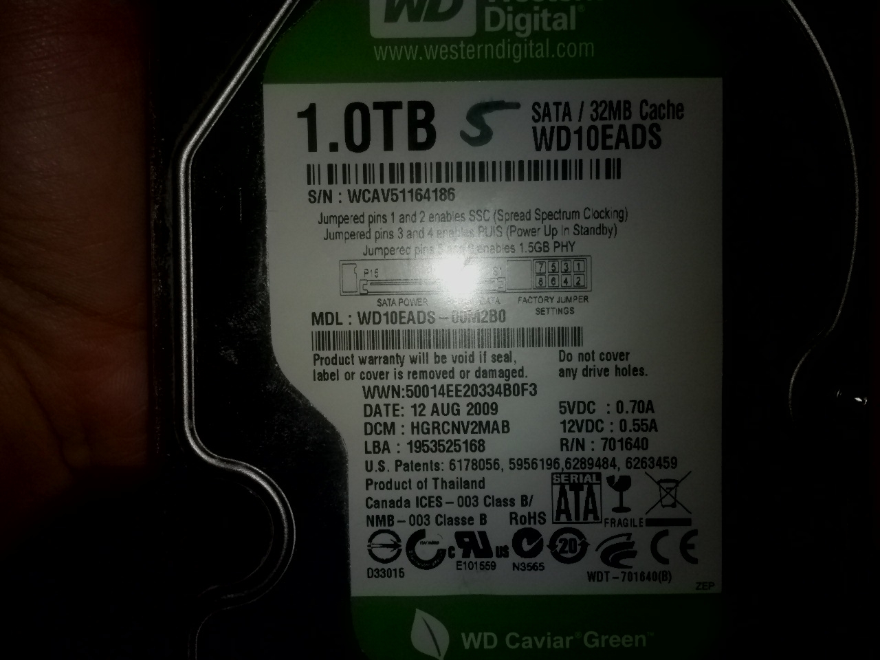

Hi Guys,
My hard drive seems to be failing on me. It went completely silent a day ago. The platters still spin up, but I am getting little to no sound from the drive. Plus, the data transfer rates have hit rock bottom. I have to wait ages to open a folder and I am getting only 100 kb/s in transferring or copying files. S.M.A.R.T status is giving me 0% fitness but 90% performance, which makes me think the PCB might be bad or the header is faulty.
I want to get this drive repaired WITHOUT losing the data, even if it is temporary, because I just want to be able to recover the data on it, which has taken me ages to accumulate and is extremely important. I live in Islamabad by the way, so a service that is within my reach would be more convenient.
The drive is a 1TB Western Digital Caviar Green with Model No. WD10EADS - 00M2B0.
Please take a look at the pics and contact me even if you know anyone who can fix it. Any help you can offer will be appreciated.

 Post subject: Re: WD10EADS - 00M2B0 failing? Urgent help needed.
PostPosted: December 7th, 2011, 14:32
More like it has bad/weak sectors and is dying.
Get the drive cloned with a NON-WINDOWS tool such as Media Tools Pro or dd_rescue before it fails completely, or better still take it to someone who has pro tools like Deepspar Disk Imager.
Then extract the data from the image.
PostPosted: December 7th, 2011, 15:36
Joined: May 6th, 2008, 22:53
Posts: 2138
@xstrike9999,
I think pcimage might have meant to say "bad/weak heads" (I hope he'll correct me if my guess is wrong :) ). These often cause slow reads, due to all the underlying error recovery & retries which are then being done.
xstrike9999 wrote:
I don't hear any clicking sounds characteristic of a bad header. Maybe the header placement is messed up?
Perhaps you means heads, and not "header"? The word "header" doesn't make sense in this context. As I said, weak heads can explain the slow reads.
xstrike9999 wrote:
Is there no way to diagnose the actual problem and get the drive repaired?
If you want correct diagnosis then yes, there is a way - send the drive to a suitable DR company, who have the necessary equipment, skills & experience.
