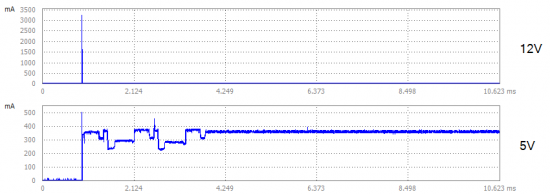

Hello
I'm quite new in the data recovery bussines (I'm using Atola products for some weeks)
I have costumer harddisk (WD3200BEVT-75ZCT2), which is not detected anymore (by Atola DiskSense)
The ERR status flag lits up 4 seconds after power-up
No visible burn marks on the PCB or on the foam pad
The customer told me:
His little son get hold of the laptop (or the harddisk) and seemed to be damaged afterwards, because
harddisk was still working but developed problems: Linux partition worked ok, Windows partition was damaged.
The customer performed a chkdsk /f /r via Windows Recovery DVD, but while chckdsk the harddisk stopped working.
During power-up the harddisk makes two quiet ticks. Spindle motor does not work

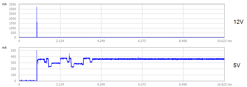

I have attached a graph of the voltages at power-up
The graph has eaxactly the same shape if the PCB is powered-up
without the platters case attached
My questions:
1) PCB dead ? - would a replacement PCB be a solution ? Is it worth a try ? (either success or would lead to Question 2)
2) Problems inside the harddisk requiring a clean room ? (would lead to Question 3)
3) Or: Tell the costumer that he has to send it to a data recovery company with clean room facilities
Michael (from Austria)
File comment: Voltages during power-up

http://atola.com/products/insight/video/oscilloscope/
Analyze your graph! Can use a multimeter to confirm the graph display.
Then search here on the forum via search function for "TVS".

This harddisk is a 2.5" harddisk with 5V only therefore there is no power consumption on 12V

Based on a brief analysis of your description of the sequence of events that the customer (and son) had encountered up to final failure, I believe there is nothing wrong with the PCB on your drive.
I would tend to say that the issue is internal, probably stiction. Do you hear a low noise buzz or hum coming from inside the drive. You can determine this by listening closely with your ear? I know you reference the "two ticks", but do the two ticks repeat without stopping while the drive is powered on?

Alright, sure. Now, I believe in my theory even stronger. I believe the damage is internally.
I'd still put my money on the pcb, but it could also be something internal. But I'd start with the pcb.

Also, when ONLY the PCB is connected and powered on, does it still do the "two ticks"?
