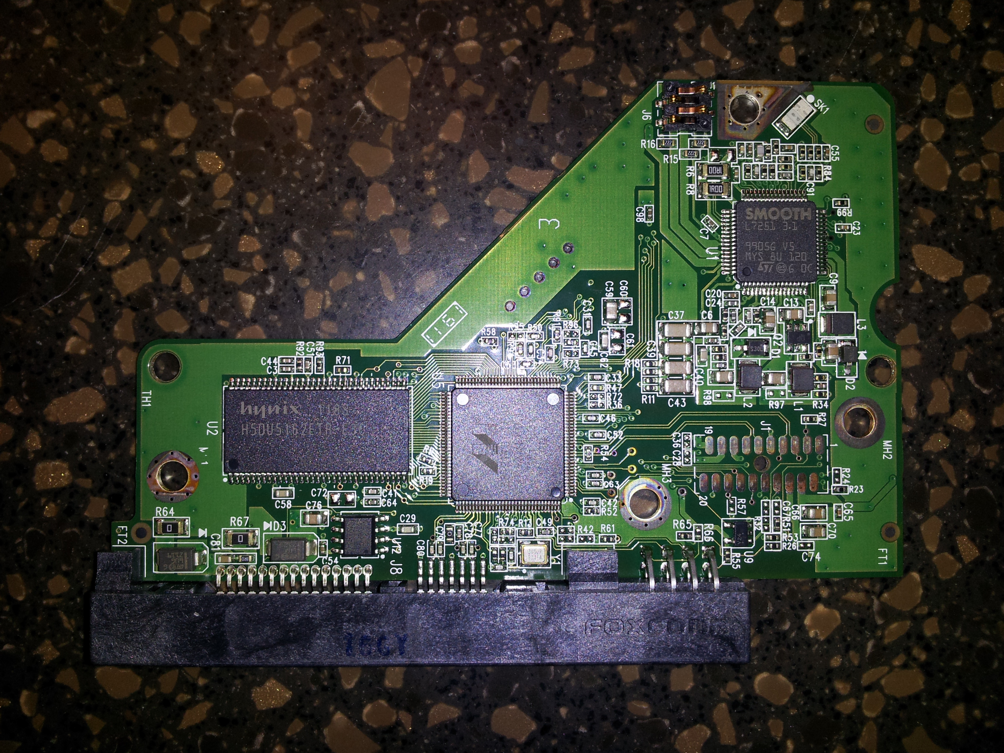

I have a Western Digital WD30EZRX that was inside of a My Book Essential external drive that stopped working awhile back. I took the drive out of the enclosure and tried hooking it up directly to my computer, but it still does not power up. I don't hear any noises, clicks, or anything. Looking at the controller PCB, I can't find any obvious signs of burnt components. I've contemplated replacing the controller PCB with an equivalent board (with the necessary bios chip swap) from an online company, but before I burn up $50 I'm hoping someone here can increase my confidence in such a swap. Is there any other testing I can do to confirm if the internals of the drive are bad? I'm handy with a multimeter, so if any probing/testing can be done I'm confident I can do that with a little direction on where and what to measure.

Can you upload a detailed photo of the component side of the PCB?

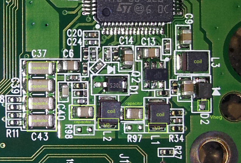

Measure the resistances of the following 4 components:
http://www.users.on.net/~fzabkar/HDD/bi ... diodes.jpg

R64 = 1.05 ohms
D4 = 205.7 kohms
R67 = 1.06 ohms
D3 = 238.6 kohms
Is it normal that it takes a bit for the resistance reading to stabilize for each component?
 Post subject: Re: WD30EZRX possibly dead, looking for repair options
PostPosted: March 23rd, 2014, 19:11
Posts: 17314
Your readings are OK, and yes, a little settling time is normal.

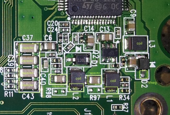

Could you now measure the voltages at V1, V2, and Vneg? These will be the Vcore and Vio supplies for the MCU, SDRAM, and EEPROM, plus the negative supply for the preamp.
You could also measure the voltages across the associated capacitors?

V1 = 1.1V (adjacent capacitor also 1.1V)
V2 = 2.6V (adjacent capacitor also 2.6V)
Vneg = .037V
Four capacitors on the left = 12V
I measured voltage across the capacitors, but used a bolt hole ring for ground probe when measuring V1, V2, and Vneg.

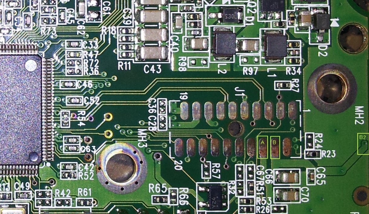

The negative supply is under the control of the Marvell MCU (the MCU switches it on and off), so it may be that the MCU is faulty. In another thread, the OP measured Vneg soon after the drive was powered up. He found that the voltage went to -5V and then dropped back to 0V after a short while. If you PCB does this, then this would suggest that the MCU is alive. To this end I would install the PCB on the drive and measure the voltage at the point marked "B2" on the other side of the board. I believe this is the Vneg supply, but I'm not certain. The points marked A and B would be the +5V and -5V supplies.
One other thing to do would be to clean the oxidisation from the J1 contacts by gently rubbing them with a soft white pencil eraser.
Still one more thing to investigate would be whether the drive is configured to Power Up In Standby (PUIS), but in this case it should still appear in your computer's BIOS, albeit with a blank model number.

I cleaned the contacts, reinstalled the board, and looked for a point marked B2, but the one that looks like its directly on the other side of the pad you marked in the picture was labeled E13. I put my negative lead on the hard drive chassis and the positive on this pad. After connecting the power I'm seeing a peak of about -2.5V that blips twice and then back to zero almost immediately. While I was testing it, I did notice something I hadn't before. When I plug in the power there is a very faint "tick, tick, tick" that happens twice, possibly in time with the voltages. It sounds like its coming from inside the drive and not from the board.
You marked points A and B, but I'm not sure what you want me to do with them. I tried finding their corresponding pads on the other side, but nothing marked seemed to line up. As far as the PUIS test, I haven't tried it yet but I assume it would have to be hooked up directly to the motherboard through a SATA port to possibly work? I've been using a USB universal hard drive adaptor (Apricorn Drivewire) to do all this testing.
