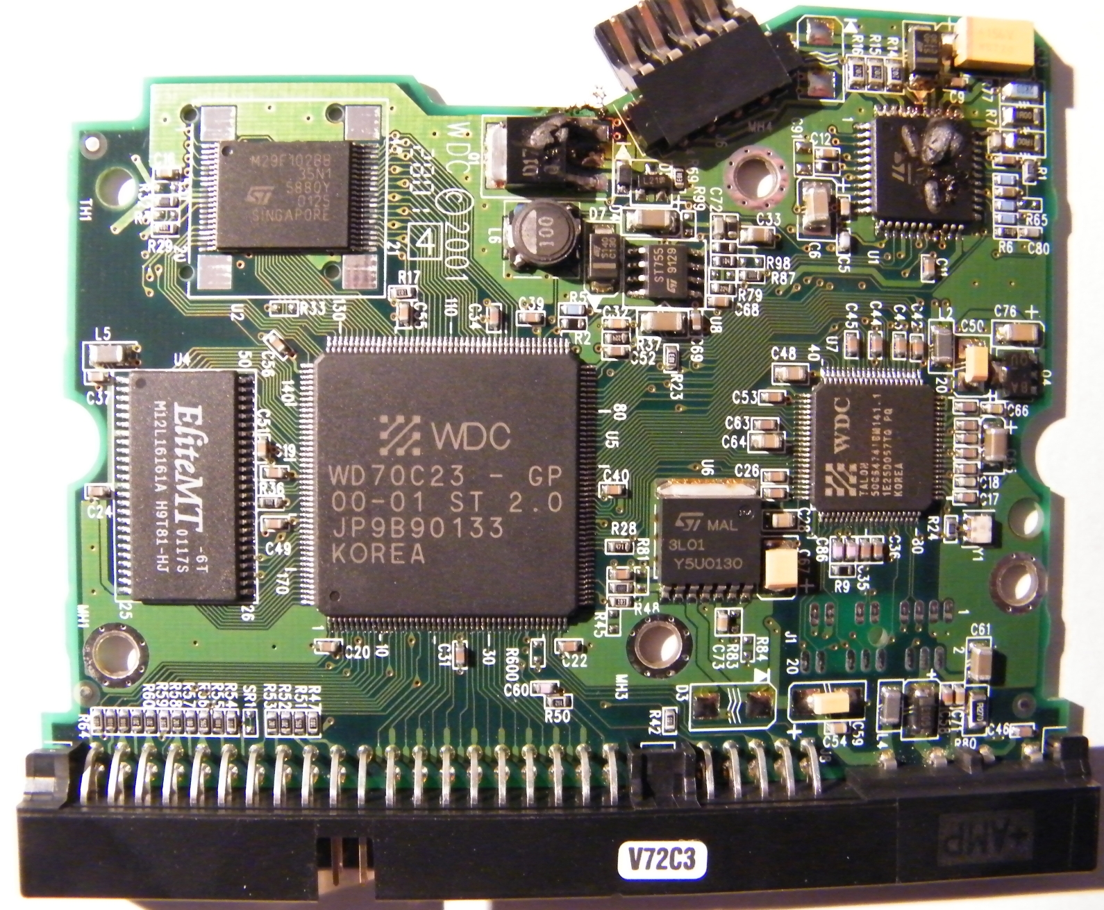

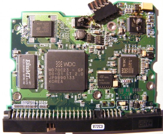

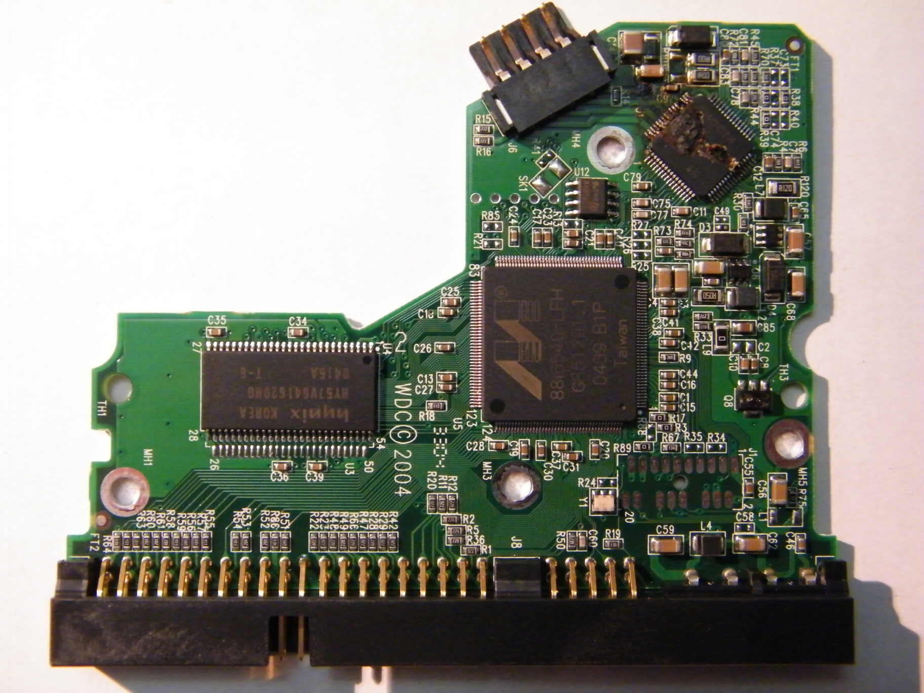

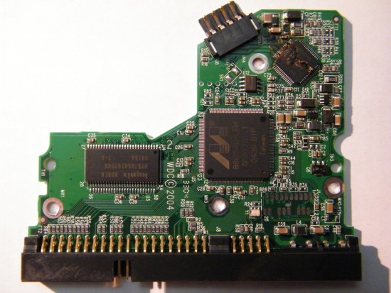

Hi everyone,
New user here. I'm a newbie at recovery. I have some basic knowledge in electronics as I studied electrical engineering for one year before switching to mechanical engineering.
So the two drives below come from my previous machine in which all components died when the PSU itself blew a cap for an unknown reason :( . They've been sitting there for 3 years, I knew someday I would do something about them. Today I was about to send the PCBs to have their firmware transferred on replacement boards, but I figured I might research more. Then I found a few threads that got me worried about the preamps :?
Drive #1 :
WD800JB-00JJA0. From the picture, U1 is burnt. What's on the IC body is molten/burnt foam from the protector foam pad. From my searching on this site, U1 would be the motor controller.
Drive #2 :
WD1000BB-00CCB0, U1 and Q1 are both burnt. Although I couldn't confirm this by searching the forum, my guess is U1 would be the motor controller here as well, judging from the traces that go to the motor contacts. As for Q1, I would guess it's a transistor but I have no idea of what it actually does.
My questions :?: :
1- What are the odds that the preamps on the heads might be dead? That would mean a PCB swap + ROM transfer using an identical PCB number would not be sufficient.
2- Is there any way to find out if the preamps are good, hopefully using a multimeter, or even an oscilloscope?

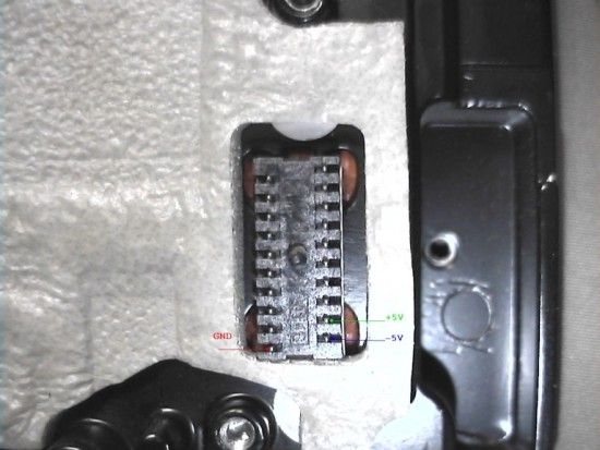

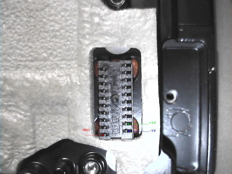

After researching more, I found a few posts about checking the preamp.
1- Pins to probe
I found the below picture in a thread on the WD800 over at a russian forum. The pinout in the picture seems to make sense if I refer to N.C.'s post from 2008, here.
Q: Anyone can please confirm the pinout in the pic?
2- Readings
As per pepe's 2007 post here, the negative lead to the -5V should read infinity, or else the preamp is dead.
Q1: What readings on the +5V pin are expected of a good or dead preamp?
Q2: Does it make any difference if I ground to the ground on the heads connector or to the chassis through a PCB screw hole, i.e. potential damage to the preamp or else?
Next I'm going to verify what current my DDM uses for diode measurement, after reading dobrevjetser's warning about measuring current and preamps here.
I'm learning a lot thanks to you guys and this great forum. Hopefully the preamps are gonna be ok and I can go ahead and buy the PCBs and finally retreive the data.
Thank you all very much in advance.

A typical DMM uses about 0.1mA on the 200 ohms range and 1mA on the diode test range. The open circuit voltages would be 0.5V and 3V, respectively.
In short, this widespread fear about preamp damage is misplaced, as was shown in that "Samsung" thread. It's just another urban legend that has taken root in the data recovery community. You just need to take the usual ESD precautions, as the heads are easily damaged by static discharge.
As for the preamp connector pinout, it looks correct to me. The supply rails are normally identifiable by the larger traces, as are the two voice coil traces at the other end. You can easily confirm the +5V and ground pins by testing for continuity with the Molex power connector. AFAICT, on the WD800JB board the -5V supply should come from the anode of diode D4, whereas on the WD1000BB board it appears to come from the anode of D7.
I notice that on the WD800JB PCB, the transistor at Q8 appears to be blistered. I believe Q8 is the pass transistor in a +3.3V linear regulator. If so, then you would have to be concerned about any device that is connected to this rail. Unfortunately this includes the flash memory at U12. To this end I would test for a short between ground and the emitter of Q8.

I don't know what to expect for your -5V and +5V resistance measurements. However, it's clear that there are no short circuits or excessively low resistances, so it looks good to me.
However, if the emitter of Q8 (which you have correctly identified) is shorted to ground, then this bodes ill for U12. I would confirm your result by measuring the resistance between pins 4 (Gnd) and 8 (Vcc) of U12.

Hi guys. I finally got the replacement WD1000BB board with the copied firmware, from HDD-parts.
I noticed the replacement board revision (-007) differed from the original (-006), and that the chip at Q1 was missing so I fired an email to HDD-parts, who responded that the boards were compatible.
So I screw the new PCB down to the drive, install and boot. The disk starts spinning and then after maybe 7-8 seconds, I start hearing 4 short clicks... then silence, then 4 short clicks again, then silence again. After a couple more clicks, I shut the machine down in fear that the drive was dying.
I searched and found the "Noise related to PCB in WD HDDs (Final Edition)" sticky, and now I'm worried :(
Should I try to boot again and see if it still clicks or would that just destroy the drive further?
