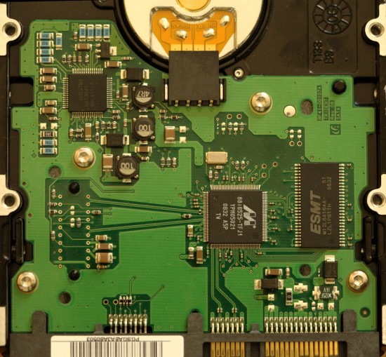

I have a problem with a Samsung HD400LJ. The drive does not spin up and I suspect the PCB after a power problem. Can I replace the PCB without firmware transfer? Does anyone have this in stock or know where I can get it? The PCB number is BF41-00107A.
kind Regards
Daniel
 Post subject: Re: Samsung HD400LJ PCB
PostPosted: September 15th, 2010, 4:51
Posts: 17238
Can you upload a detailed photo? Many times the problem is confined to the TVS diodes and fuses near the SATA power connector. Often the solution is an easy no-cost DIY.

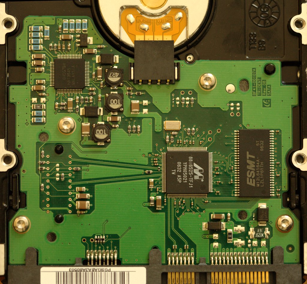

Sounds promising, I have uploaded a photo of the PCB.
File comment: PCB Samsung HD400LJ

Go to the next step - use your Ohm meter :D

Both diodes looks fine, I think it would be the Marvell chip or motor controller IC or something else.

Are we talking about the 2 diodes bottom right? Normally I get a quick blip on the meter whatever way I put it on, but these two are different. Putting a tester on these, the left had one is showing a short both ways and the right hand one seems open. Maybe this is the problem. But I am not sure what results to expect testing this in situ with a diode test on a multimeter.

remove the one shorted

Felt like I was choosing between the red and the blue pill for a moment, but I chopped it out of circuit and the drive just powered up with all my data. Thanks for your help. What a big saving of money!
guess I need to be Very careful with what PSU I connect now

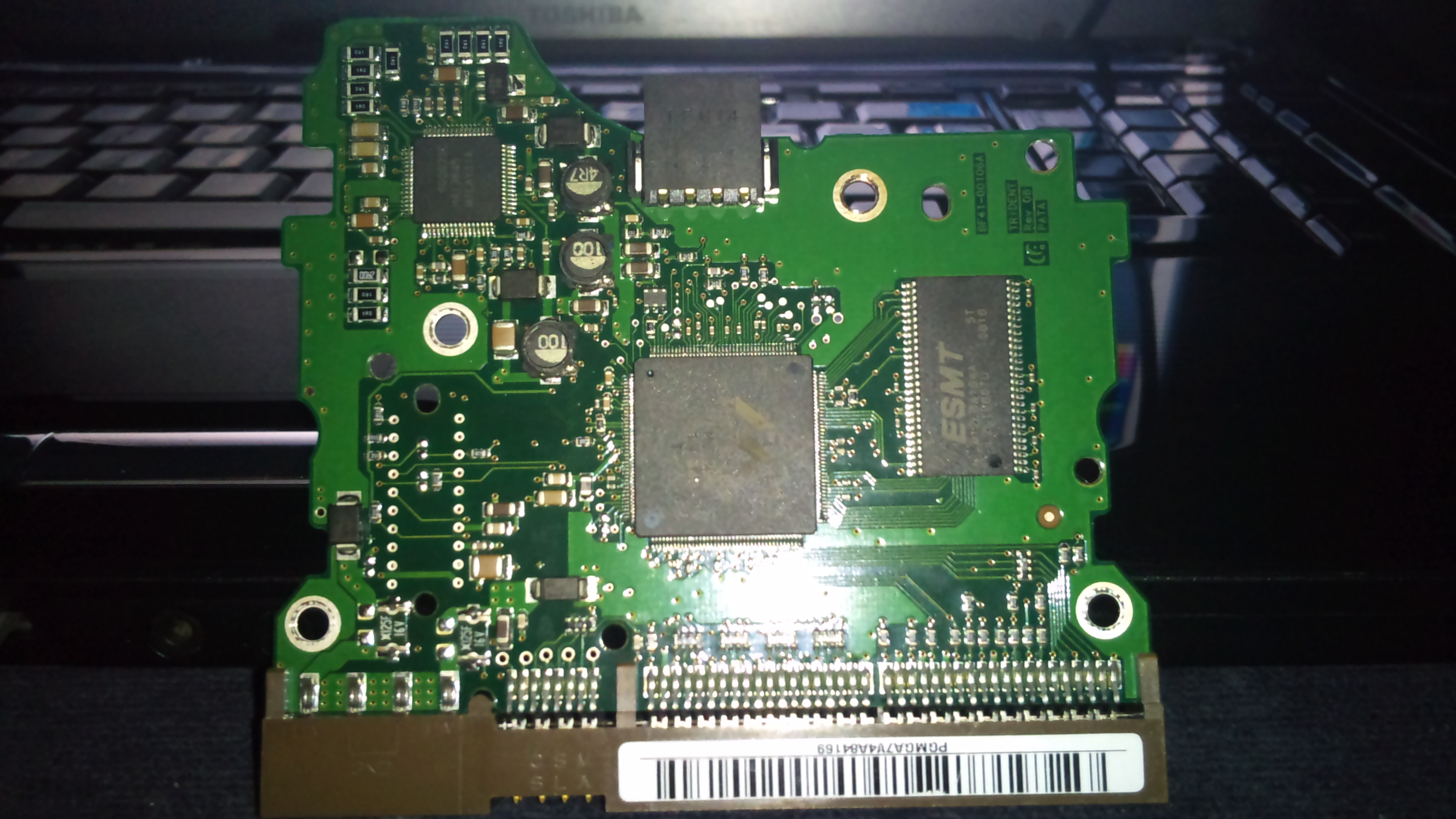

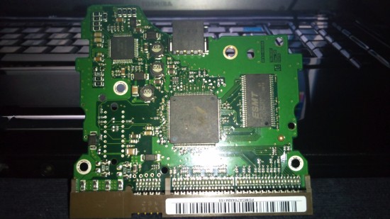

Can someone hell me ? The problem is mostly the same ( it doesn't start) and i think it was because a bad plug off.
I already tried another board and it worked Samsung HD300LD but i cant keep the good board so...

Measure the resistances of the labelled components on the 200 ohms range of a digital multimeter:
http://www.users.on.net/~fzabkar/HDD/HD ... switch.jpg

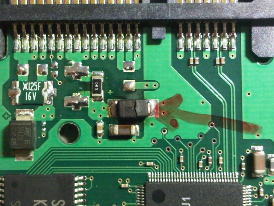

Hello, I was searching the internet for my particular issue and found this item about the Samsung hd400lj pcb bf41-00107a, I have the same pcb and my problem is that the larger black smd near the satapower connector is zapped/smoked, it looks like it has a number on it of 722, I am thinking this is a resistor but not sure. I have swapped pcbs to prove this is a defective one. There may be other issues, I just know this is smoked, you can see the crack on it. Any help would be appreciated or if someone knows where I can find a SD, that would work as well.
If you are referring to the 12V TVS diode, just snip it out with side cutters. This will remove the overvoltage protection from the +12V supply, so be absolutely certain your PSU is good.
BTW, the "722" marking appears to be a YWW (Year / Week) date code, ie week 22 of 2007.

Fzabkar, I am posting/attaching picture with arrow pointing to smd that has failed, is this what you are referring to?

That's the 5V TVS diode. Remove it and check that the 000 resistor measures 0 ohms. If it is open, bridge it with a wire link or a blob of solder. You could use the vacant spot to the left of it (with the "+" shaped pads) to solder your wire.
You may want to first check that there is no additional shorted component on the +5V supply by measuring the resistance between the diode's pads on the PCB after the diode is removed.
