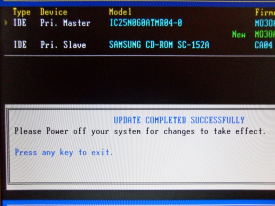

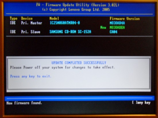

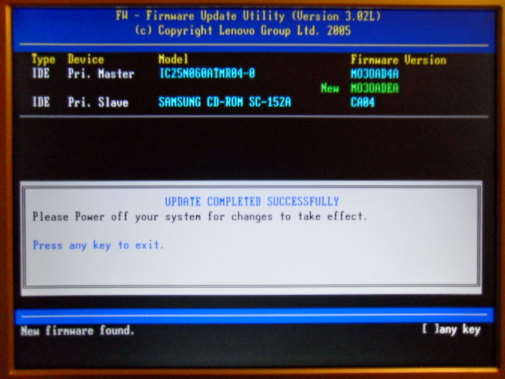

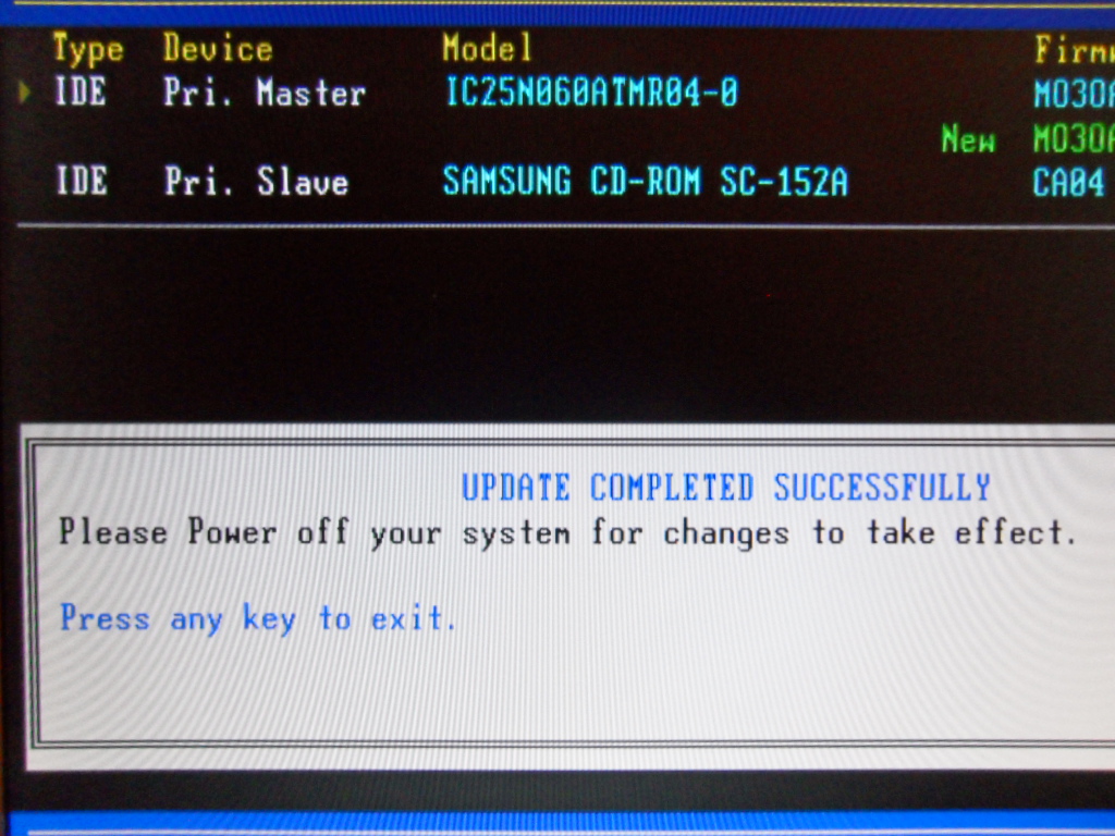

I found this piece of utility to do the firmware upgrade.
I downloaded the software and burnt it to a CD and booted from the CD.
The software detects the hard drive and indicates that there is a new firmware. So I followed the on screen
instruction to update the firmware, It says firmware upgrade successful. But when I reboot the PC
as per instruction, when the software starts again it says there is a new firmware for this drive.
After re-boot and software says new firmware for the hard drive same message as before. Seems like the software does not
push the firmware to the Hard Drive even though it says successful upgrade.
Have you had any experience of this? I am using desktop pc with just one drive on the IDE.
Please see the photos I took. May be someone can advice me.
File comment: Update successful. But after reboot the same firmware is displayed and the software utility wants me to upgrade again.

Did you power off the drive after the update? If not, then the drive will report the version of firmware loaded in SDRAM.
Hi. Thanks for your reply. I turned off the PC from the switch and after switch ON the boot cd run. Detects the hard drive
and prompt me to upgrade the firmware.
Software says successful upgrade but at every power off and ON the software prompt the firmware upgrade message.
It shows the same message as above.
So What am I doing wrong?

FWIW, I am aware of one Samsung SpinPoint firmware release that correctly updates the firmware but does not modify the reported version. Perhaps that is what is happening in your case ???
BTW, in what context are you seeing a "feh" failure?
Can you show us where you found the Lenovo firmware? I've given up searching for it.
Hi. fzabkar.
If the firmware is programmed by the software then it should be reading the new updated value on the PC BIOS.
But in this case the value is still the old one. I dont know if this tool is doing the job right.
The "feh" is in the SMART log. When I ran PC-Check software, this is shown on SMART Immediate Test. Then
I ran HDAT2 and and now it showing "29h" . I dont know what this all means?
Any suggestions?
The Lenovo software is found here:
http://hddguru.com/software/2006.02.27- ... le-CD-ISO/
If you can get it to work, please let me know. Would be greatly appreciated.
