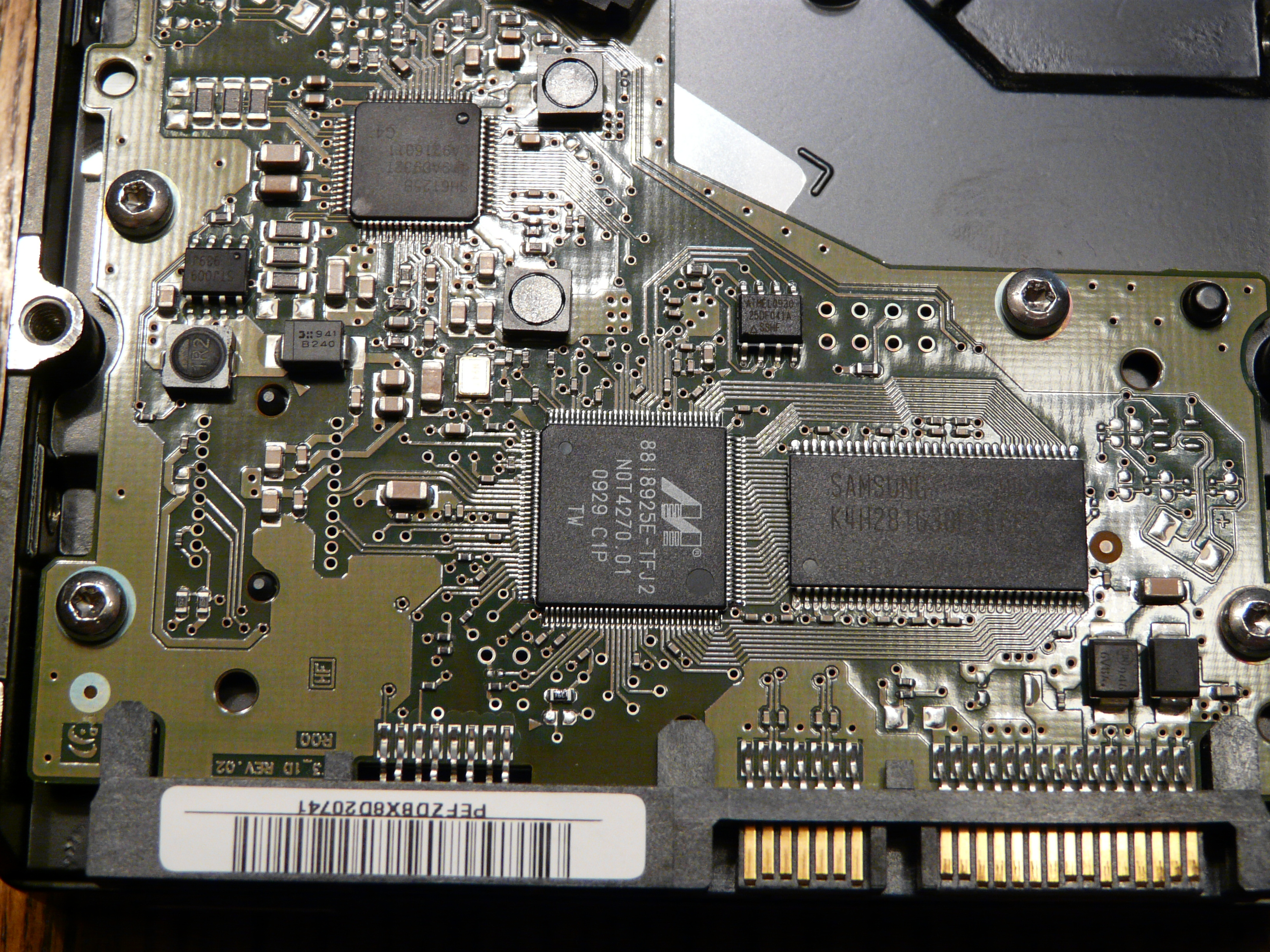

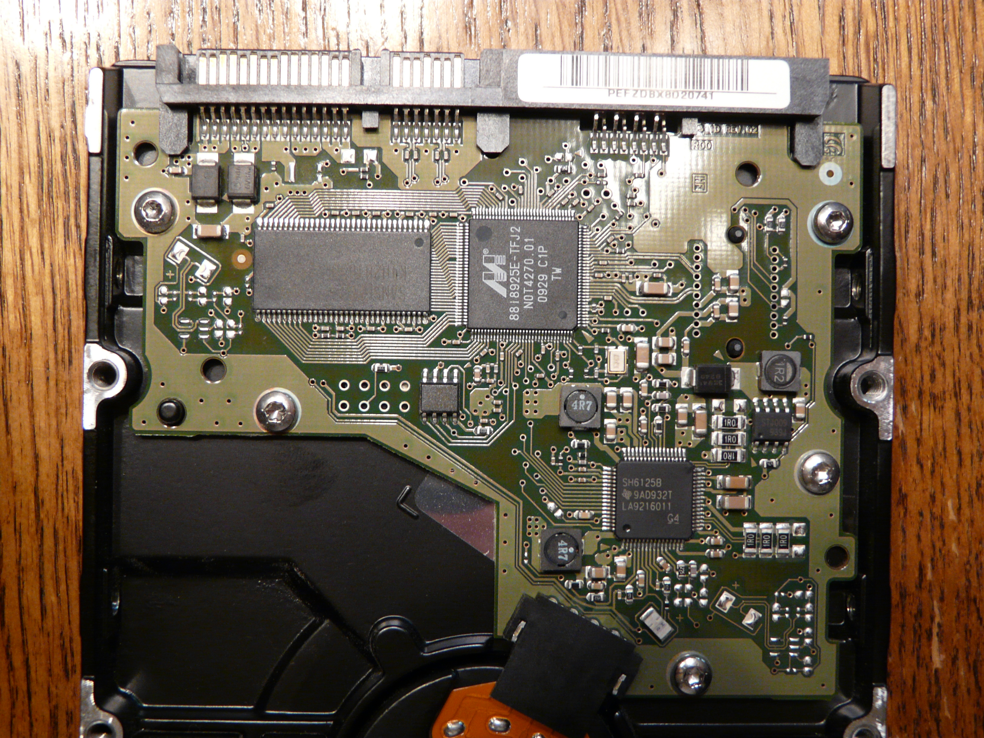

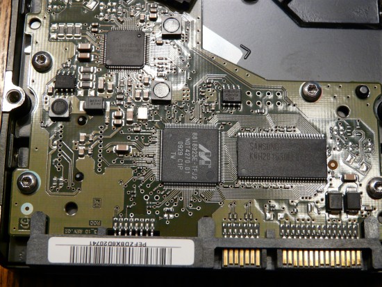

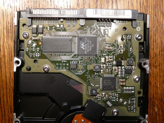

If it helps any, here are some pictures of my PCB. I didn't see anything wrong, but I may have missed something. Based on the information I have, is it possible that my drive could be a candidate for a PCB swap? Obviously a pro job would be preferable to any DIY fix, but I really don't have $800 to spend on one right now.

Based on the PCB picture, I can't see anything wrong directly, but that does not mean it doesn't have in reality.
Someone needs to make some measurements, and probably also open the drive to check if spindle is rotating fine or not.
