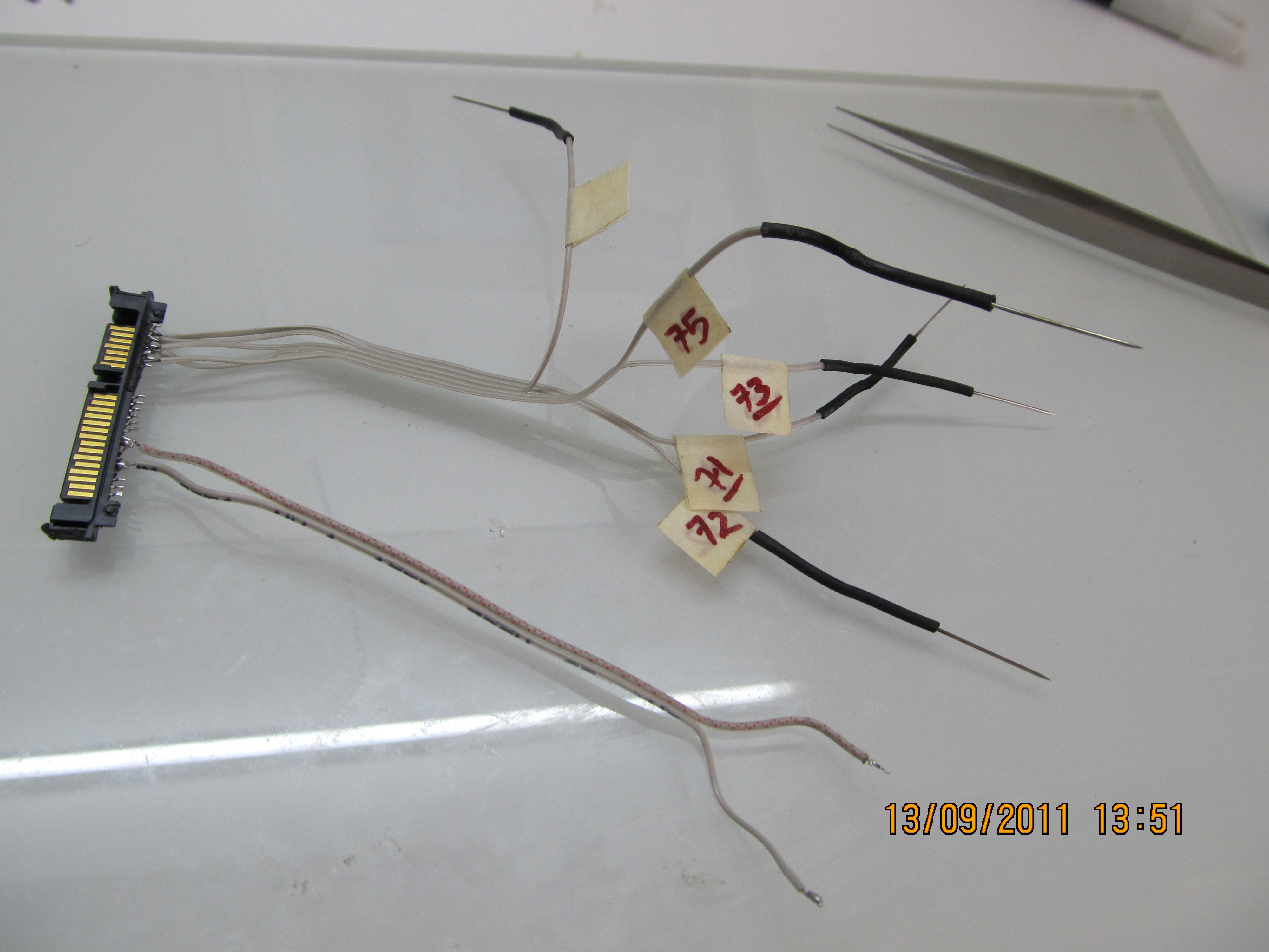

Some of the Research here, Quick Tips if you don`t like to Solder a lot.

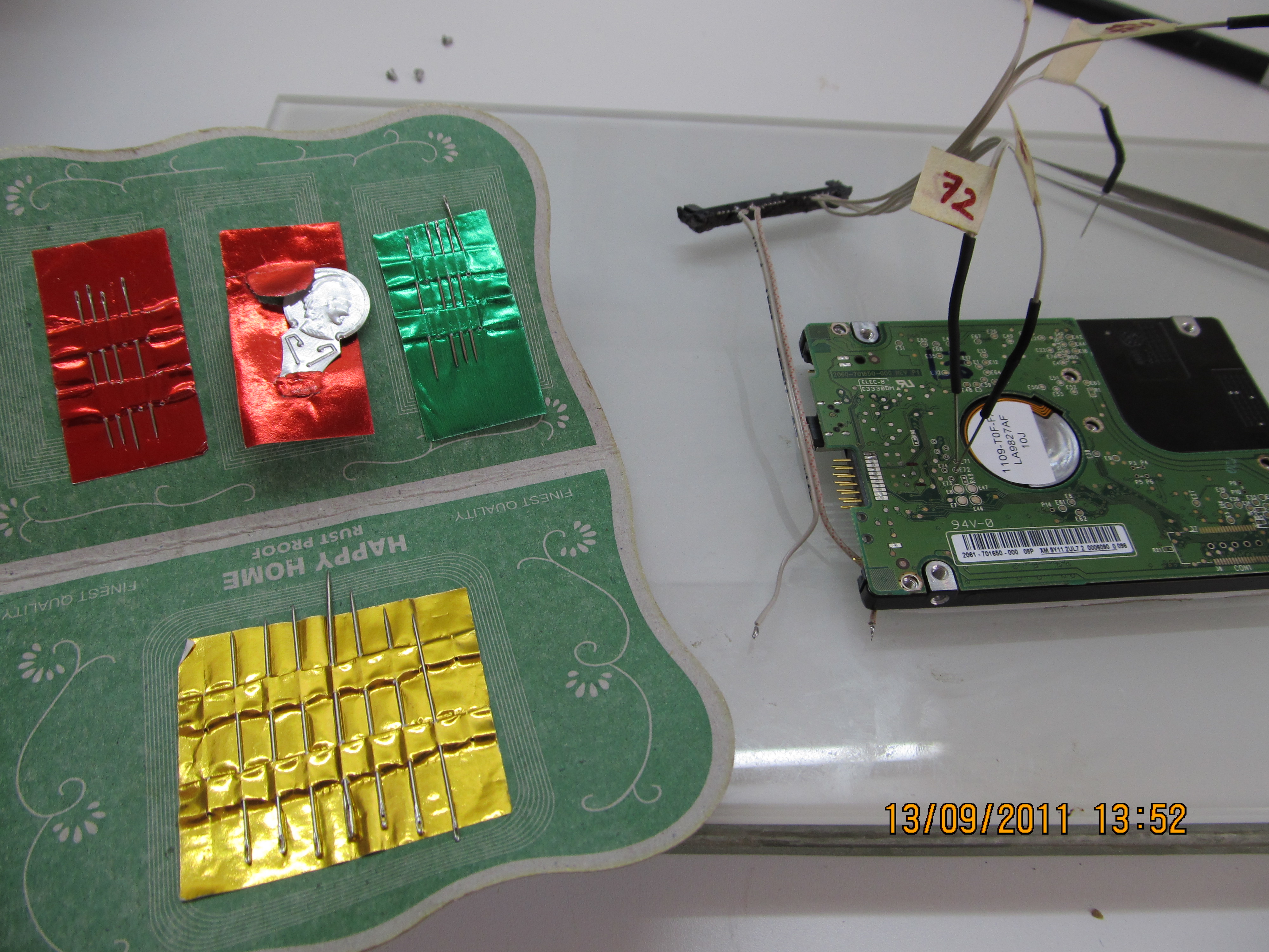

And here is another

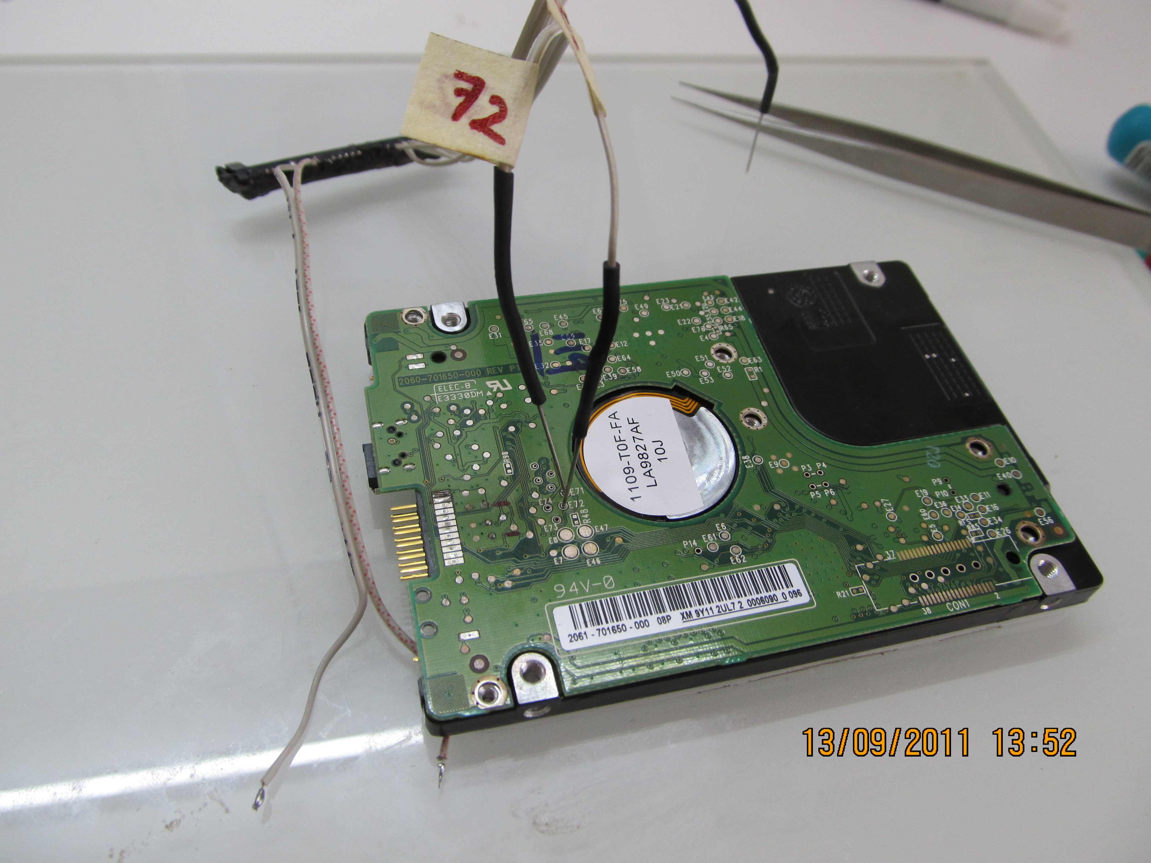

And the Last one comes here...
