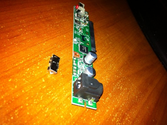

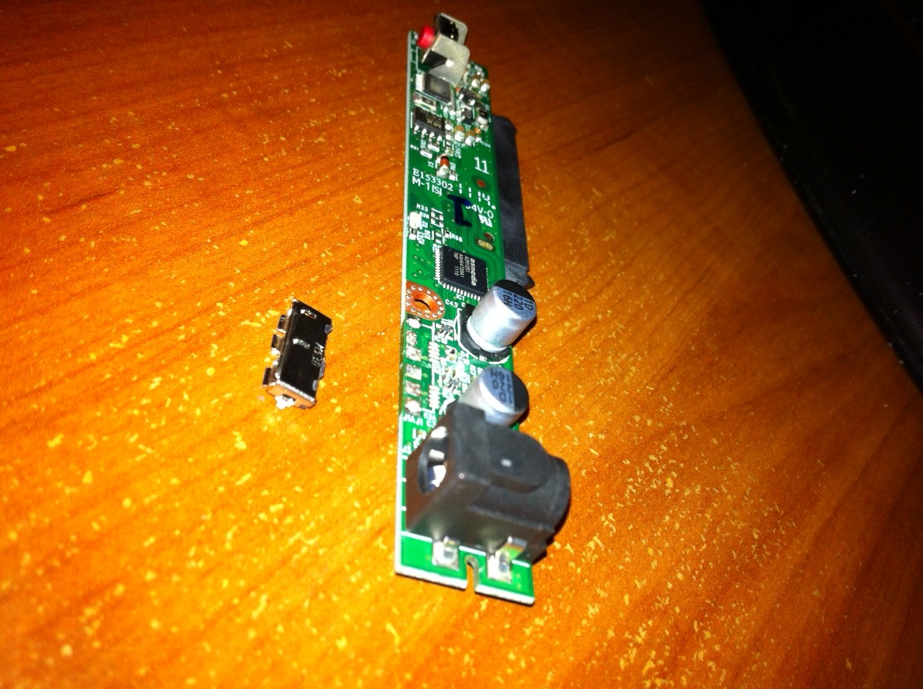

3) Can you supply a close-up photo (or, as suggested by another member, a scan) of the USB-SATA adapter board, so we can see if an encryption chip is obvious. We can then also see what damage has been done to the USB connector / that part of the PCB.

the shove happen as my dvd case pushed the external hard drive case towards the wall it wasnt even a hard push just enough to force the usb cable against the wall itself and bent to the side and from there the usb port was loose an finally after pushing the usb connection a little bit (jiggle) to gain a connection it just pushed in......

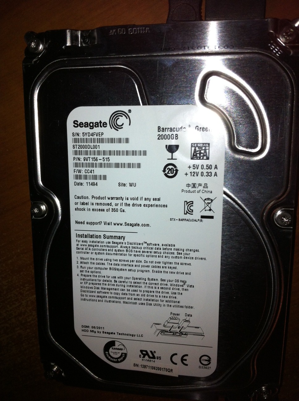

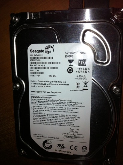

2) Seagate ST2000DL001 2TB capacity - unfortunately this doesn't help, without the answer to question (1), which is what this answer would be compared with.
3) The photo isn't as close as I had hoped (though thanks for trying). The USB-SATA chip seems to be the ASM1051:
http://www.asmedia.com.tw/eng/e_show_pr ... hp?item=90
No mention of that chip having encryption on that web page - altough that isn't proof either way. I couldn't easily see the detail of the PCB, but it seems quite a clean detaching of the USB connector. A good electronics repairer would probably not have a problem reattaching that, unless there has been PCB damage which I can't see (which would not necessarily maker repair impossible, especially if only temporary, just perhaps more difficult).
4) I think you're saying the drive didn't topple/fall, but have not answered whether it was spinning at the time.
Based on the above, I'm hoping that the only damage it to the USB-SATA board, and that this ASM1051 chip does not do encryption. If that's correct, then direct SATA attachment should work, or a USB-SATA adapter which is definitely compatible with a 2TB disk. Either of those (preferably the direct SATA attachment) would be my next step in diagnosis, if I was in your position, and if I had decided to take the risks of DIY.
