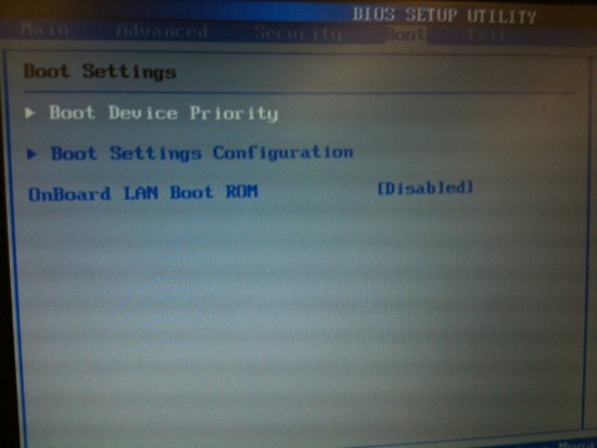

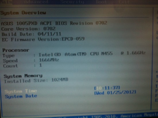

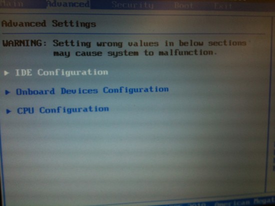

 Post subject: Re: No drives found when trying to reinstall/repair Windows
PostPosted: January 26th, 2012, 13:29
Joined: January 26th, 2012, 6:45
Location: France
i have no idea so here are images of my bios

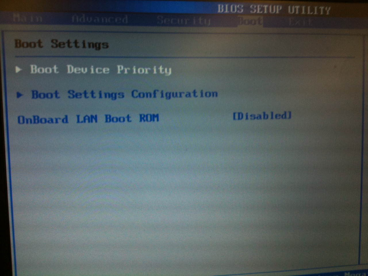

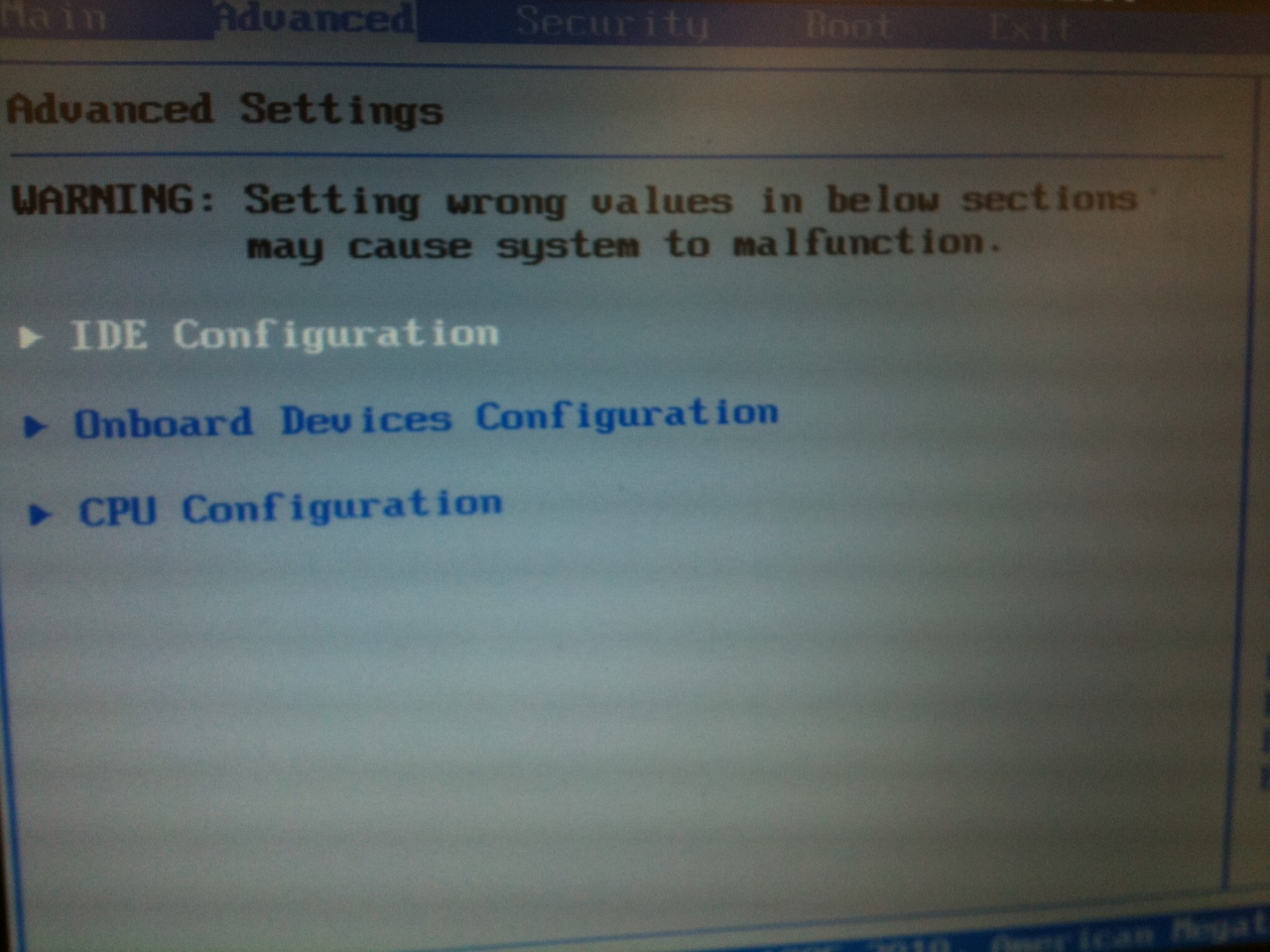

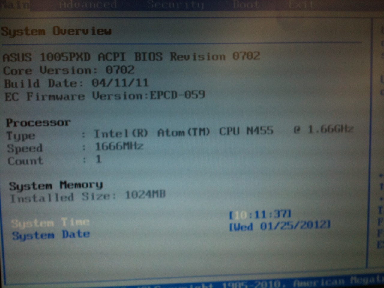

PostPosted: January 26th, 2012, 13:31
Location: France
and here are images of the advanced settings screens
