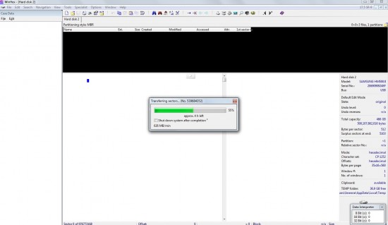

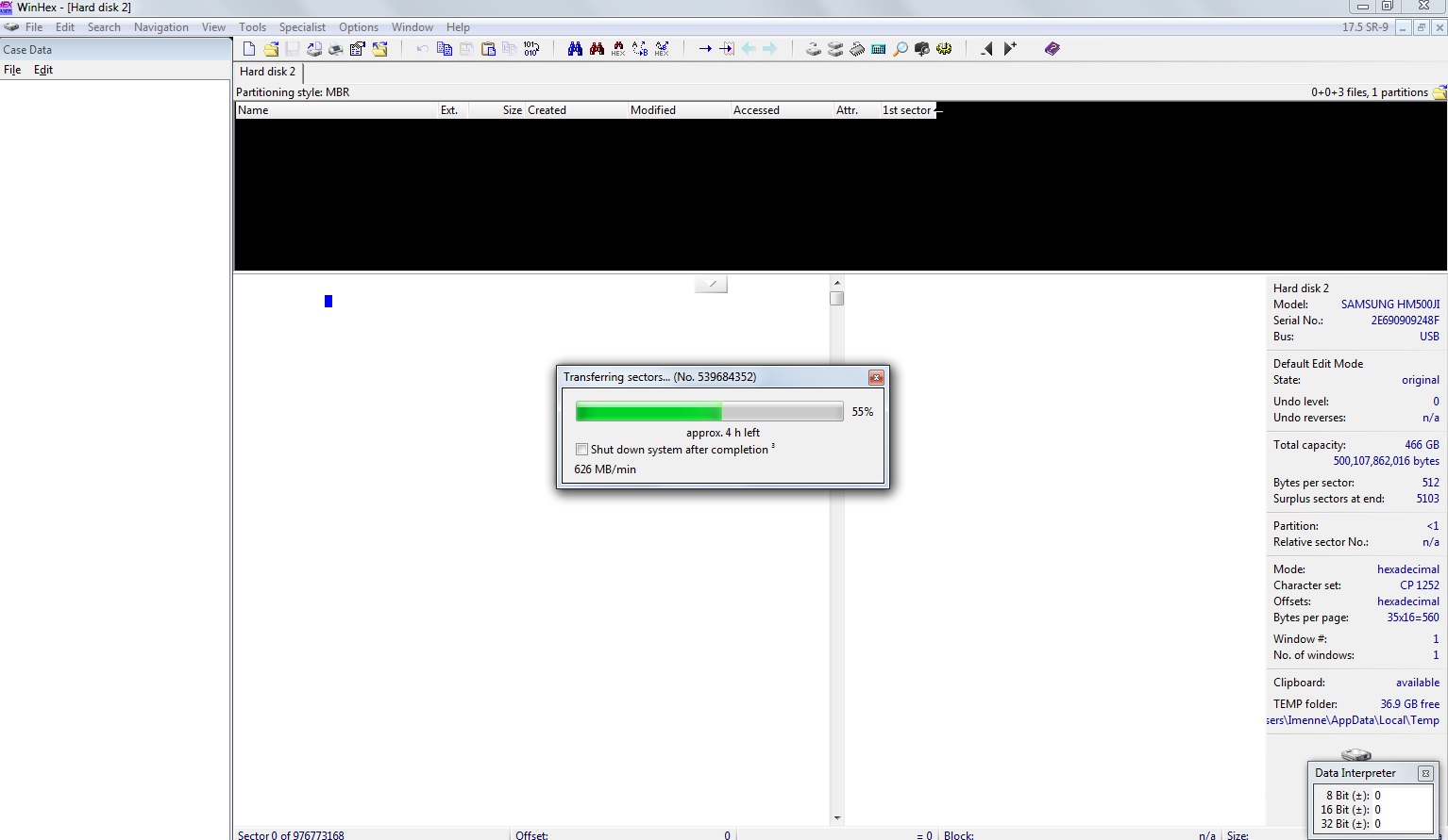

Yep Long Time againg with WinHex.
I launched an imaging of this drive on 12 March 2016 @ 1:00pm, it was supposed to take 7.5hrs.
On 12 March 2016 08pm, Status was 52% & remaining time was 4hrs approx
On 13 March 2016 10am, Status was 55% & remaining time is still 4hrs approx. I enclosed a screenshot
CPU of winhex process is 0%
Is there any mode to skip theses bad sectors ?
How do you test the bad sectors ? & what do you do when you identified them?

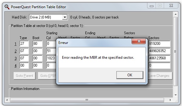

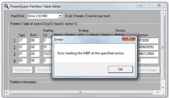

Recovery is going bad. I tried to use dd rescue under a VM Ware with Ubuntu.
I can see the drive f: in windows but:
- Windows Disk Management diskmgmt.msc does not respond.
- TestDisk does not respond. Message "please wait" is displayed.
- M3 Bitlocker Recovery is not able to start. It was the case before I restarted laptop
- Recuva is not able to start
- Partition Find & Mount identifies the drive SAMSUNG HM500JI USB Device but there is no partition detected
- EditHexa recognize disk with no partition& no size
- When accessing drive F: in Windows, message is "cannot access drive"
-Winhex start but take considerable time
- PC Inspector is able to start but doesnt recognize disk
- PowerQuest is not Able to access to the MBR. the MBR was correct 2 days ago
What should be next step to Fix the MBR & image the drive ?
Best regards,
