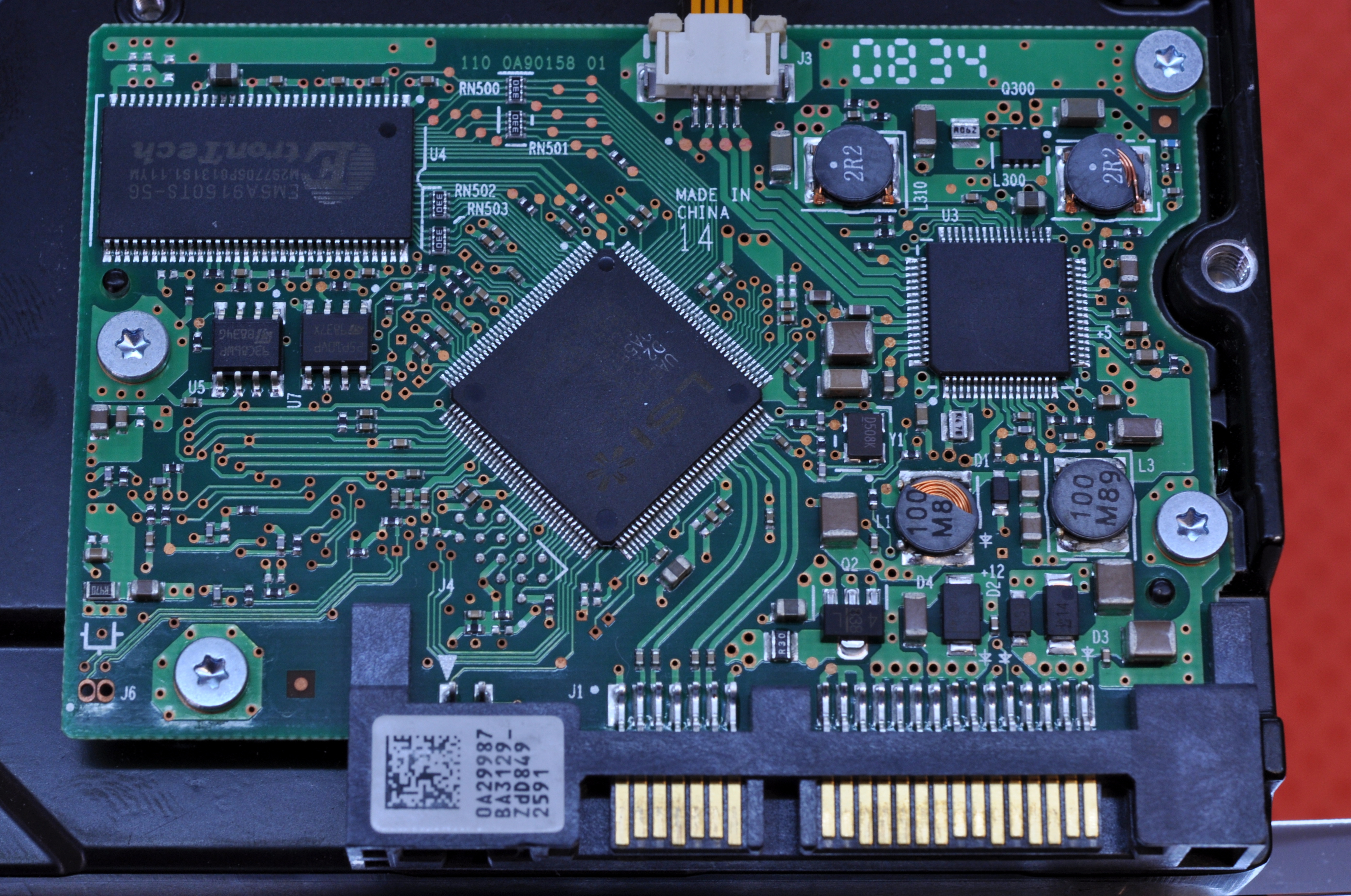

hi, somebody can recognize nv-ram chip here 100% sure?
SATA 1 TB 3,5 HDT721010SLA360 (HDx7210SL family)

The one on the left written 93c86

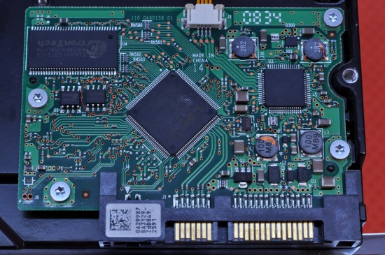

I hardly ever work with Hitachi 3.5" but I would imagine it to be this one.

A quick search on google shows the U5 chip 93c86wP as an EEPROM but not much info on U7 chip in english.
If your not sure why not swap them both?

looks like a 1MB flash memory.
http://www.alldatasheet.com/view.jsp?Searchword=25P10VP

HI
U5=93C86WP is NV-RAM and U7=25P10VP is the ROM

http://www.users.on.net/~fzabkar/HDD/HD ... Flash.html

Hi, i do not need swap them , i need short circuit nv-ram to remove hdd lock..
