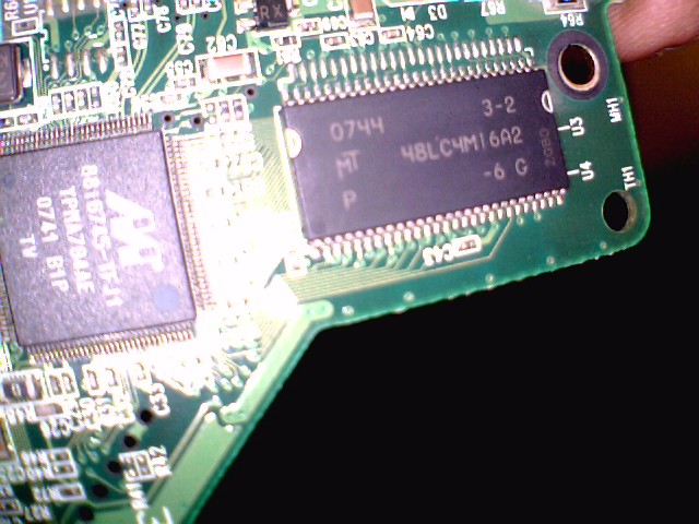

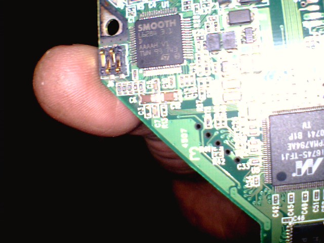

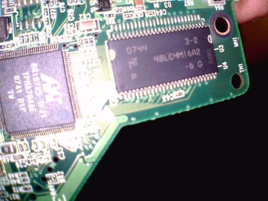

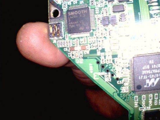

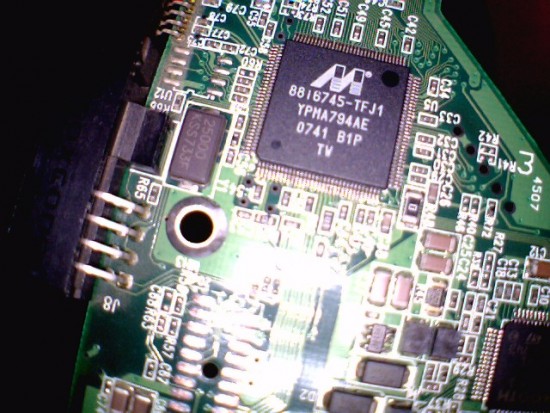

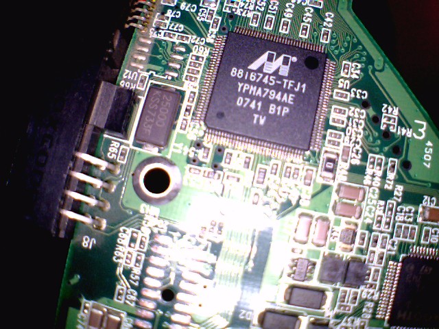

i have got my hdd wd1600aajs-22dsao spindle motor not moving nor it is being detected by bios my pcb seems to be fine (sprakling shiny )nothings seems to be burnt or damaged plz tell me what the problem might be plz help geeks my pcb specifications are as follows:-
hdd motor combo ic : smooth l6283 3.1
main controller ic: 8816745tfj1
synchronous dram : mt 48lcm16a2
File comment: main controller ic 8816745-tfj1

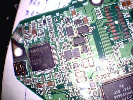

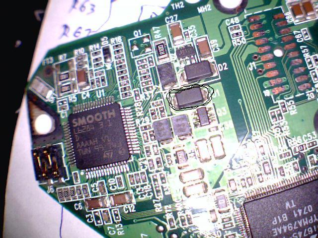

i think the culprit might be this D1 which have readings while testing it with voltmeter in diode mode both ways i have circled it its just below D2
File comment: d ram chip

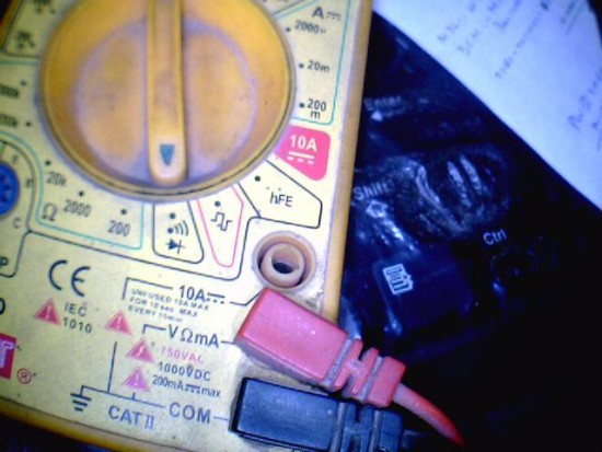

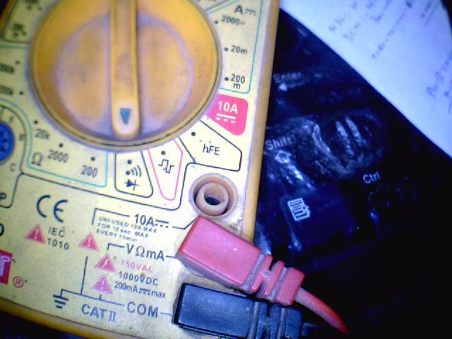

Q3 & Q4 transisitors shows the same characterstics while checking them by pushing the voltmeter to resistance mode here is the pic i am attaching here of my multitester plz tell did i use the right slot to check ! the resistance & continuity
File comment: multitester pic

i have checked D1 its ok by removing it from pcb by multitester in diode mode multimeter setting as shown in above pic

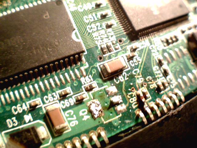

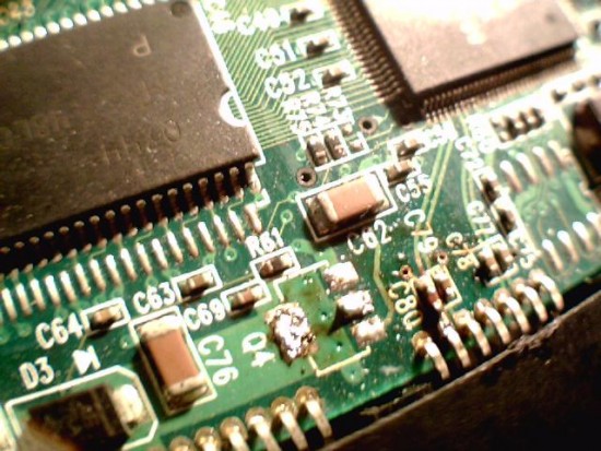

after doing some home work on my pcb, i.e I remove some cap resolder them remove one resistor resolder it after that i m thinking of some miracle so i connect pcb to hard disk & hard disk to pc but hard disk did not awake but lead me to ununpleasent smell i remove the harddisk & pcb & finds that one of its Q4transistor got burnt i removed it here is it s pic after removing Q4 transisitor
after replacing that do i have got chance to revive my hard disk

Seems like all good advice has gone to deaf ear and you do not take good advice. Now I think people will no longer answer you and do as you wish on this one. Sorry you are not listening to all the good advise given to you. Seems you know more than we do and it might be best if you just do as you wish and not report back what you have done.
Here we see this all the time and after so many attempts and failure they finally decide to listen to us but it is way too late now. It is your HDD, your data, and your choice on what you want to do now.
I told you from beginning get another pcb board and swap it out. If the hdd spins up then all you have to do is move over ROM to get back your data. Hope you have not destroyed all your chances in this one. Good luck

I agree with everything you're saying, except I just noticed something - his PCB has no external U12 chip (check the Marvell chip number and the very first photo in this thread) :( So DIY is harder, of course...
