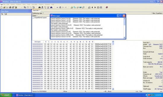

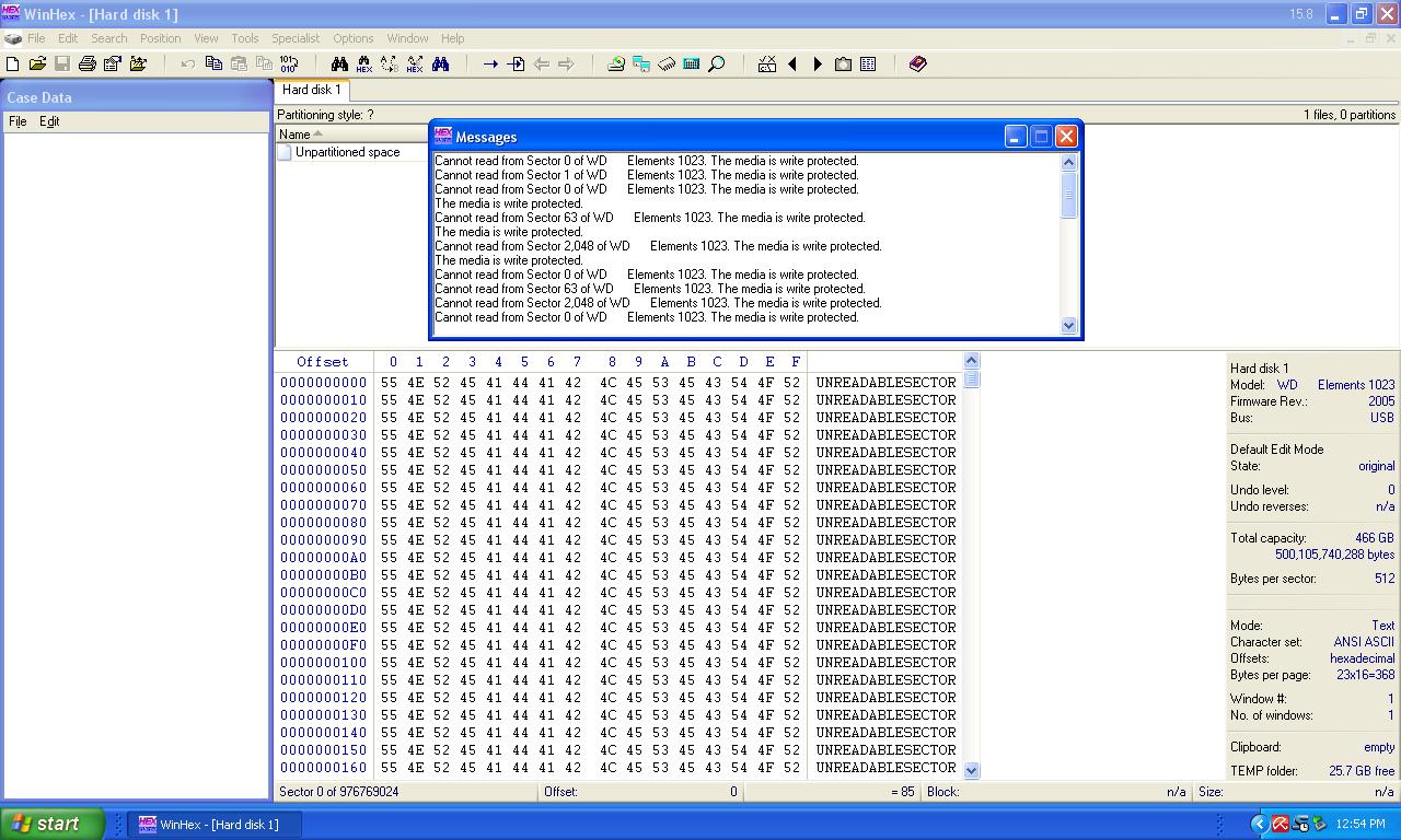

I spoke with the customer and he advised that no password was set.
I installed Smartware but it can't see the drive.
I tried to open it with few different DR apps and it gives me a message that the drive is write protected.
see attached screenshot from Winhex.
Any thoughts?

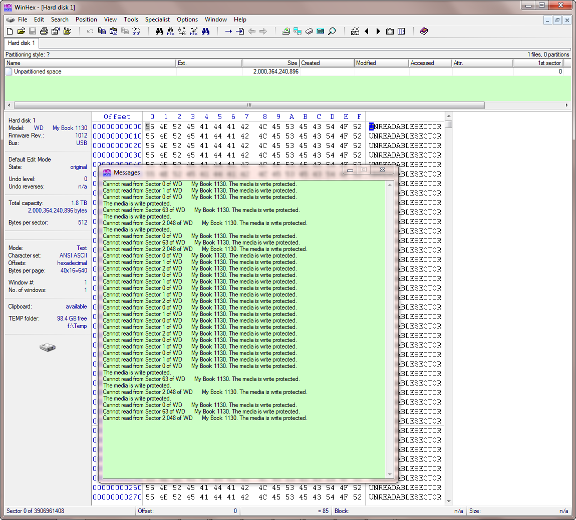

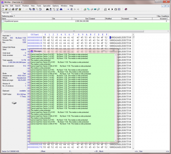

I make the screenshot but maybe you need the sector 3907026307 as well?
This is link to sector
http://dl.dropbox.com/u/48034438/sect_3907026307_23402
The disk never worked with password and I made 100% image of sectors. The problem is now to decrypt data

freakzy wrote:
Hi, Are you sure your problem is same as OP ? can I see screenshot with Winhex as post #6 above ?
I posted the picture but it must be adopted by moderator
Here the link to picture and to the sector 3907026307 with key
The disk copied via SATA 100%, user never set a password
Is it possible to do something?
picture, sector

 Post subject: Re: WD Elements 2.5" 500 GB can't find data
PostPosted: January 22nd, 2012, 23:19
Joined: March 24th, 2011, 0:18
Posts: 182
We did the soldering, usb to SATA to the PCB.
Looks good, imaging the drive as we speak, it looks like the drive wasn't using the Initio at all, it is not encrypted.
Thanks for your help

Injector wrote:
Your problem is more difficult than OP. Your drive is really encrypted by Symwave chip. OP's drive wasn't.

freakzy wrote:
What is the brand and model of your destination/clone drive ?
I cloned the original disk via SATA to another WD. The original had some problem but it was copied 100% at the end.
We bought two more the same as previous USB3 box and each one can read disk from another. But none can read the first disk and its image as well. And even old box cannot read from new disks (maybe it's broken?). So I have only one method to read data is to find a key and decrypt with some program the sectors I read.
I think you have already found out the solution yourself. Read your own post carefully :)
Don't waste your time to decrypt the drive using software..........
