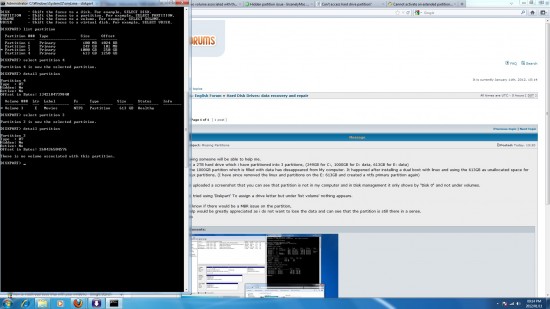

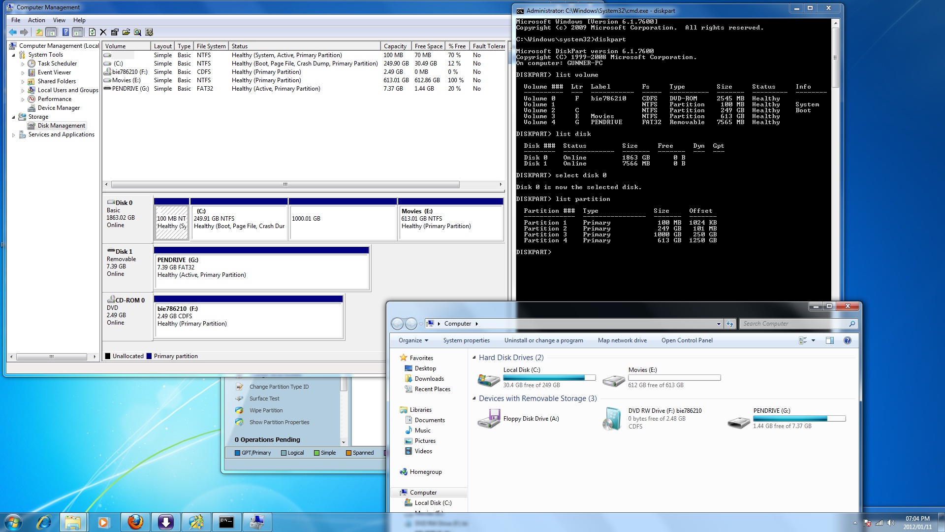

Hi
Im hoping someone will be able to help me.

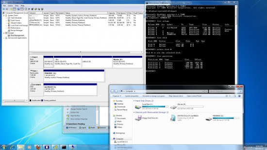

I have a 2TB hard drive which i have partitioned into 3 partitions, (249GB for C:, 1000GB for D: data, 613GB for E: data)
Now the 1000GB partition which is filled with data has dissappeared from My computer. It happened after installing a dual boot with linux and using the 613GB as unallocated space for the linux partitions, (I have since removed the linux and partitions on the E: 613GB and created a ntfs primary partition again)
I have uploaded a screenshot that you can see that partition is not in my computer and in Disk management it only shows by "Disk 0" and not under volumes.
I have tried using 'Diskpart' To assign a drive letter but under 'list volume' nothing appears.
I dont know if there would be a MBR issue on the partition,
any help would be greatly appreciated as i do not want to lose the data and can see that the partition is still there in a sense.

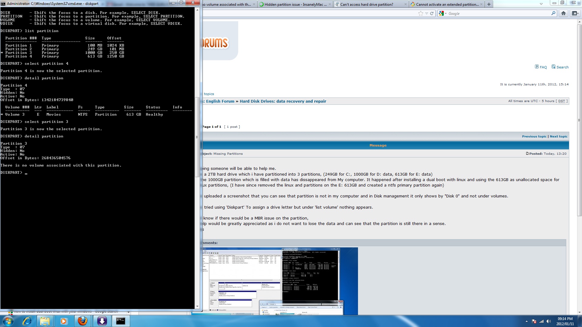

Just more info on the partition details. Please if anyone has any suggstions? I really dont want to lose all this data? am i able to merge it with another partition?

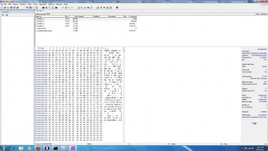

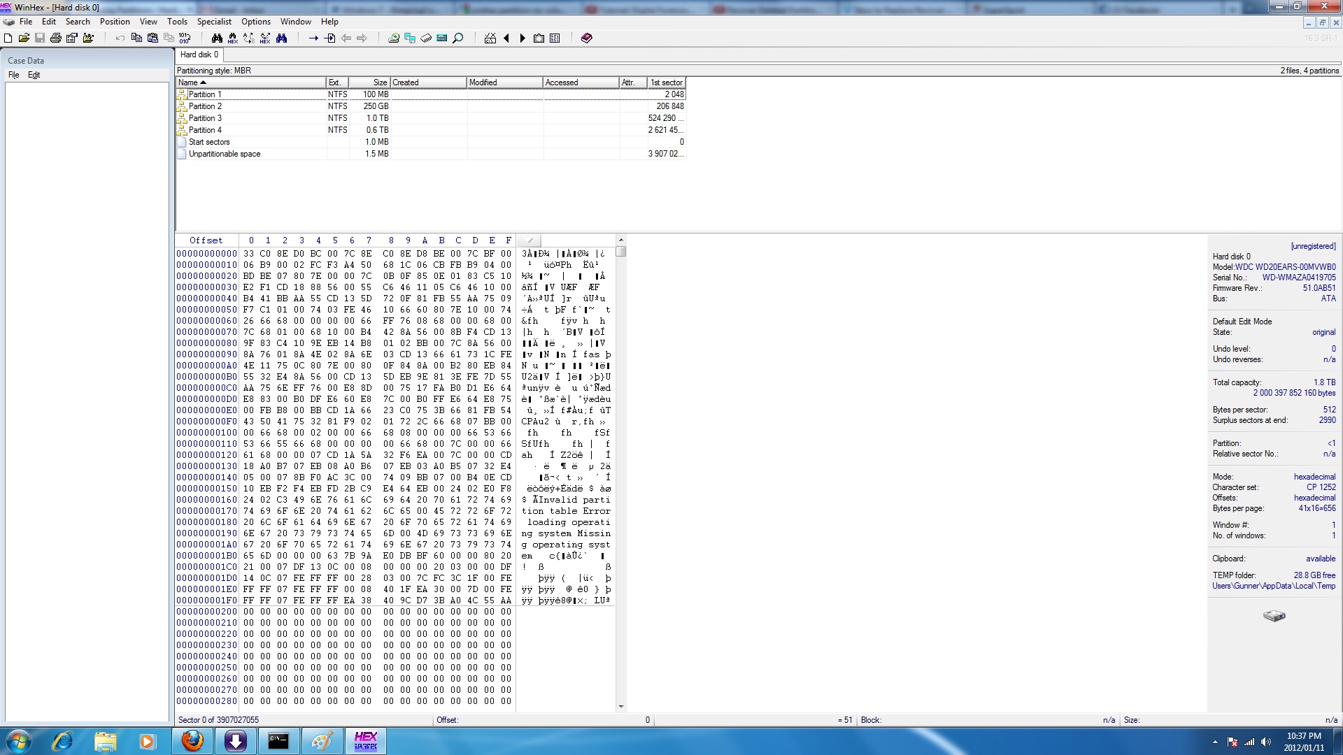

Here is the screenshot of the partitions on the disk. Will also add a picture of the partition once explored

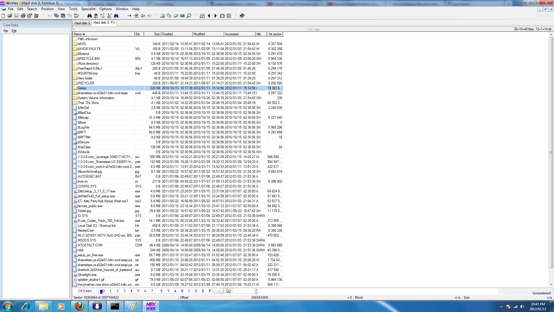

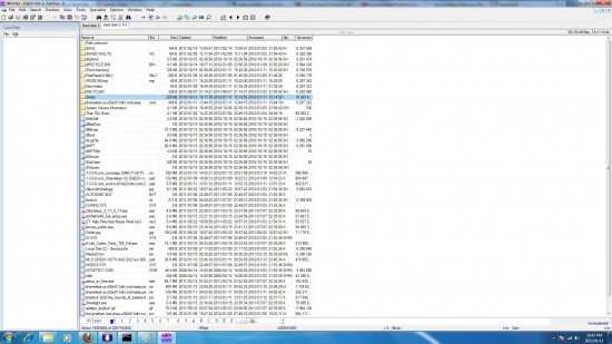

partition 3 files

einstein9 wrote:
remember (read-only) mode
Found it under edit mode
 Post subject: Re: Missing Partitions
PostPosted: January 12th, 2012, 3:44
Posts: 2854
so those are your files :wink: if yes (save it)
if not ( i dont think so) this is something else
good luck
Yes those are the correct files, But dont have enough free space to recover everything, Will try loading partition recovery wizzard from boot to see if it can repair it first hopefully.
