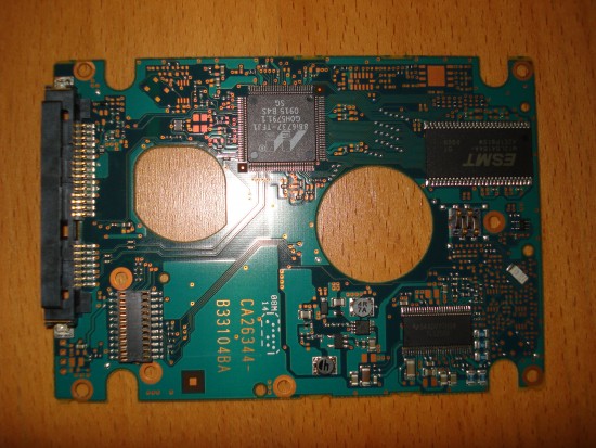

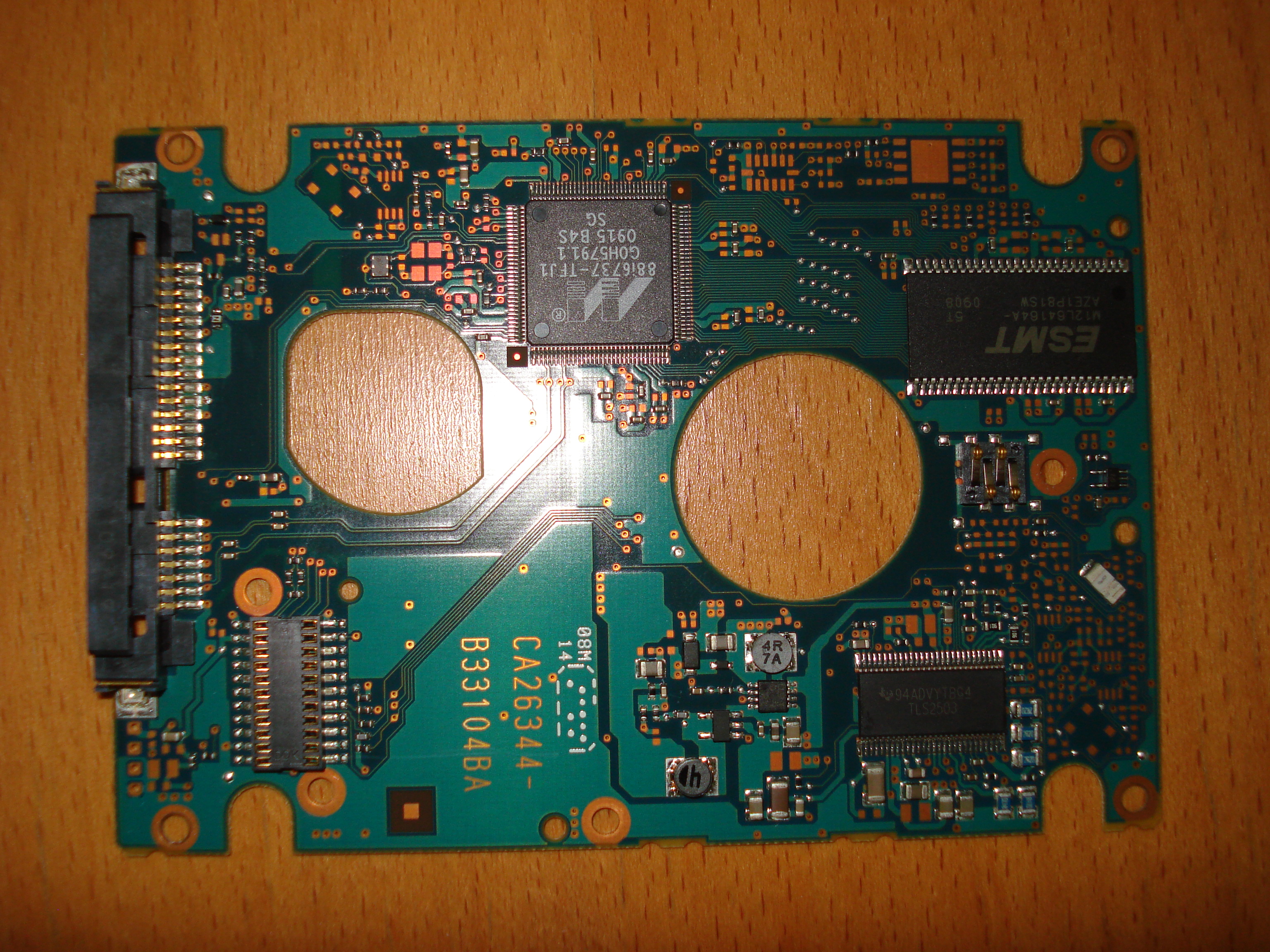

With the replacement PCB, I can hear the drive try to start up with faint clicks everytime it starts. It seems to try harder when it clicks, spins for a little, beeps, then repeats the process. Is there a way to swap the ROM on this board? Can someone please help me identify it in the attached picture? Obviously the fuse blew on the original board so there could be more problems with the original board which is why it is not working with a replaced fuse.

Have you tried the original PCB again? Perhaps there was a stiction fault which has fixed itself?
As for a ROM, the MCU appears to have internal flash memory. There looks to be a vacant 8-pin spot in the top RH corner of the PCB that may be reserved for an external flash memory. (The spot to the left of it appears to be allocated to a tri-axis accelerometer for G-force protection.)

ROM is internal in MCU on this model.
