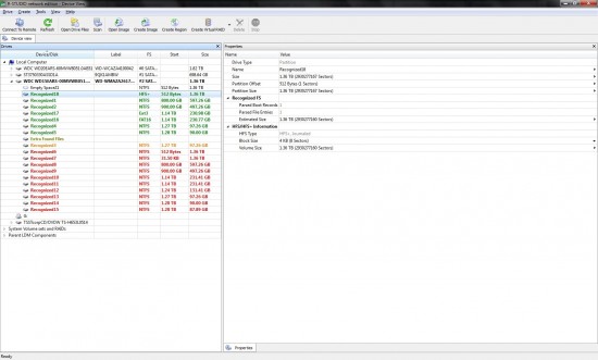

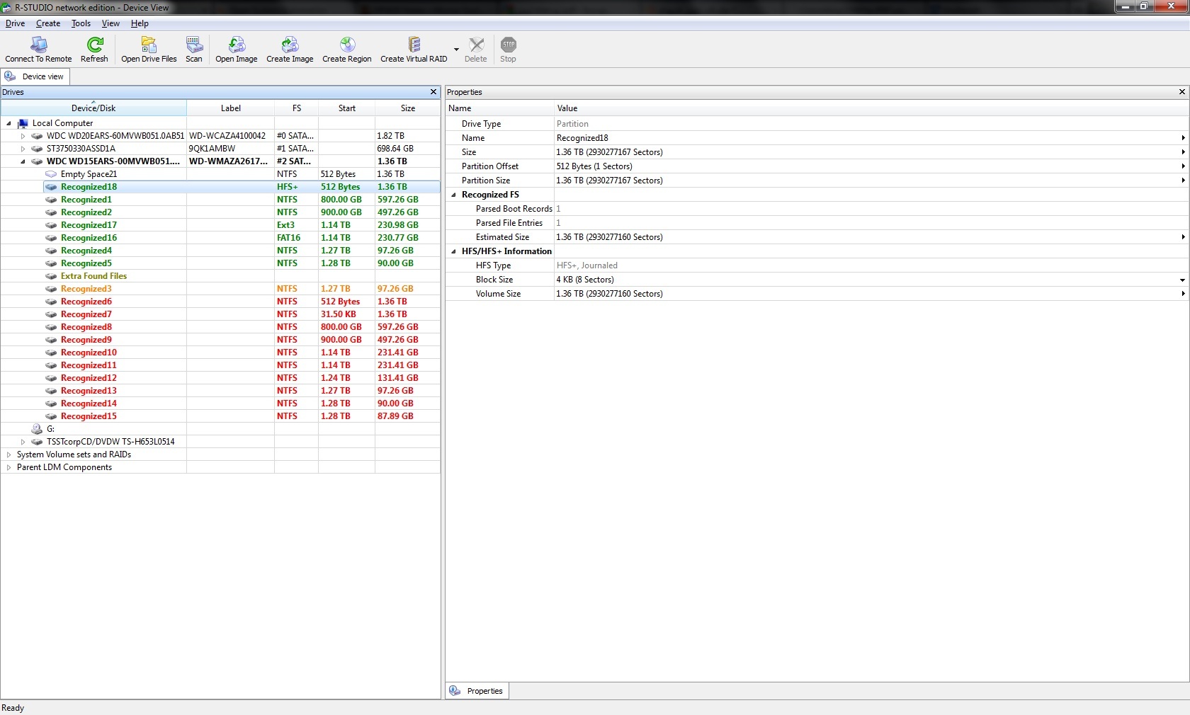

Post a screen shot of the r-studio scan so we can see the info it found the partitions the ones in green etc

There you go..

have you looked through all the partitions marked green one at a time for the data ?

I swear I did.

if you can't find the data then most likely with all the changes you made to the partitions etc the space has been overwritten and thus not recoverable.
