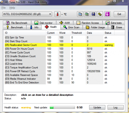

I have an Intel SSD X25M and yesterday I notice this with HDtune Pro. I run a full diagnostic scan with Intel SSD Toolbox, everything was fine..
Should I start to worry??
The SSD has the latest firmware.
Thx!!

Bad sectors are normal on a HDD and the drive has marked them as bad and not to be used again. This might be from time it took to read the sector exceeded the time the threshold has on them. If you get more bad sectors on the drive then it could be a problem. Right now 2 is not such a big deal but if there is more this would be worth being concerned about. All drives leave the factory with bad sectors but they are marked and stored in the Plist so they are not used when you get this drive. The other bad sectors the drive encounters during useage are stored in the Glist.

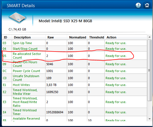

In fact that screenshot from HD tune is the smart details...The same numbers appear in the smart details from intel's ssd toolbox.
By zero-fill do you mean secure erase, with intel's ssd toolbox? Right now it is difficult, to format and reinstall from scratch
Should I send the ssd for service? At what value this reallocated sector count starts becoming dangerous?
IMHO HDTune is saying "warning" incorrectly, as if this was a hard disk instead of an SSD (and it isn't decoding the meaning of all the attributes correctly for this SSD). Increasing reallocations are expected with SSDs that are being written to - you can use your favourite search engine to research NAND flash wearout.
I don't use that specific SSD, but I think that's the one which Intel expect to have a lifetime of 20GB writes/day for 5 years i.e. 20GB x 365 x 5 = approx 35.6 TiB. If I'm correct, then considering that your drive has written 3.8TiB (I think they mean TiB not TB on that Intel screenshot, based on the raw SMART value from HDTune and my quick calculation), it has used approx 10.7% of its expected write lifetime, so a few bad blocks are not unexpected by now, in my experience with other MLC SSDs.

I wouldn't waste your time or money sending it back to the supplier - I don't see anything unusual, and I would expect your supplier to just return it to you, with an invoice for doing their testing. :) However, as always, you cannot rely on SMART to always predict failure. You still need to have backups. I would just use whatever tool Intel provide / recommend, for checking the drive health.

When the Intel utility tells you. :) IIRC, SMART attributes 0xE8 & 0xE9 are much more useful in showing the wearout (although it's not necessarily a linear process as the number of writes increase, in my experience).

Thx guys for your responses!! Estimated time remaining and Drive Health are both at a 100%, so I guess for the time being, I'll keep monitoring the ssd..
maybe I will perform a secure erase, If that happens I will report back here!
